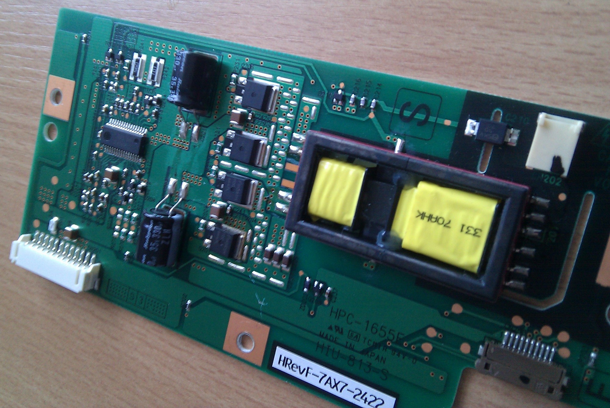

    Hi Guys,
    I've had a lot of luck so far in simply replacing caps in the PSU to repair monitors, and recently I put a generic inverter board into a monitor with no issues either.
    I just got hold of a 32" Toshiba TV that switches on for 2 seconds and then the backlights turn off, whilst the TV stays on.
    I've cracked it open, and I can see the invertor board. When this switches on - it makes a hell of a noise - almost like white noise - very loud. Then it stops when the back light turns off.
    I can't see any caps that look suspect - although there is one 450v 120uf on the main power board that looks like it's not quite flat - hard to tell.
    So I'm wondering - is there any repair that can be done to a transformer - or do I need to outright replace it, or the entire board? Could a cap further up the line cause the transformer noise (unclean electricity getting to it?)
    Any advice on the next step would be great.

      Re: Toshiba TV - Inverter Transformer Arcing?
      Hi retiredcaps,
      I was asking quite generic questions - which is why I didn't give model numbers etc. I want to understand possible reasons why I'd hear the noise I'm hearing.
      I did a bit more reading up and apparently this particular TV (Toshiba 32C3035D) quite commonly has failed inverter boards.
      My model uses a master and a slave unit. The slave unit is the one making the noise. If I unplug the power to the slave unit - it doesn't even try and start up. There's obviously some sort of protection mechanism in place.
      There are people selling repair kits for this board online - which comprises of 4 transistors and an IC chip - not the transformer.

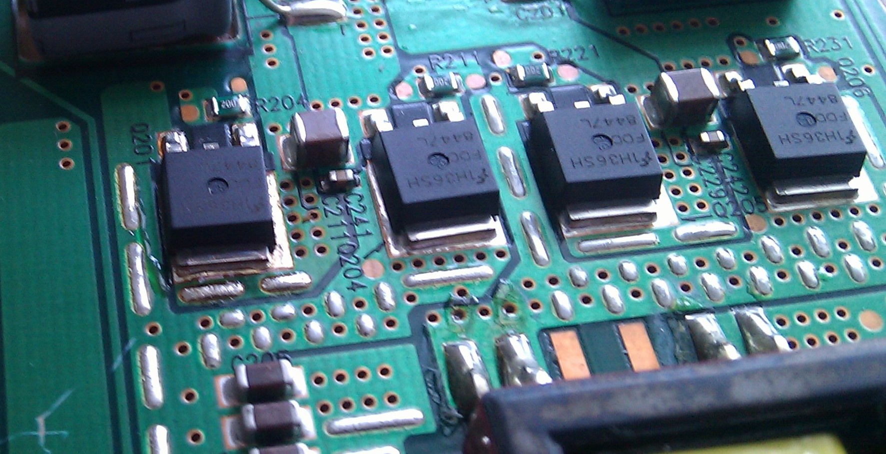

      Looking more closely at the board today - one of the transistors looks like it has some mild burn marks. I'm thinking that perhaps it needs replacing, and I'm going to try and hunt one down.
      Question is - would/could that cause the arcing noise I'm hearing?
      If the IC was gone, I would have thought it wouldn't even turn on for 2 seconds. No?
      I've attached a couple of pictures - you can just about see the browning around the left hand transistor. Otherwise it looks quite helpful.
        Yes, bad transistors and usually the IC will die from it, that's a good reason the set is sold as a repair kit. replace those and all should be fine.
            Originally posted by Spode
            Hi retiredcaps,
            The noise you are hearing could be from:
            an high voltage connection that not fully connected or bad connector
            an high voltage cable with an open isolation which it arcing to ground to some metal inside the case.
            bad high voltage transformer(s)
            an open CCFL backlamp(s)
            bad high voltage cap.
            hope this help
