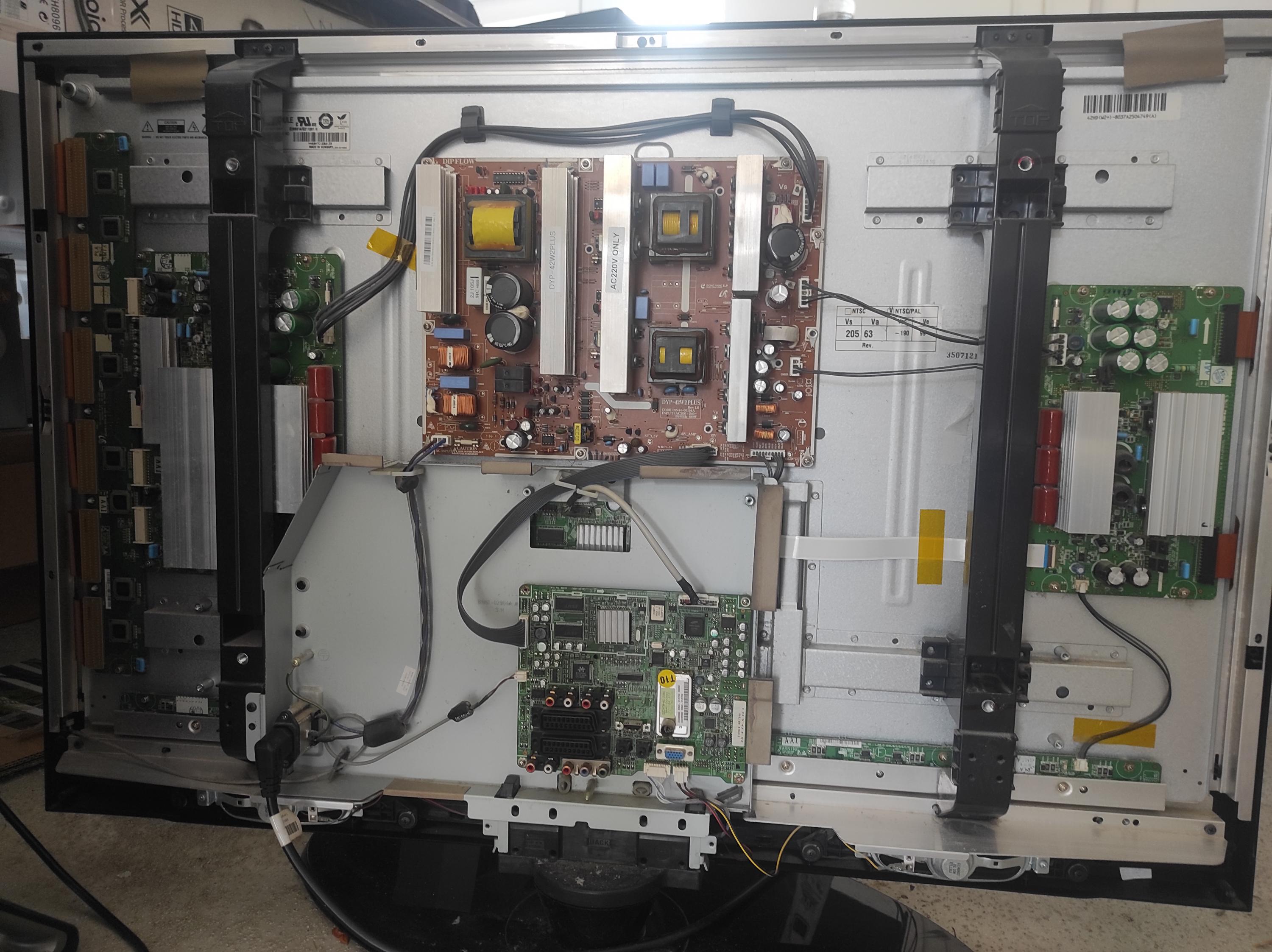

    Hi!
    I have repaired a few TVs but never had a plasma TV before.
    For a new challenge/experience I picked up a Samsung PS-42E92H from the junkyard.

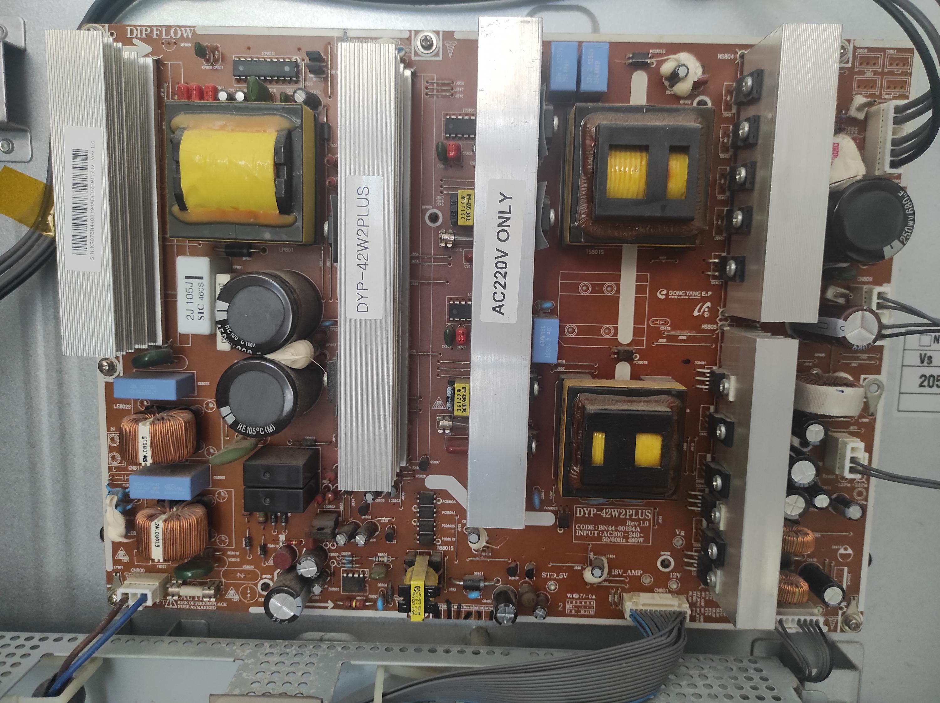

    Unscrewed at home, the fault seemed clear. 3 capacitors on the PSU were bulging.
    I also replaced some surrounding ones and came up with 8 capacitors.
    Unfortunately, the TV still does not turn on.

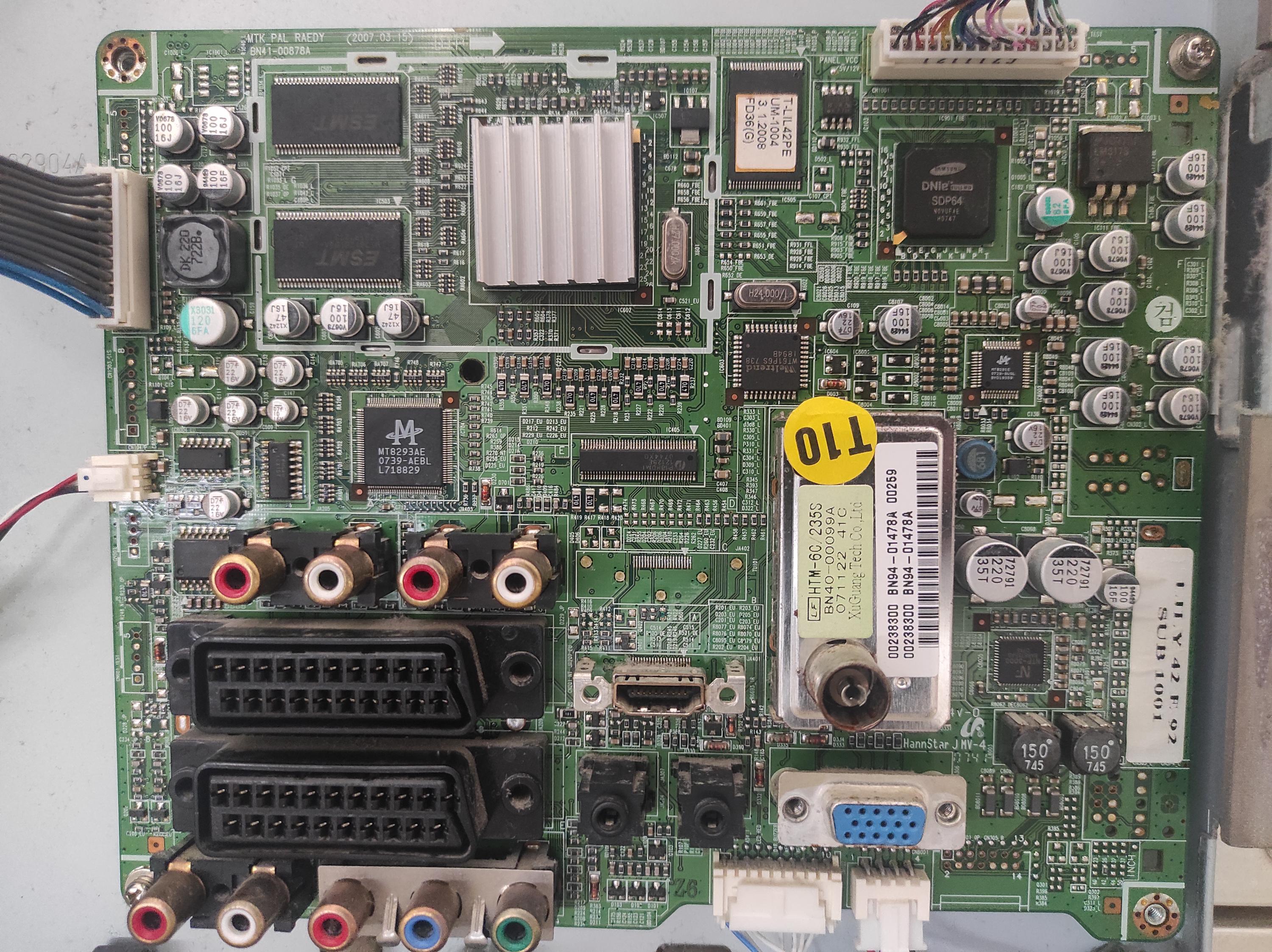

    5V standby are measurable on the PSU and on the mainboard.
    If I understood correctly, 12V should be generated on the mainboard. But there comes nothing.
    On the right part of the mainboard I can't measure any voltage on any of the electrolytic capacitors. On the right half I have different voltage (2V, 3,3V, 1,XV 5V)
    Can I somehow narrow down if it's the MT8291E or its supply/drive (which would then probably be a CPU error and thus an irreparable motherboard)?
  • An-klamm
    • Feb 2023
    • 43
    • Deutschland
    Re: Samsung Plasma PS-42E92H
    My mistake!
    The 12V should not come from the mainboard but from the PSU but also not in standby but only after power on.
    I traced all the tracks and found a defective mosfet.
    TV works again.
