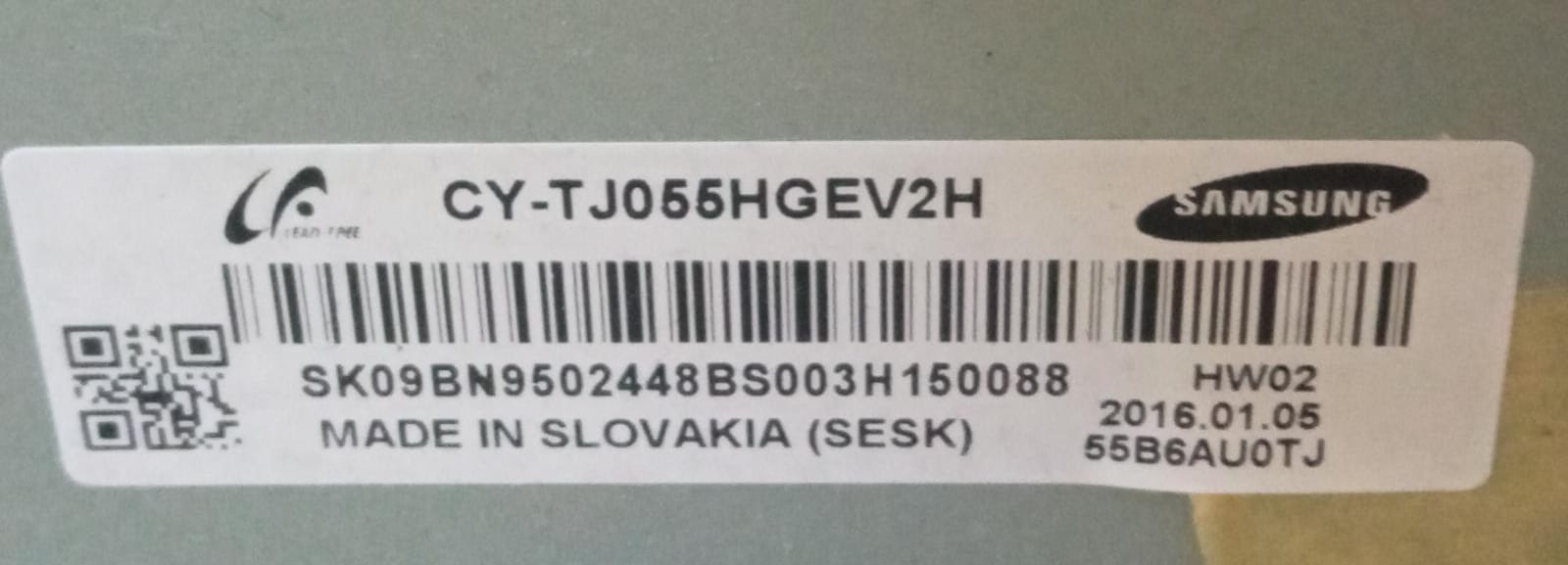

    I have a Samsung UE55JU6850 with a defective display (cracked during removal for backlight issue).
    Label from the panel attached.
    I have been looking for a UE55JU6850 with a different defect for some time, so that I can take the display or use my working parts.
    Unfortunately, so far I have only been able to find working TVs or ones with a broken display.

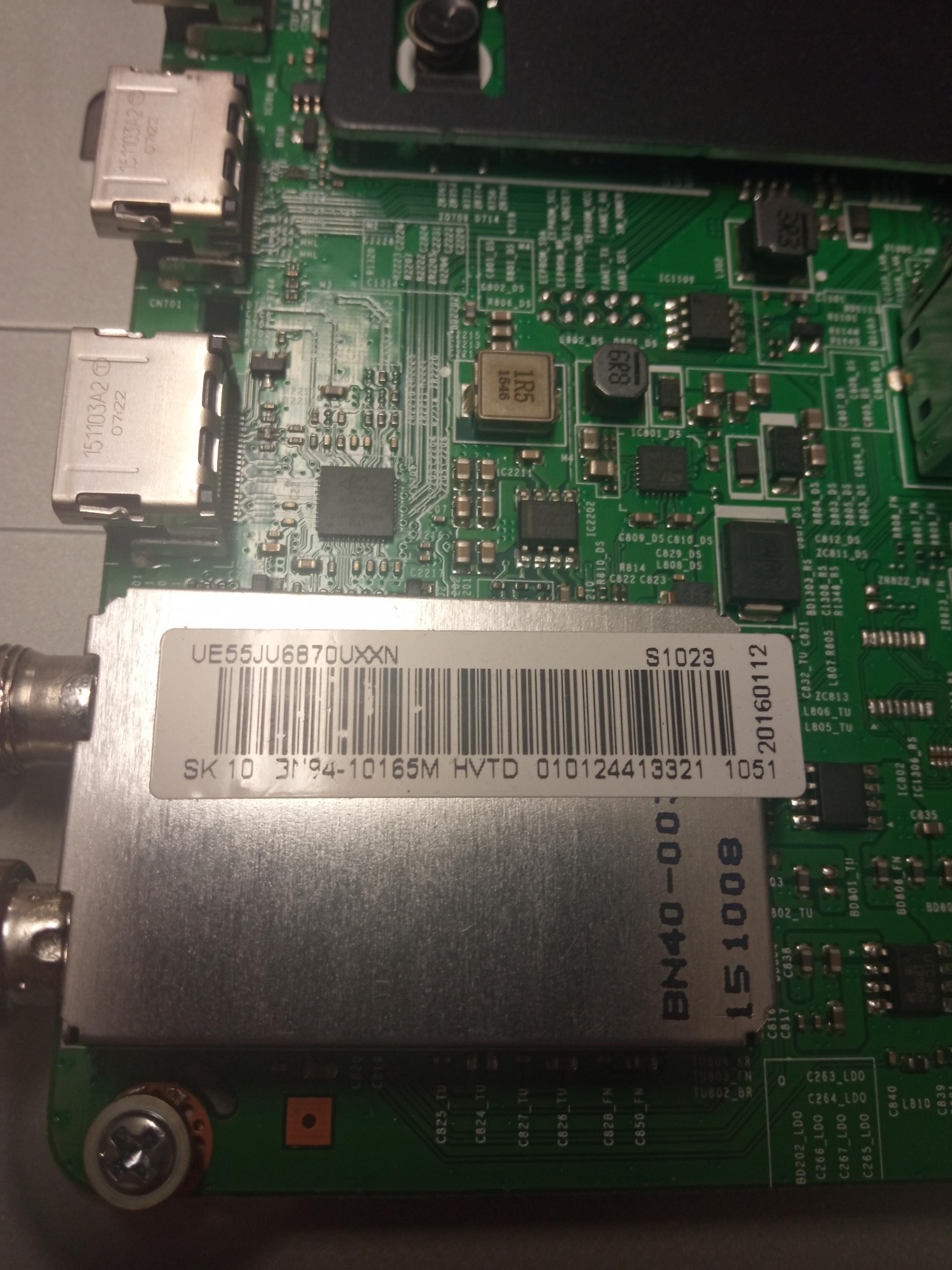

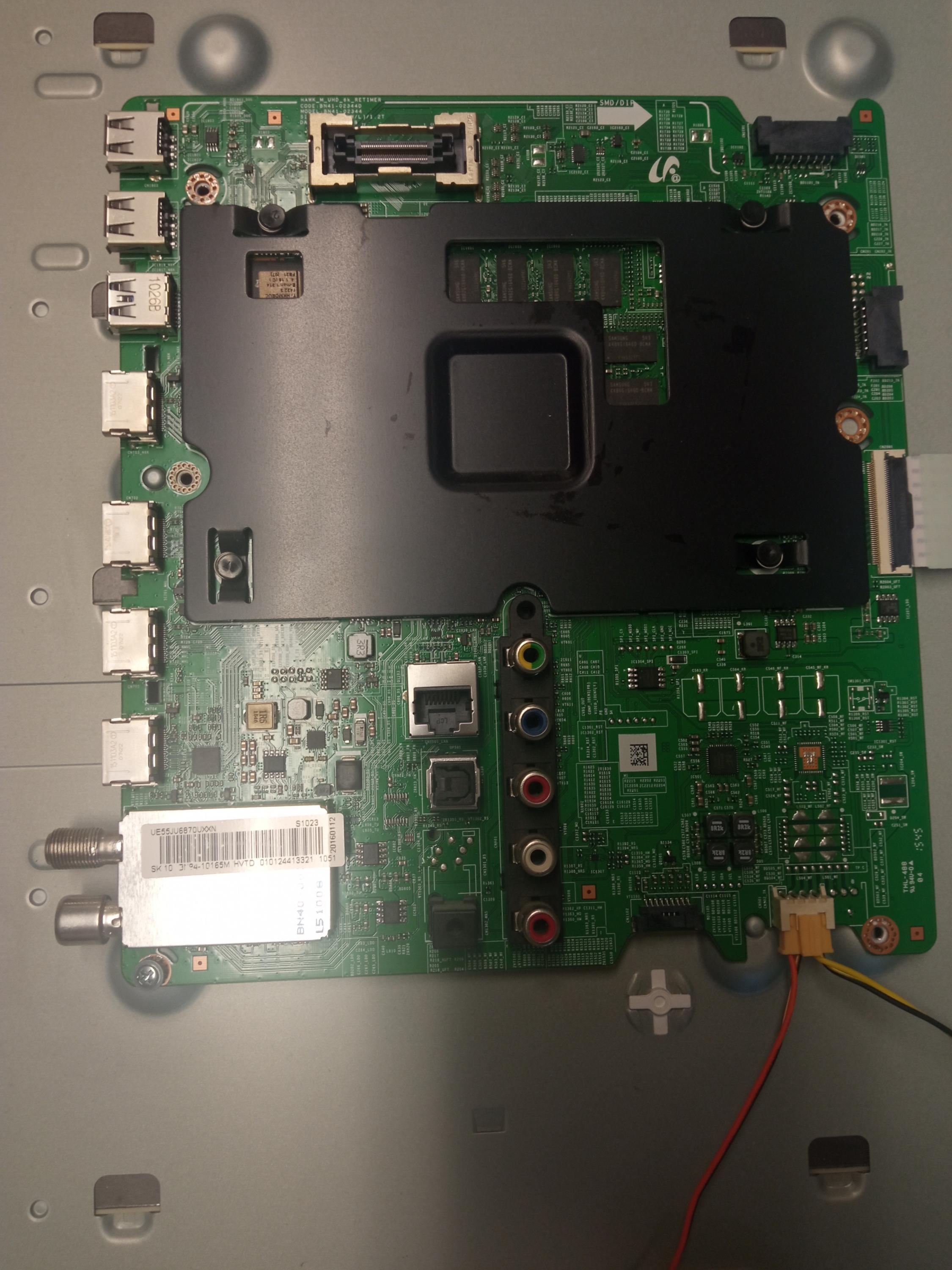

    Can I use the BN94-10165M mainboard in another TVs? Which "series"?
    OR
    Maybe Samsung used diferent panels in JU6850 series and its just something to change in servicemenu, so i can look out for diferent (broken) TVs?
    OR
    Is there perhaps another model series with the same panel?
    Out of which model series?
