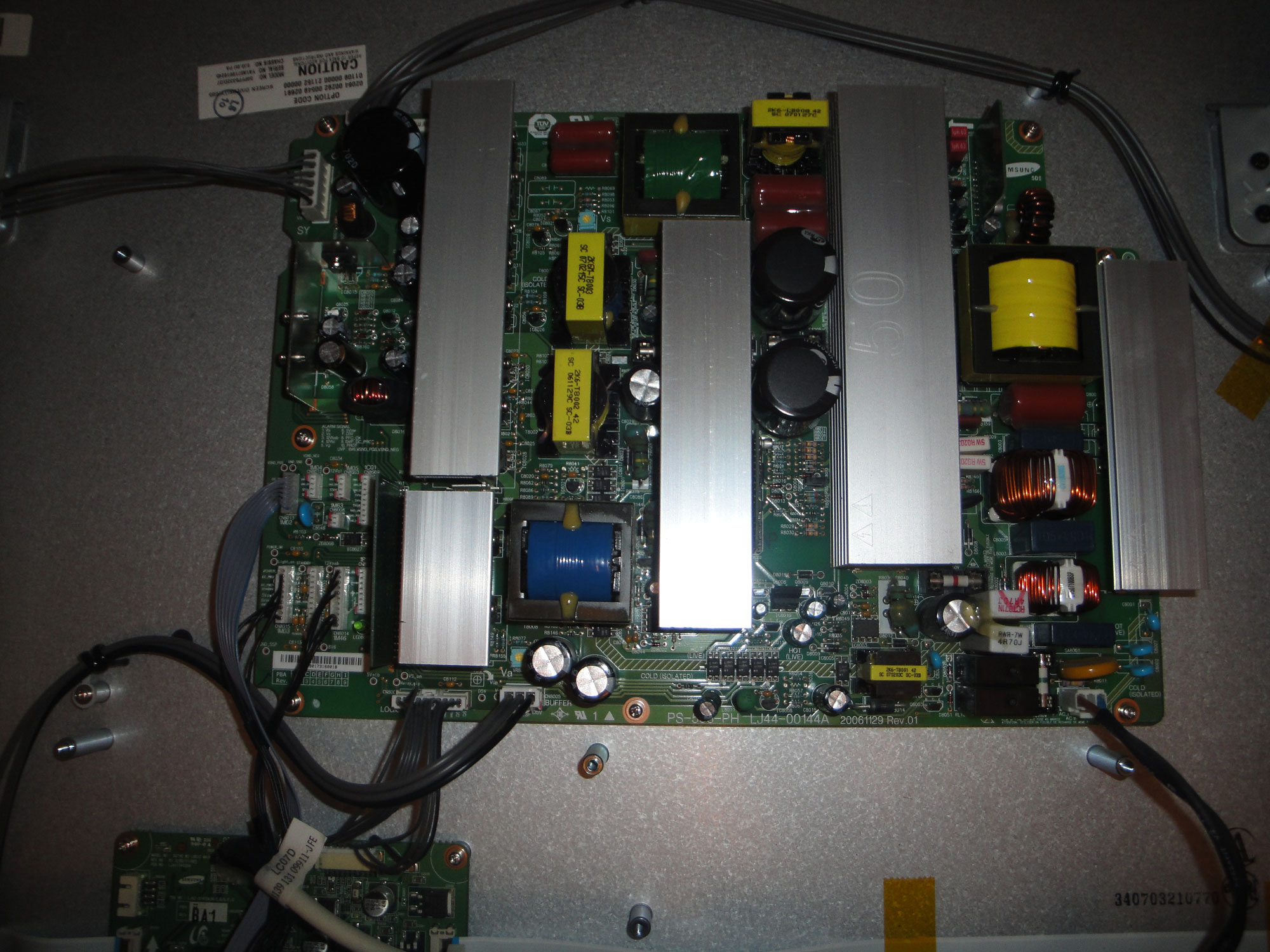

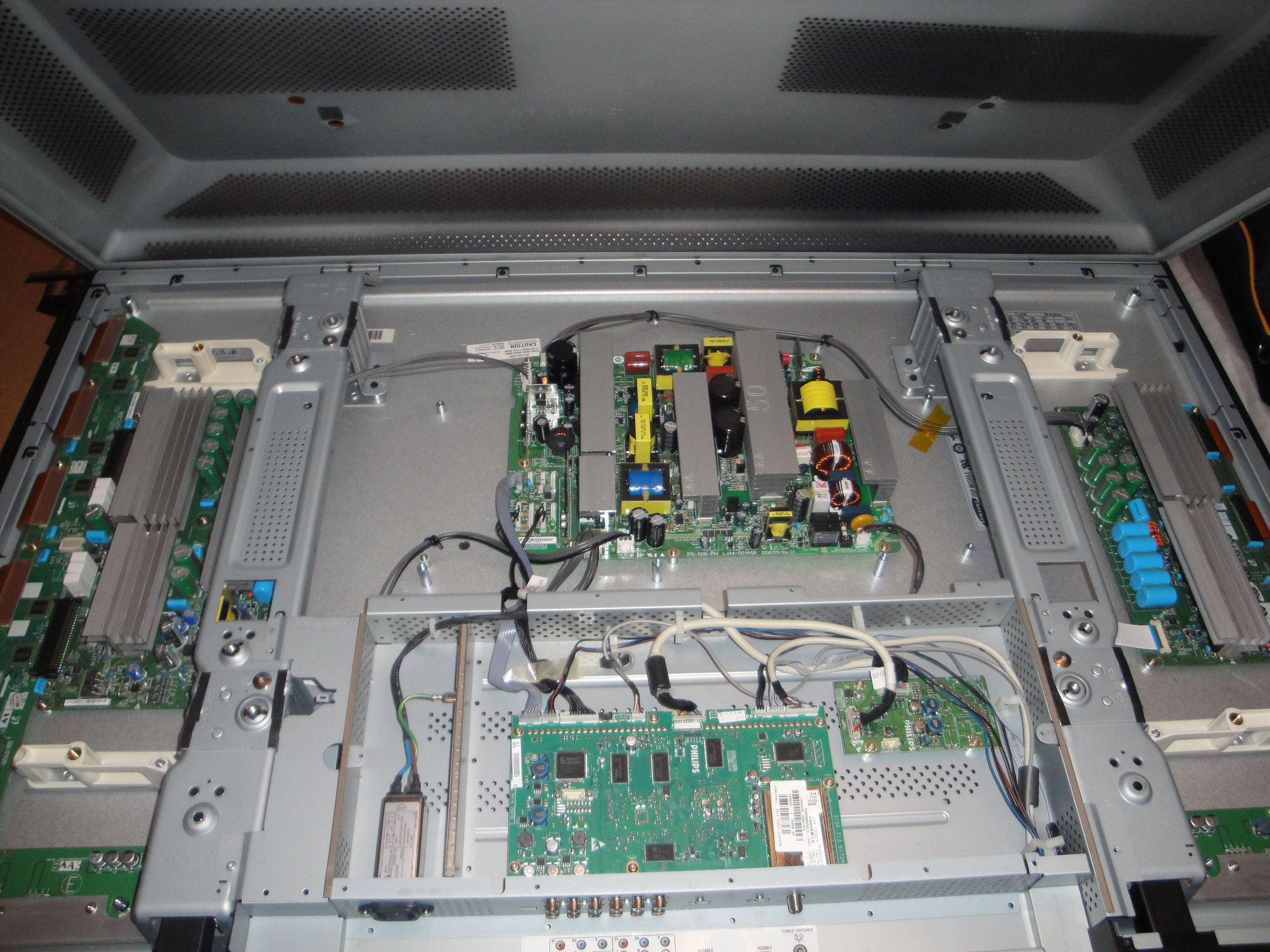

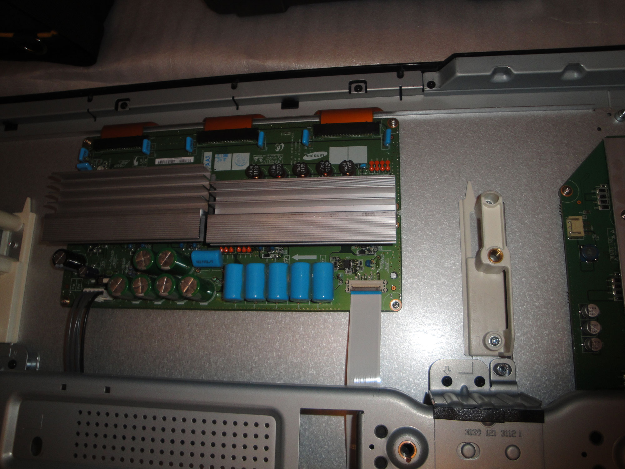

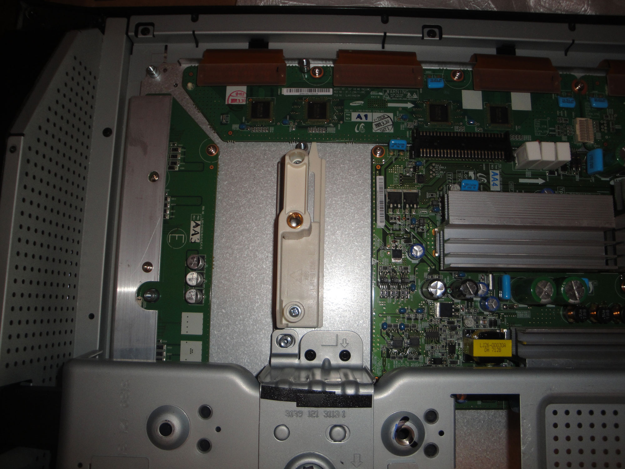

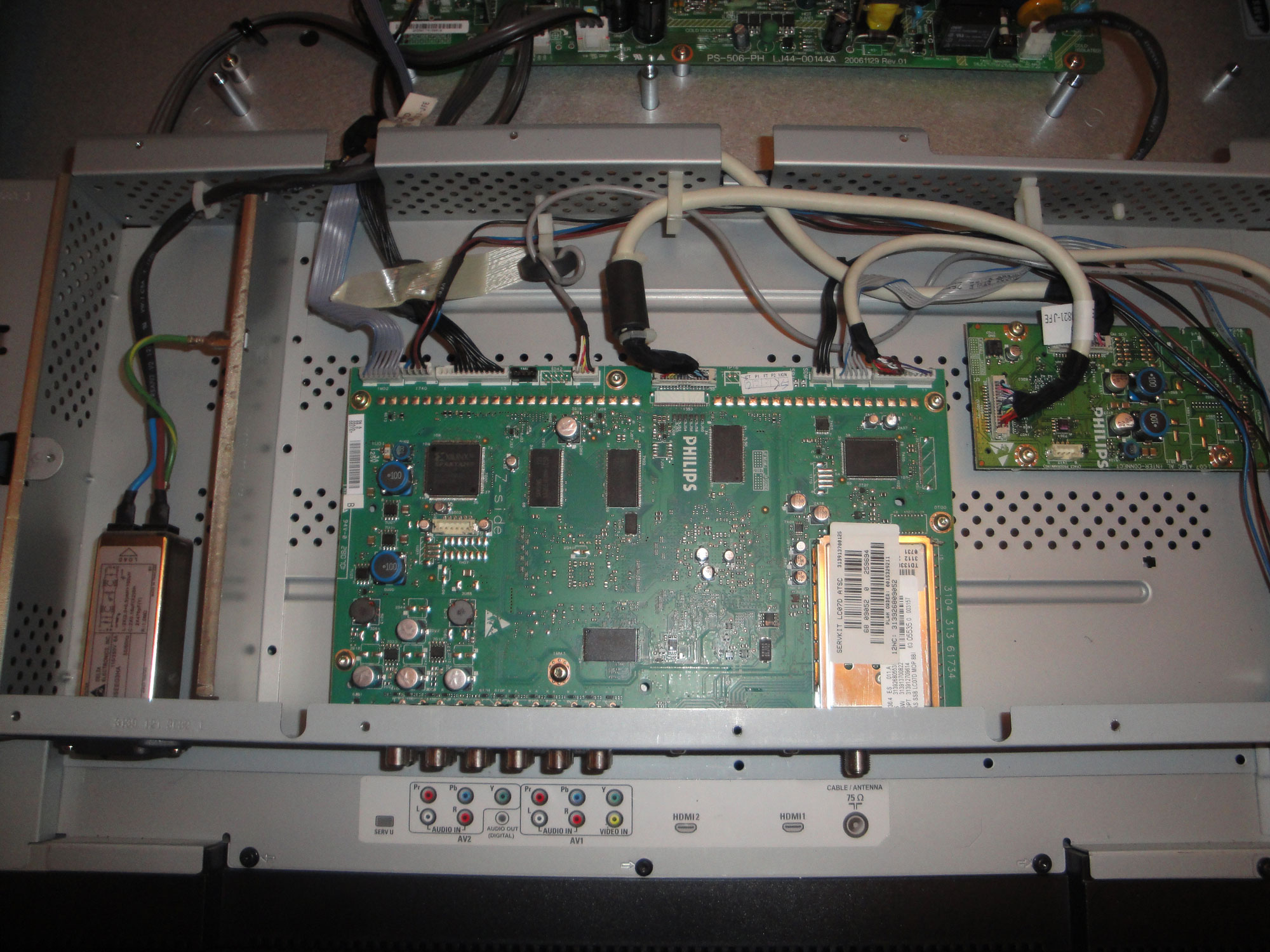

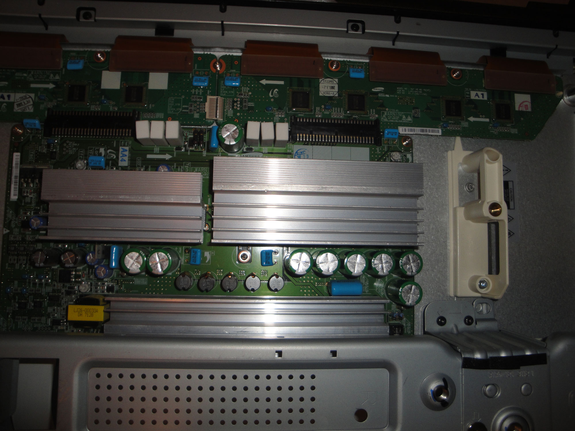

    I have taken the liberty of attaching a few snapshots of the TV board just in case. First pic is the overall layout and then the pics follow from left to right in the TV.
    Thanks for looking.

      Re: Philips 50PFP5332D/37 Video Inputs Do Not Work
      Well, the diagnosis is easy. The problem must exist on the Small Signal Board. That generates the OSD and menus, as well as processing video and sound inputs. It is the larger board in the 5th picture 3104 313 61734 (new) or 313926807343 (factory refurbished).
      If you want to troubleshoot the board yourself, the service manual is EJ3.0U PA
        Bill,
        Thanks for the reply and input. I had come to a similar conclusion. I will find the manual and TS the board to be 100% sure before buying it.
          Originally posted by BSH
          Bill,
          Try searching elektrotanya.com for the chassis number. If you do have to buy a new small signal board make sure you buy from a reputable seller. Also, try to get one from the same model TV.
