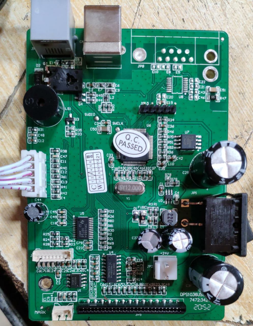

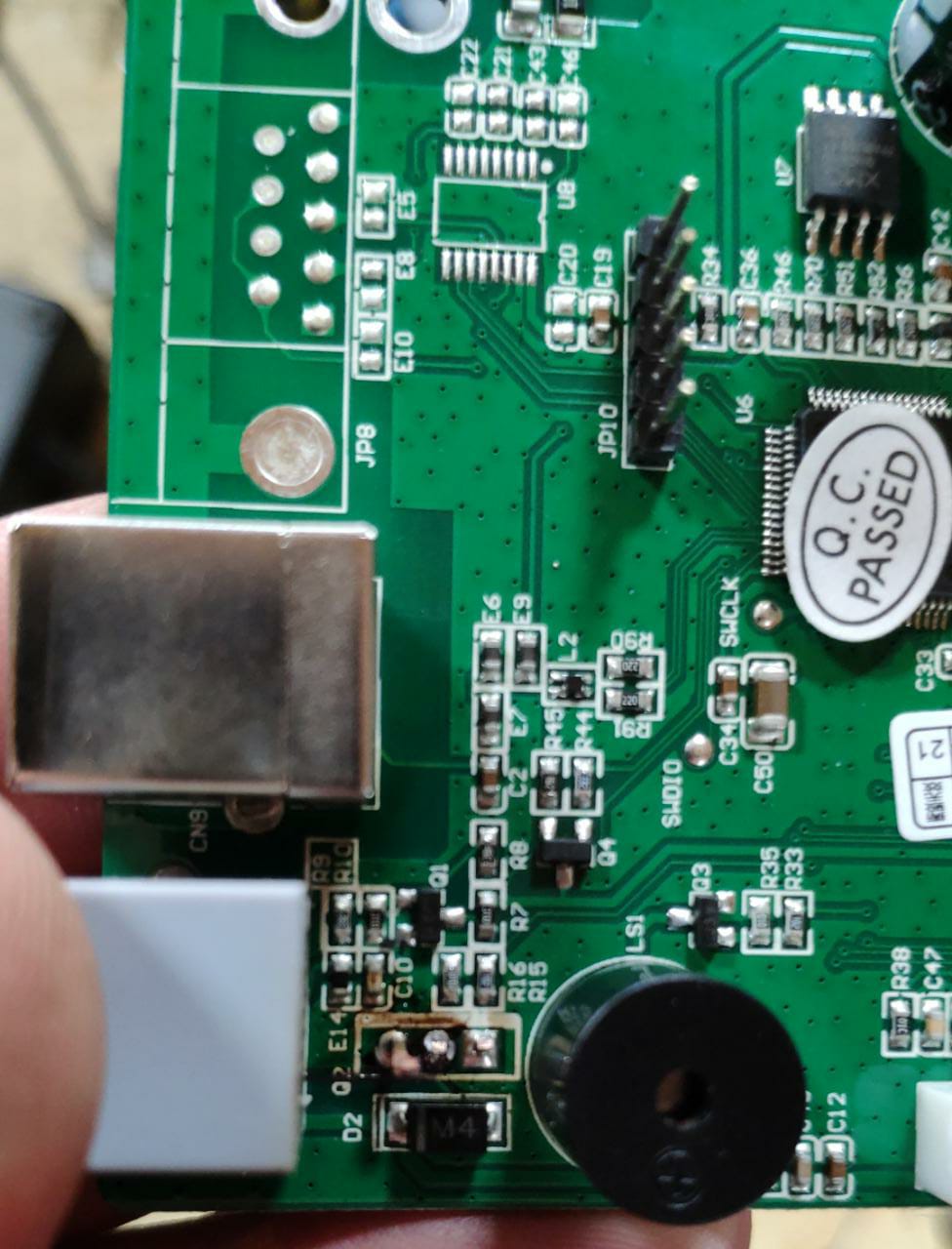

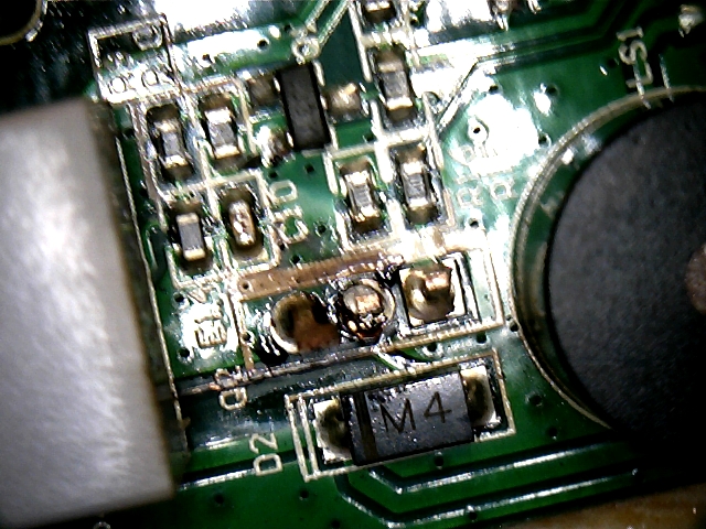

i there is a blown transistor... cannot determine it
please help...
this transistor is responsible for cash drawer open...
the transistor is Q2

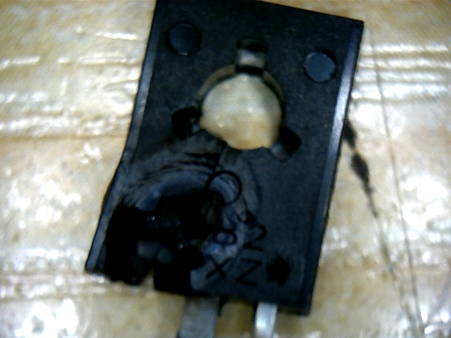

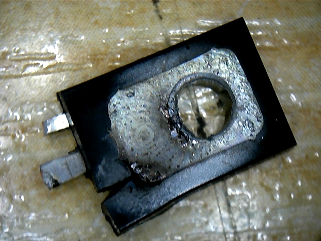

Post close up images of Q2,both sides. Are there any part numbers on it .

here :

here also the Q2 location

10-18-2021, 08:03 AM
Re: xprinter xp-q160l

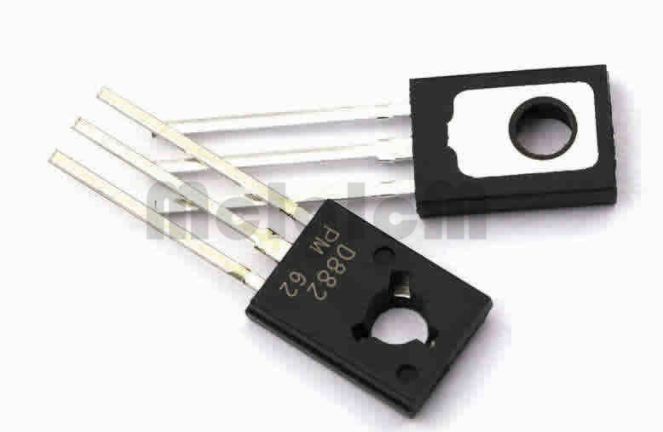

Very similar to D882 (2SD882).

i will try it... thank you very much
