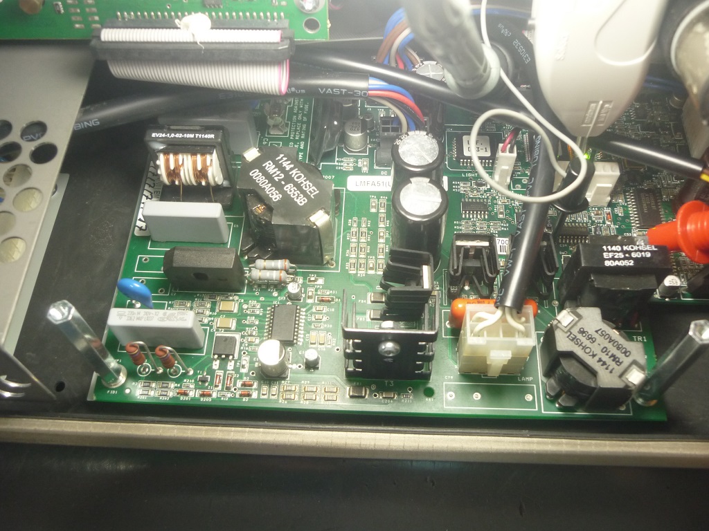

    Equipment: HP DesignJet T1200 MFP. CQ653A. Scanner Module.
    History of the device:

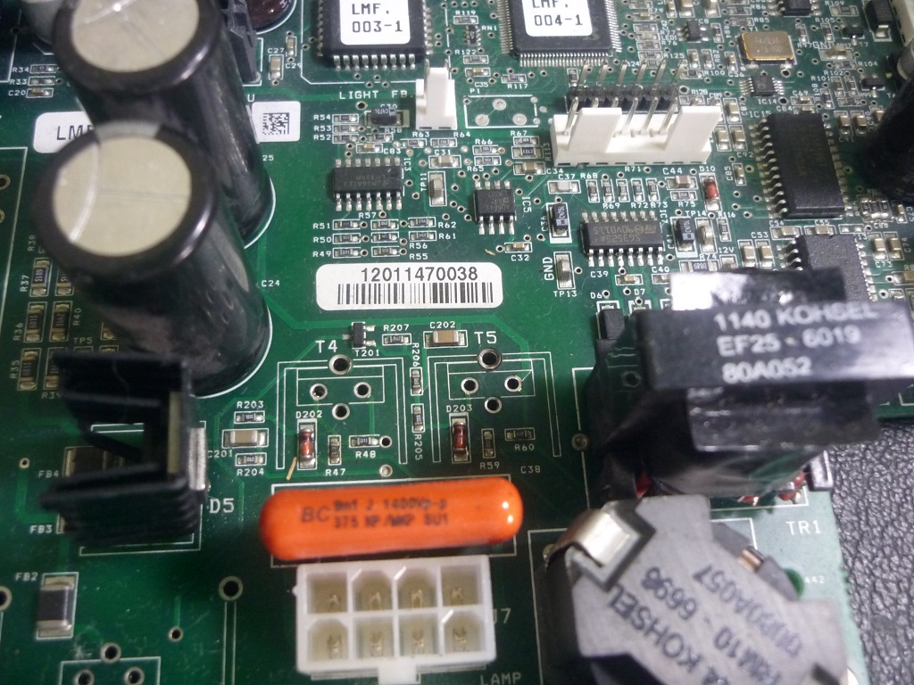

    The user of the equipment had problems with the lamp, due to this, he proceeded to replace it, but he said that the bulb was damaged, he replaced it and when he turned on the equipment, there was a short circuit on the "Driver- Board LMFA51 ". They replaced the blown fuse (2 amps) and burned again, then placed a 12 amp fuse by mistake and another short circuit and smoke occurred in some resistors.
    They called me to check the damage occurred on the aforementioned card.

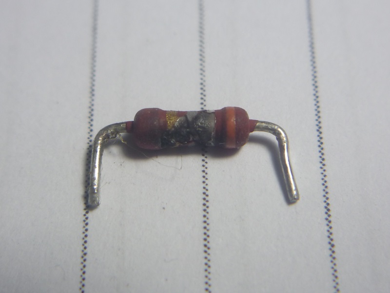

    After the diagnosis, the result was 2 Mosfet (IRF840A, Change by IRF840) that operate the lamp in short circuit 3 open resistors.
    Those components were replaced. When installing the card again in the scanner and turning it on, it started to work.
    Since the Driver-Board card was installed. There are two led diodes, one in green (LED1) and the other in yellow (LED2). As it is the first time that I review a team like these, I do not know if the color of the yellow light is normal or not.

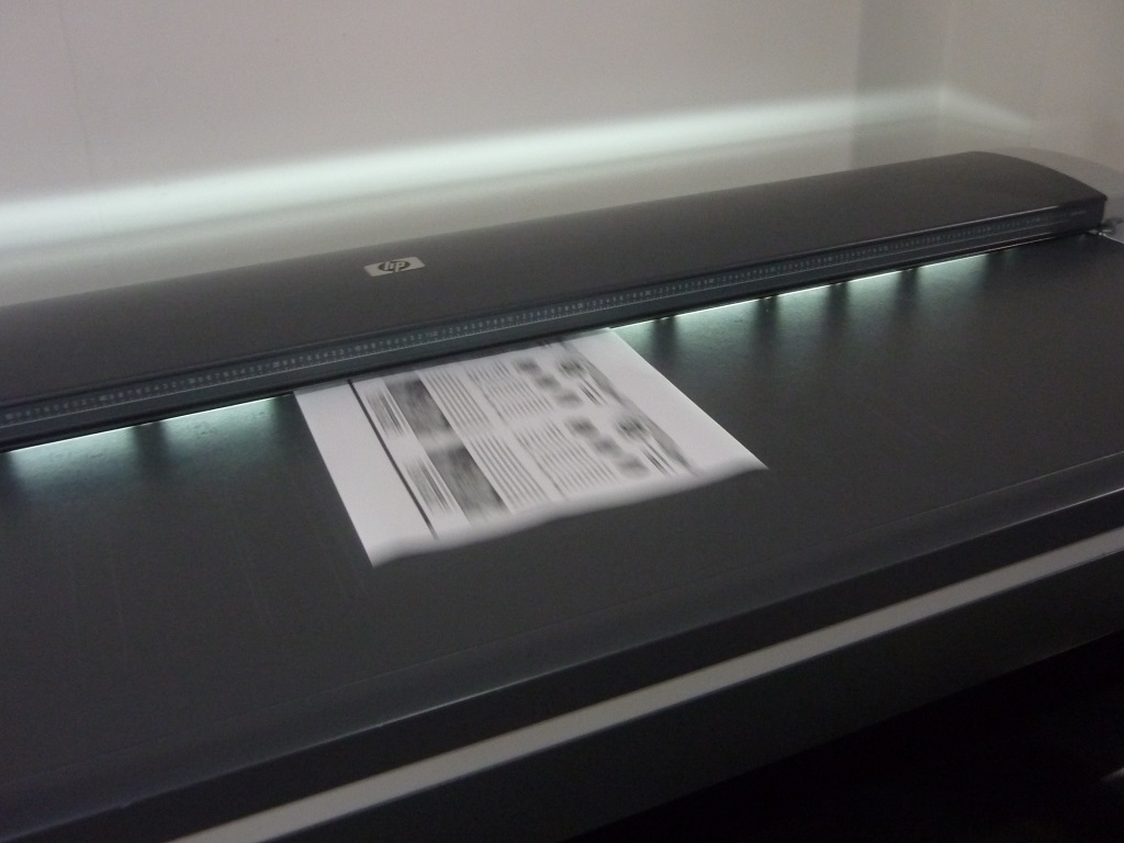

    Several scanning tests were performed and operated correctly. Client indicated that he would proceed to the calibration process.

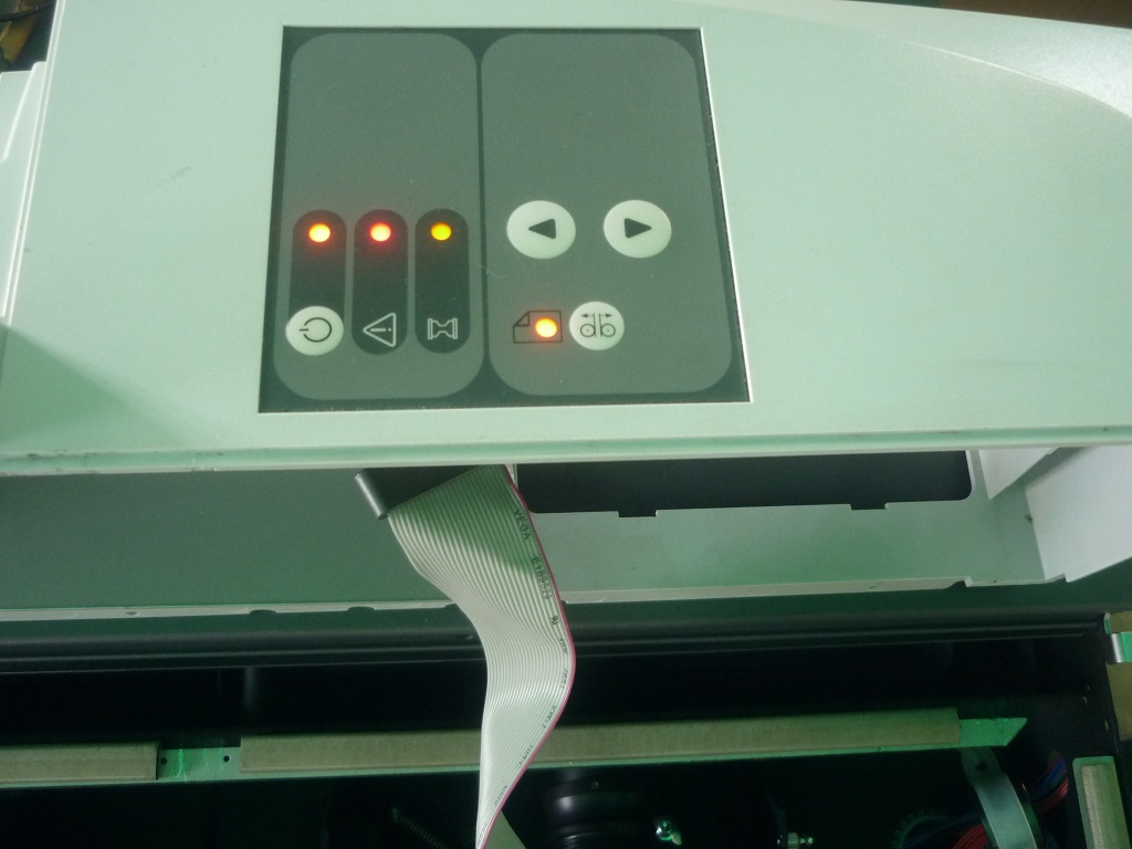

    The warning light with the exclamation symbol is activated and note that it has the following sequence (4 pulses, pause, 12 pulses, pause, 15 pulses and it is repeated indefinitely).

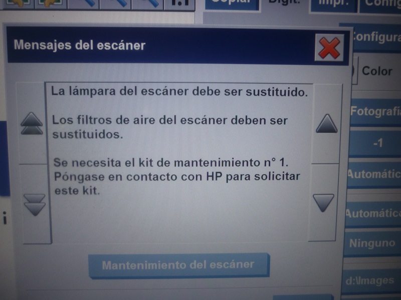

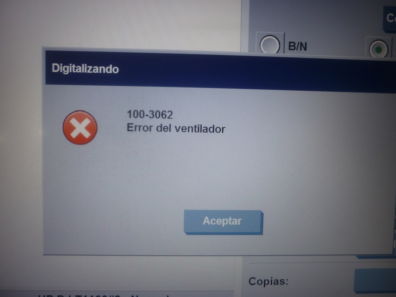

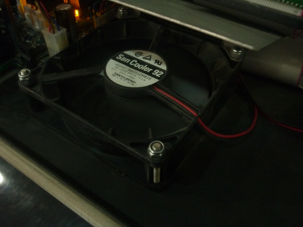

    On the monitor screen of the equipment, twice the error was shown: 100-3062 and 70218. On the screen indicated a lamp replacement warning, the client indicates that this error does not cause the scanner to turn off and a problem with the fans. But these are working
    correctly. Since they rotate at good speed and turn on immediately with the operation of the scanner and the operating voltage was verified.
    At other times you can hear the fans speed up.

    Error: 100-3062
    Module name: Scanner
    Category: User Correctable
    Message: Fan error
    Message: Fan error

    Someone of you will know who is the manufacturer of that LMFA51 card?
    Will they have the electronic diagram of that card?
    What values of signals and voltages should I have in the TPx of that card? In order to compare with the one I have in review.
    Any idea that I can review the most?
    Can someone tell me the color of the LED 1 and LED2 lights on your Driver-Board card?

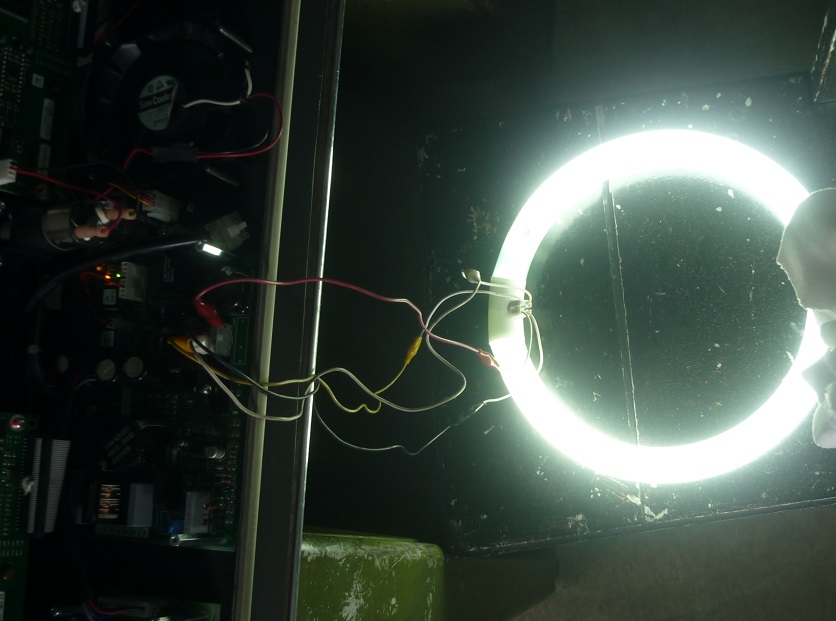

    The bulb is replaced by a new one and the problem persists, the device restarts itself and generates fan failure, instead if I connect a bulb of equal power outside the scanner, the device does not restart and the fans do not fail.

    putting the wrong fuse in, may have damaged something else. Do these fans spin freely? Are them 3 wire fans? Take em totally apart, clean them, lube them and reinstall. If it is a 3 wire fan, maybe it spins, but not fast enough, creating an error.

      No fans are 2 wires but the card has 2 chips that control and monitor the operation of these fans.

            Case closed.
            Replaced open resistance that caused problems in the PFC.
