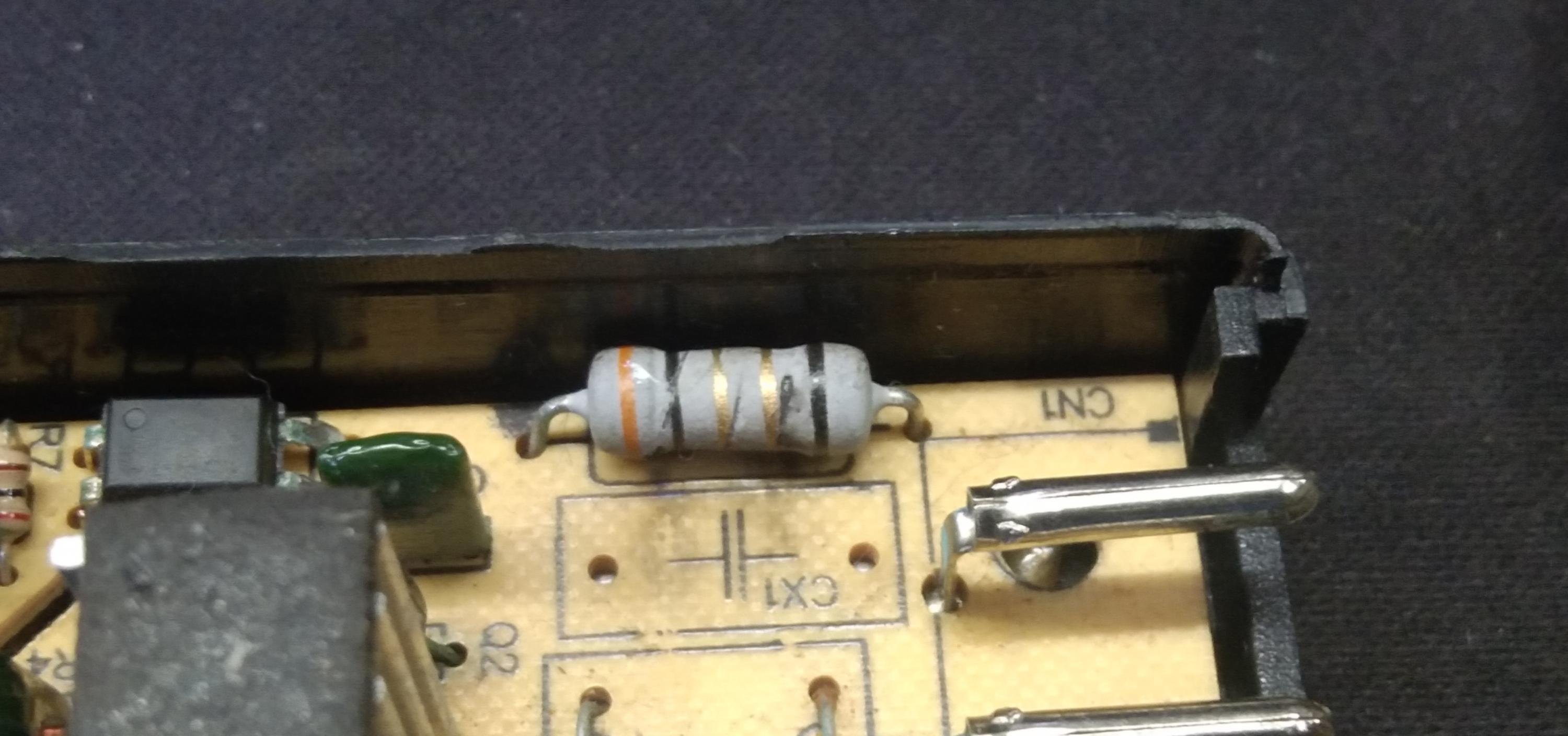

    Kindy Help me For this?
    Hello to all
    Orange /Black/Gold/Gold/Black
    Help me for this Resistor Value or can replace other Value
    TIA
  • R_J
    • Jun 2012
    • 9582
    Re: Kindy Help me For this?
    It is a 3Ω, and looks like a 1watt metal film flame proof
