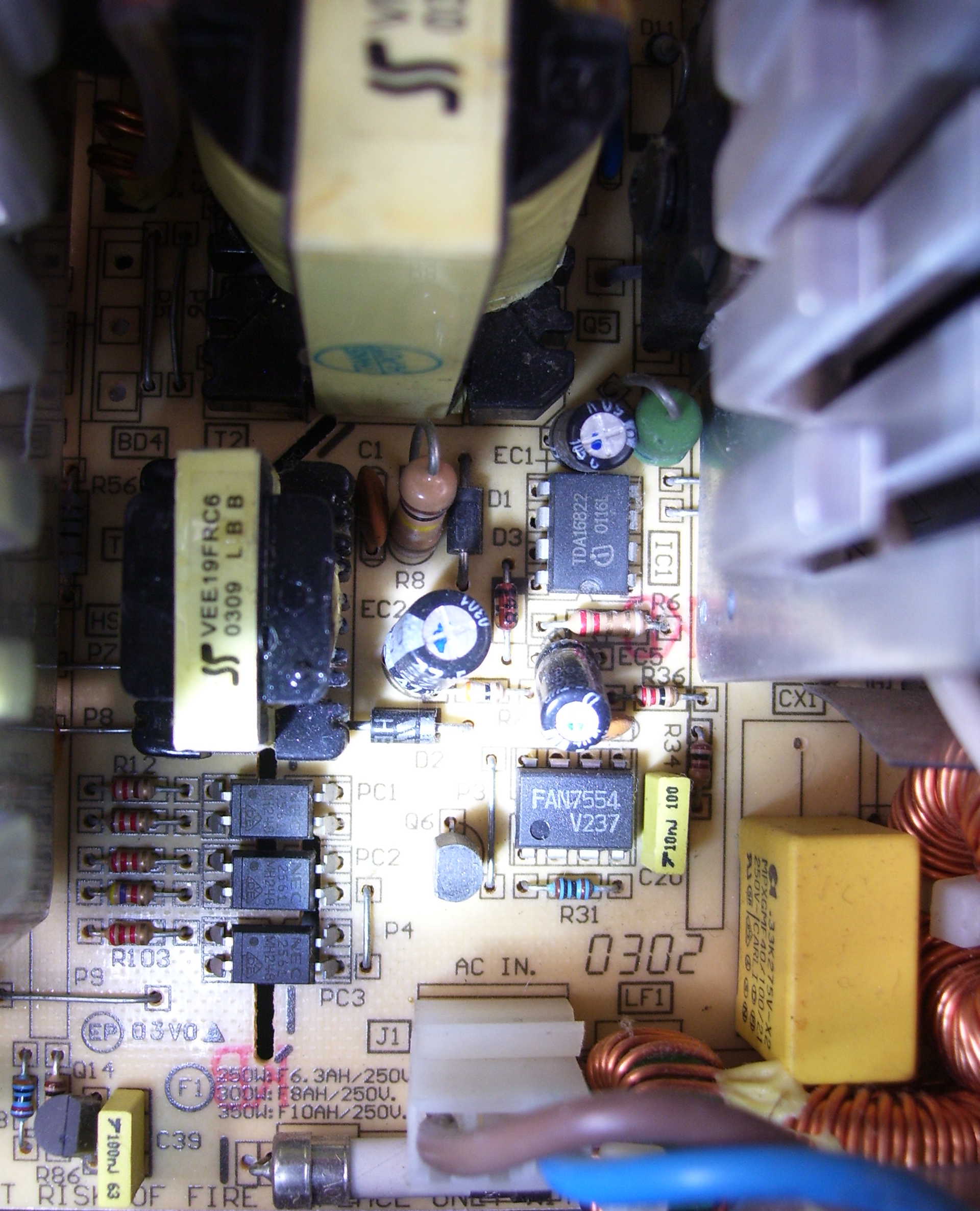

        Near the beginning of this thread, in post #14, there is photos of a Seasonic SS-250FS
        https://www.badcaps.net/forum/attach...0&d=1249818980
        Here is one another so-called SS-250FS,
        Same brand of capacitors - PCE-TUR,
        but i don't see any sign this one being a 2-Transvestite design.
        It's a different board (and appears to me to made later)
        Looks like the 5VSB is controlled by a TDA16822 PWM Controller chip
        Just goes to show that you can't always judge a book by it's cover
        Also highlights the subjectivity of convention.

          #44
          Re: The whole Two Transistor Thing
          I guess it is single switcher forward, for 250 W it is enough.
