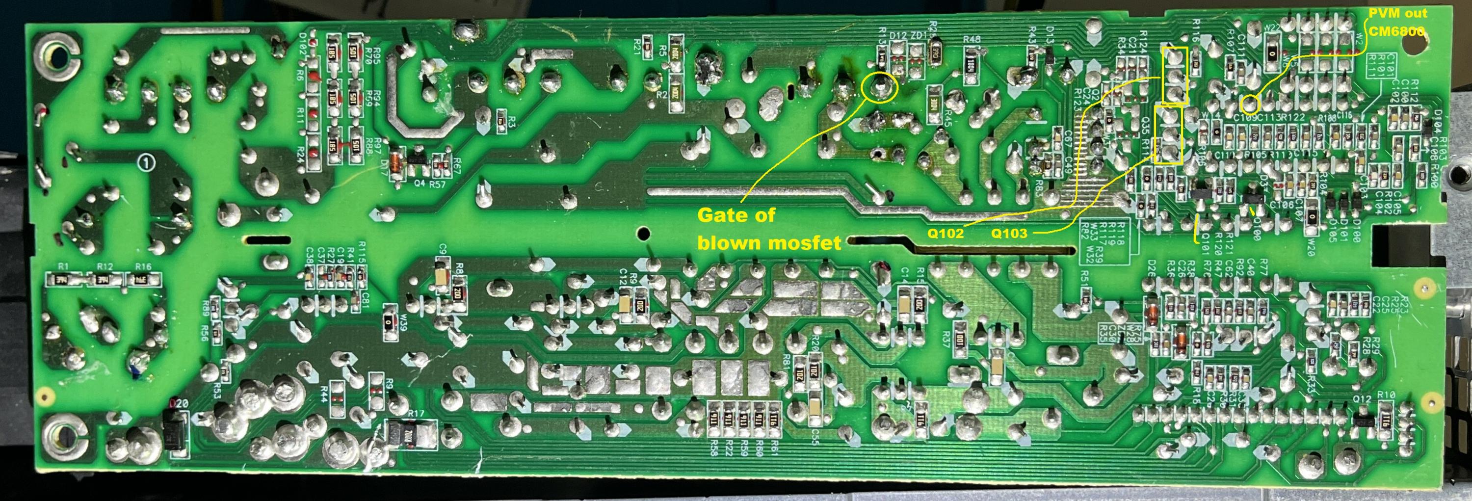

                          what is driving the gate pin?

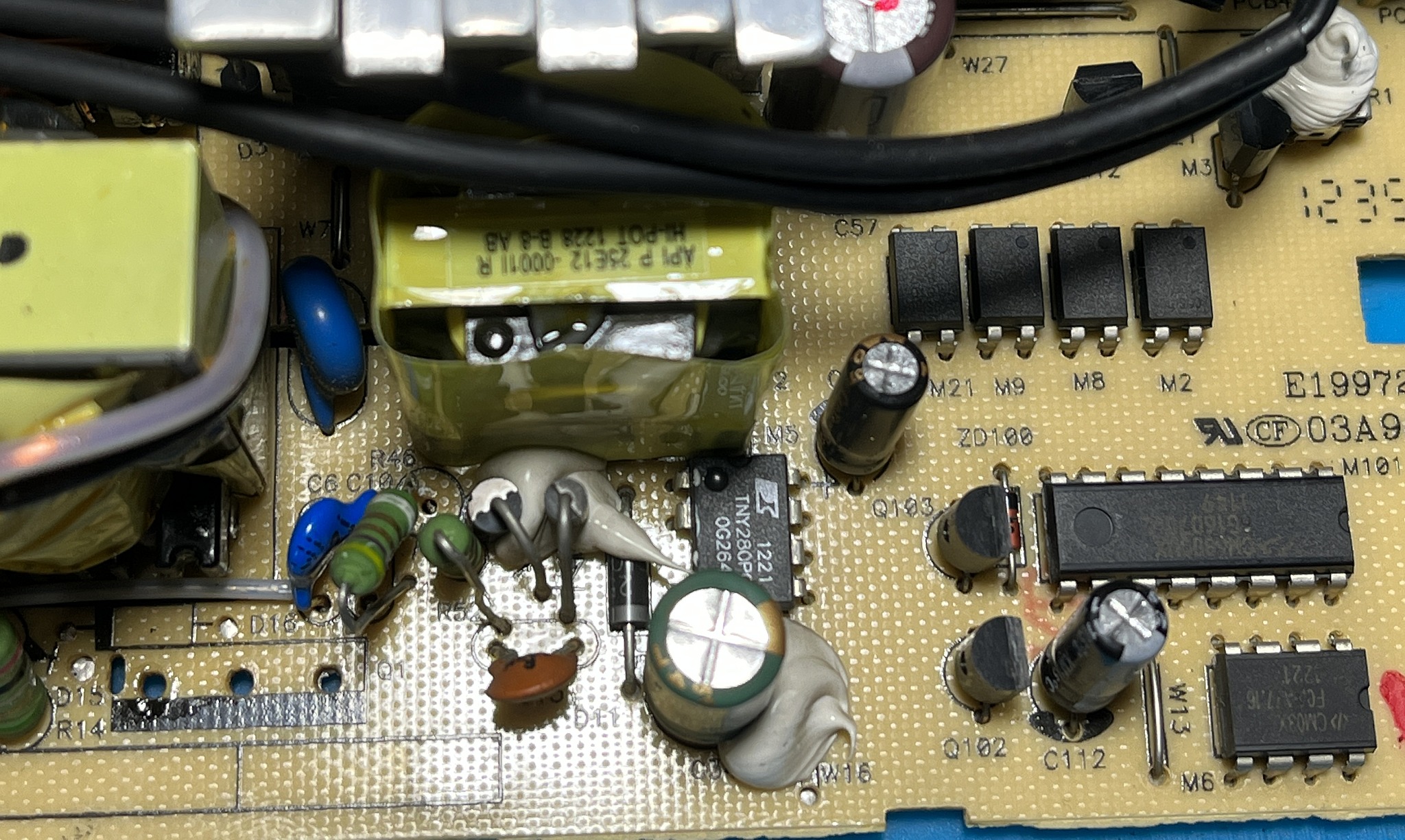

                            Sorry, but I‘m not sure how to find the driver. I checked also IC TNY280PN because it was mentioned in a thread as faulty at a similar PSU, but it shows the same values as on the good PSU (of course soldered out).
                              #34
                              Re: psu ac240as-01 dell Optiplex 7010 pc tower
                              the TNY is for the standby voltage
                                check pin 11 of the cm6800 - see if it's shorted to ground or + and if not,
                                find out how it gets to the gate pin of the fet.
                                  Thanks for the info stj, no short between PWM out and Gnd, Vcc or Vdc, every meassuring shows nearly the same values on bad and good PSU (meassuring in diode mode, IC CM6800 soldered in).
                                  Also meassuring on CM03X shows no relevant differences with bad and good PSU.
                                  Am I right, that the problem must be on the primary side of the PSU?
                                        the glue only causes problems if it turns brown
                                        follow the pwm pin and see if it goes to any transistors to reach the fet.
                                          @glue: everything is white, so should also be ok.
                                          I meassured once again between PVM out (CM6800), gate of blown (now new) mosfet and also all pins of the 4 transistors I found (Q100, Q101, Q102 and Q103). Every meassuring shows nearly the same values (max. 10Ω difference) between good and bad PSU. No direct connection, the lowest resistance is between PVM out and gate (40Ω - same on good and bad PSU!).
                                          It's frustrating to find no differences at meassuring between good and bad PSU. I think I meassured all the pins on primary side to ground - nothing
                                          I'm nearby to give up and try once again to switch on the PSU (I have another good mosfet, if it blows again).
                                          What do you think about driving the primary side of the PSU with low voltage from an extern PSU? I think about putting in 2-5V DC at the rectifier +/- to check if there gets something hot or the extern PSU switches because of a short to ground.
