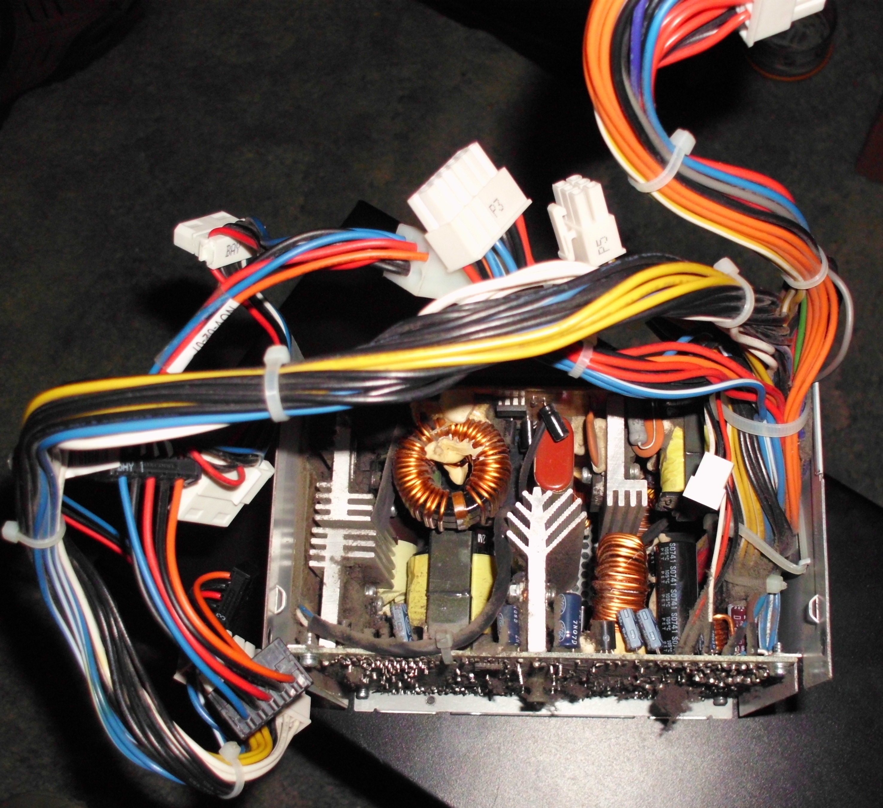

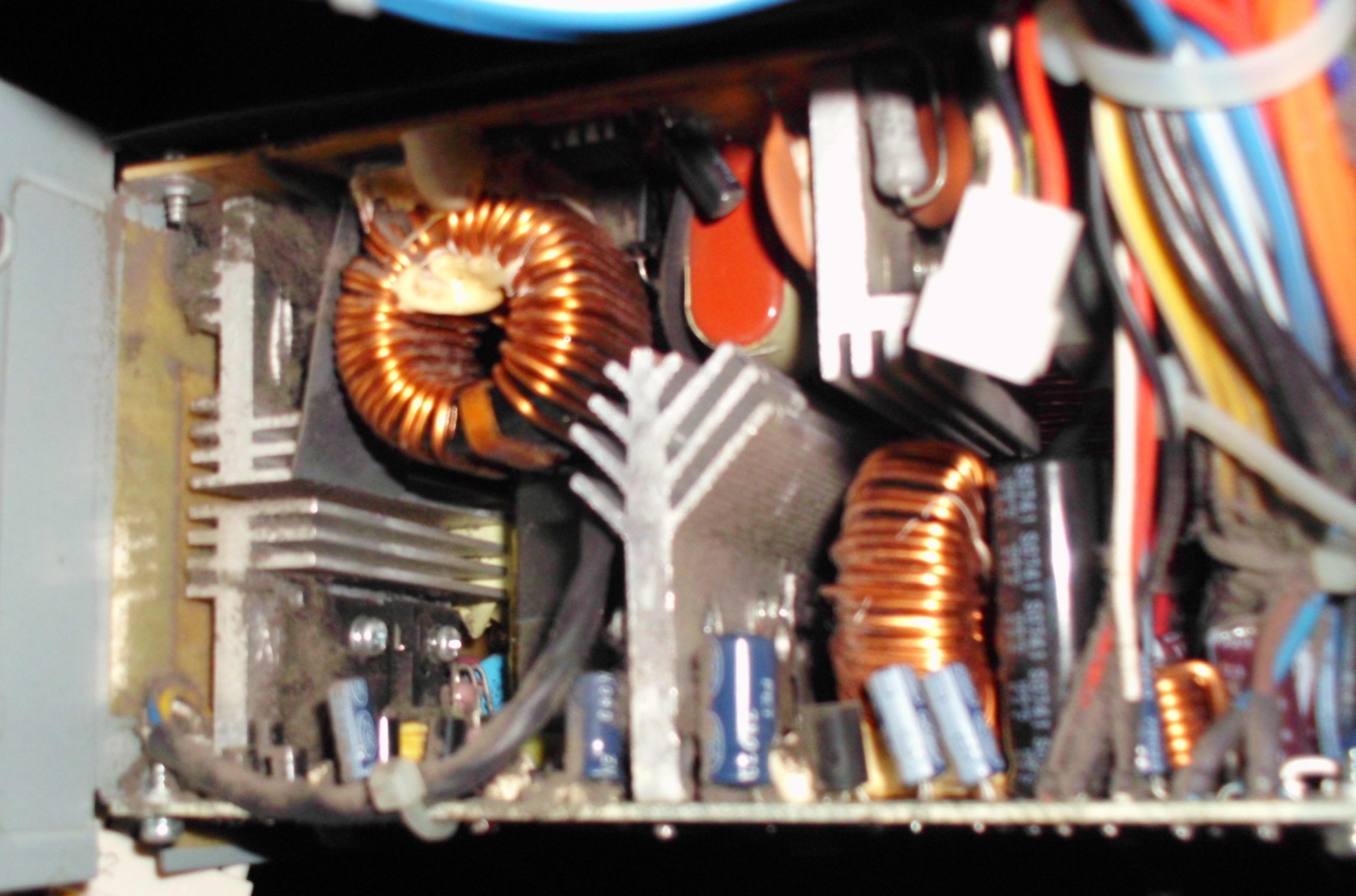

    Dell Precision 490 PSU (N750P-00)
    I recently got this old computer free and i cleaned out the dust before doing anything
    it seems to have a habit of now powering on and giving a psu related error
    on the motherboard there are a few 6.3v 2200uf caps that look like they are starting to bulge near the ram
    so i opened up the psu and oh god i should have done this i the 1st place i need to take it outside and blast the bunnies out of it
    Any common fail points i should be aware of in the PSU?
    EDIT: After cleaning that out i have managed to get a code meaning "A possible system board failure has occurred."
    some times it boots other times it gives me this

    Re: Dell Precision 490 PSU (N750P-00)
    This switching power supply looks like the power supply from hell
    One board on the top and one on board on the bottom

    • Stefan Payne
      • 1267

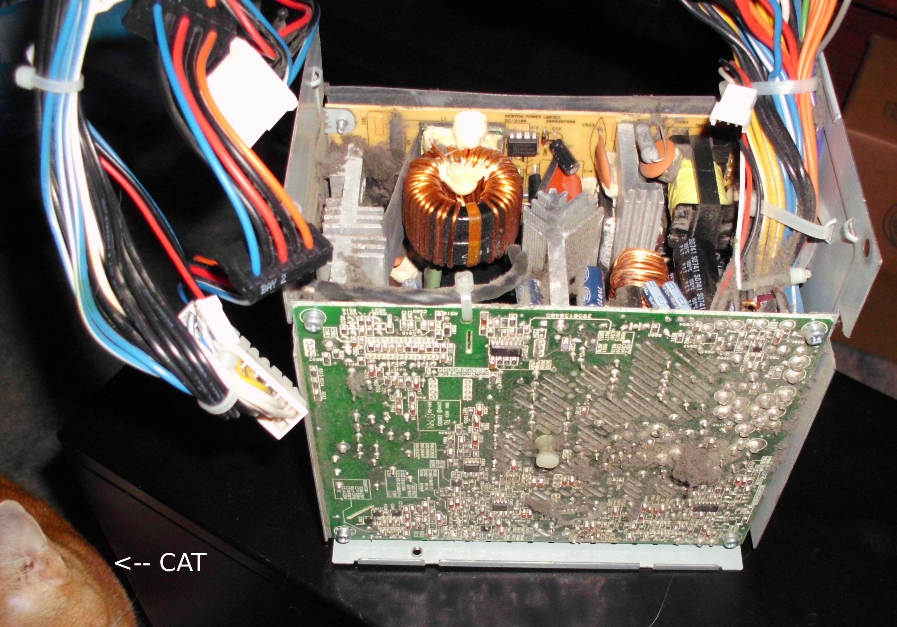

      Yeah, but its not as bad as it looks once you removed it.
      Essentially its a normal PSU with the AC-DC Part on one Board and the PFC Section on the other.
      I have two (NMB) Dual PCB PSU here myself...

        I hope all those large heatsinks are at common ground potential.

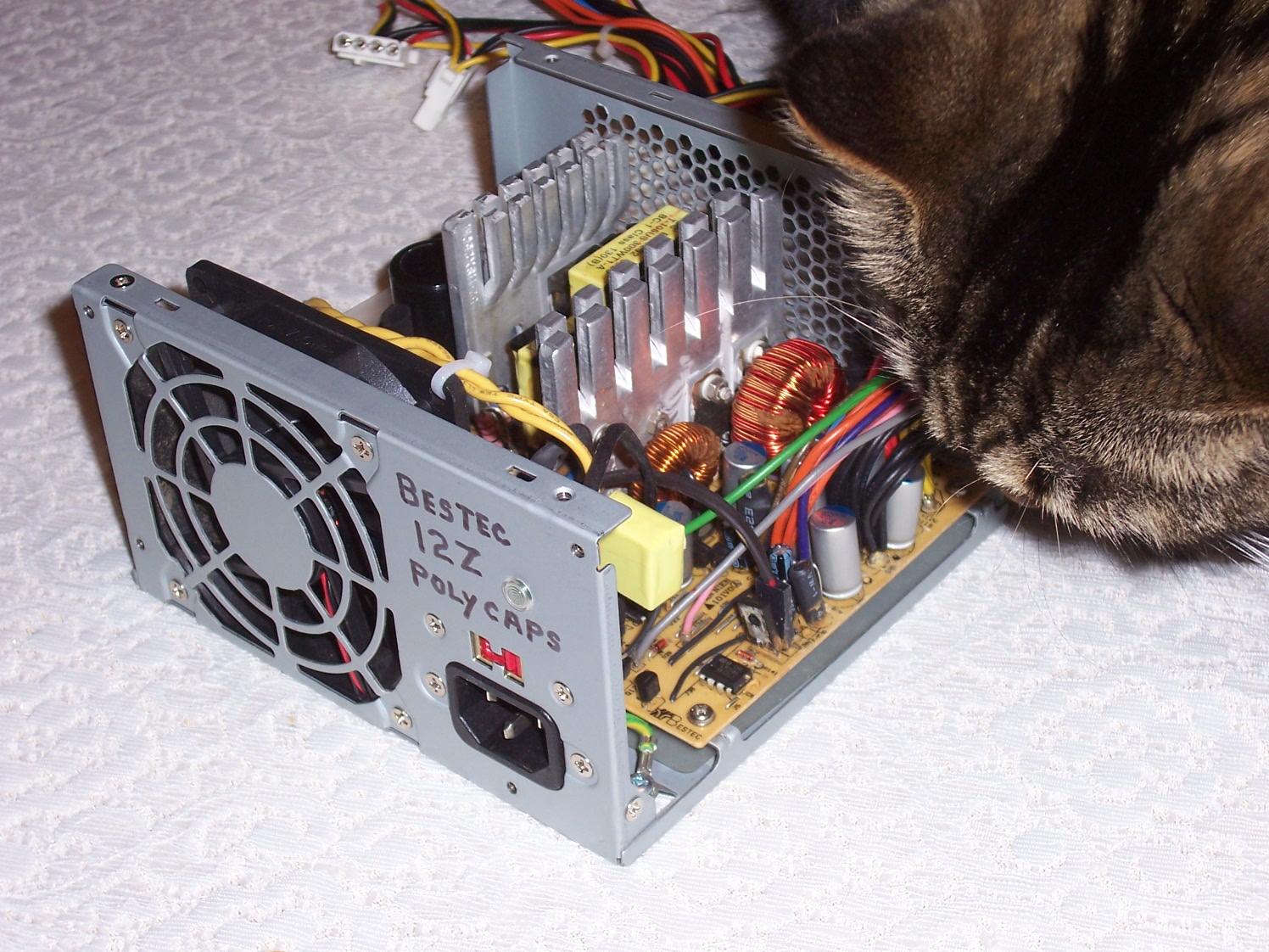

        • everell
          • Jan 2009
          • 1514
          My kitty likes to help me work on my power supplies too!
          Your power supply looks cool, but will be difficult to work on. If you are a "professional" electronics technician, take the pc boards out of the metal case to do repair work - leaving the interconnecting wires in tact. When doing this, you need to know where to put fingers, and where not to put fingers! If you are not tech savy, the power supply either works or should be trashed.

            I would add this comment
            evilkitty—>
            If you decide to recap both board
            If I were going to do this
            I would mark the wires that go between the two boards and separate them it will be easier to deal with it that way
            But make sure that you mark each wire and take a photo of it before you start
            everell's —>
            Does your kitty get in the way when you try work on the power supply

            • everell
              • Jan 2009
              • 1514
              When I recap a psu board, I do so with power OFF. So if you are going to recap your psu boards, remove the boards from the metal case (no need to remove the interconnecting wires) and change the capacitors with power OFF! Be sure you install the new capacitors with polarity correct or they will blow up. Then put the two boards back into the metal case before applying power.
              I find it to be very difficult to change capacitors on power supplies without first taking the pc board out of the metal case.
