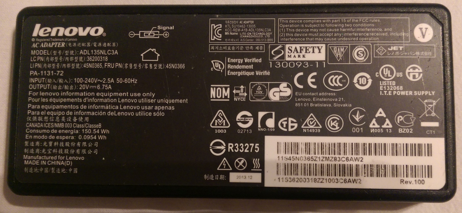

    Anyway what we have here is its AC adapter.
    Made by Lite-On it's model no: ADL135NLC3A

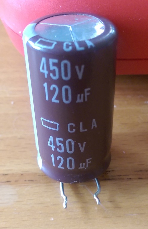

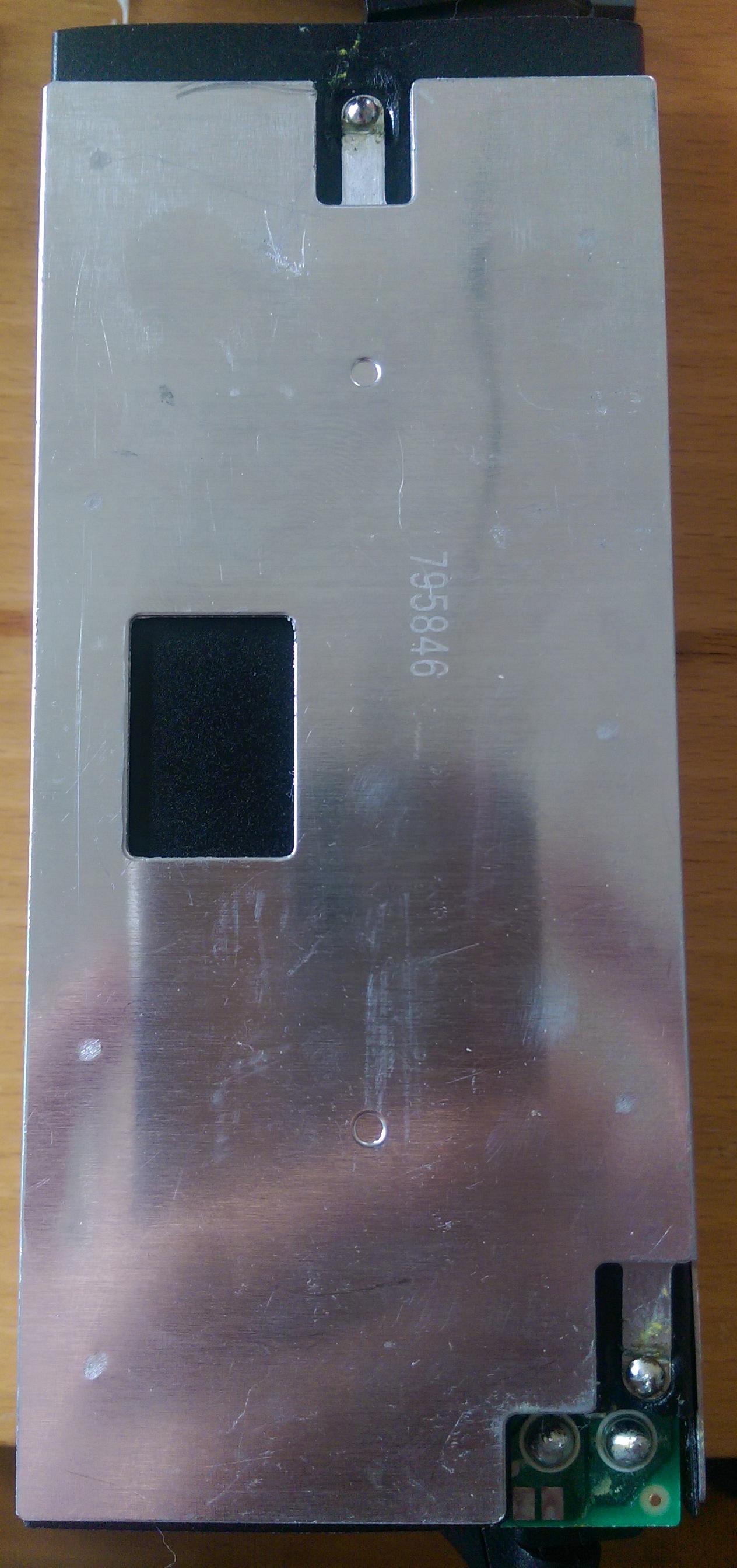

    So I thought for sure the adapter is bad, so I cracked it open.
    Inside I found the bulk capacitor bulging: UCC CLA 450v 120uF
    I replaced it with a Nichicon PT 100uF 450v cap.

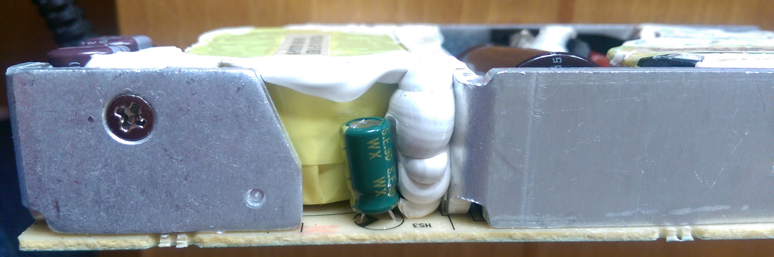

    There was also a Rubycon YXM 47uF 50v that I replaced with a Suncon WX.
    The output caps where 2x UCC KZH 1000uF 25v, they measured ok so I reinstalled them.
    But this made no difference to the behavior of the PSU or the laptop.
