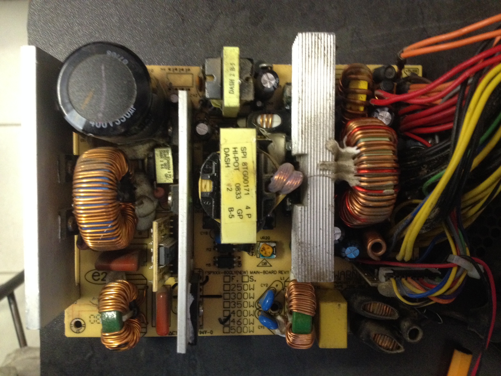

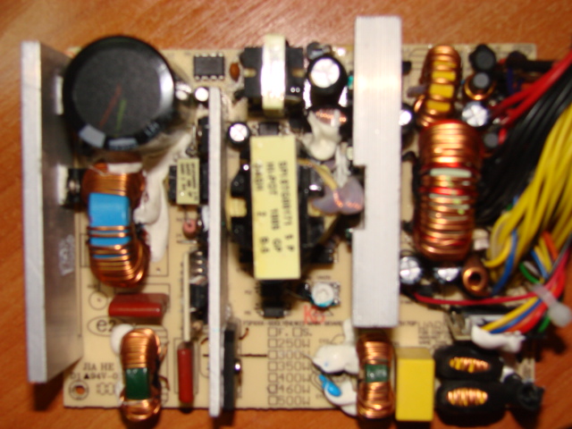

          Is your PSU internally looks like this ..... (Image attached below)

            Re: Gigabyte GE-P585A-C2 ATX PSU Schematic
            Yes that is how the PSU looks internally.
            The resistor that is damaged comes directly from the large primary capacitor to the small 5v transformer.
            Then off that line a 204 resistor feeds pin 5 of the IC.

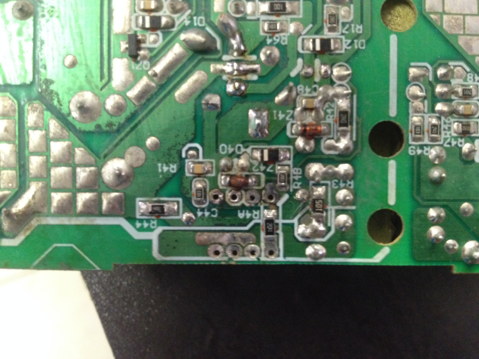

              Here are pics. R44 is faulty I believe. I scratched on it too much so numbers are gone now.
                Still have you not realized what is R44 value ? Your circuit is totally similar to that schematic of FSDM311 . Look at the schematic . What is the R44 Value ? It is 4R7 . That means it is a resistor of 4.7Ω . It is nothing but a fusing resistor . And PIN 5 is Vstr , not Vcc . PIN 2 is Vcc .
                R44 has blown that means you have a short circuit in the 5VSB Primary side . May be FSQ0270R faulty itself . Also Find out which components have blown there along with the IC .
