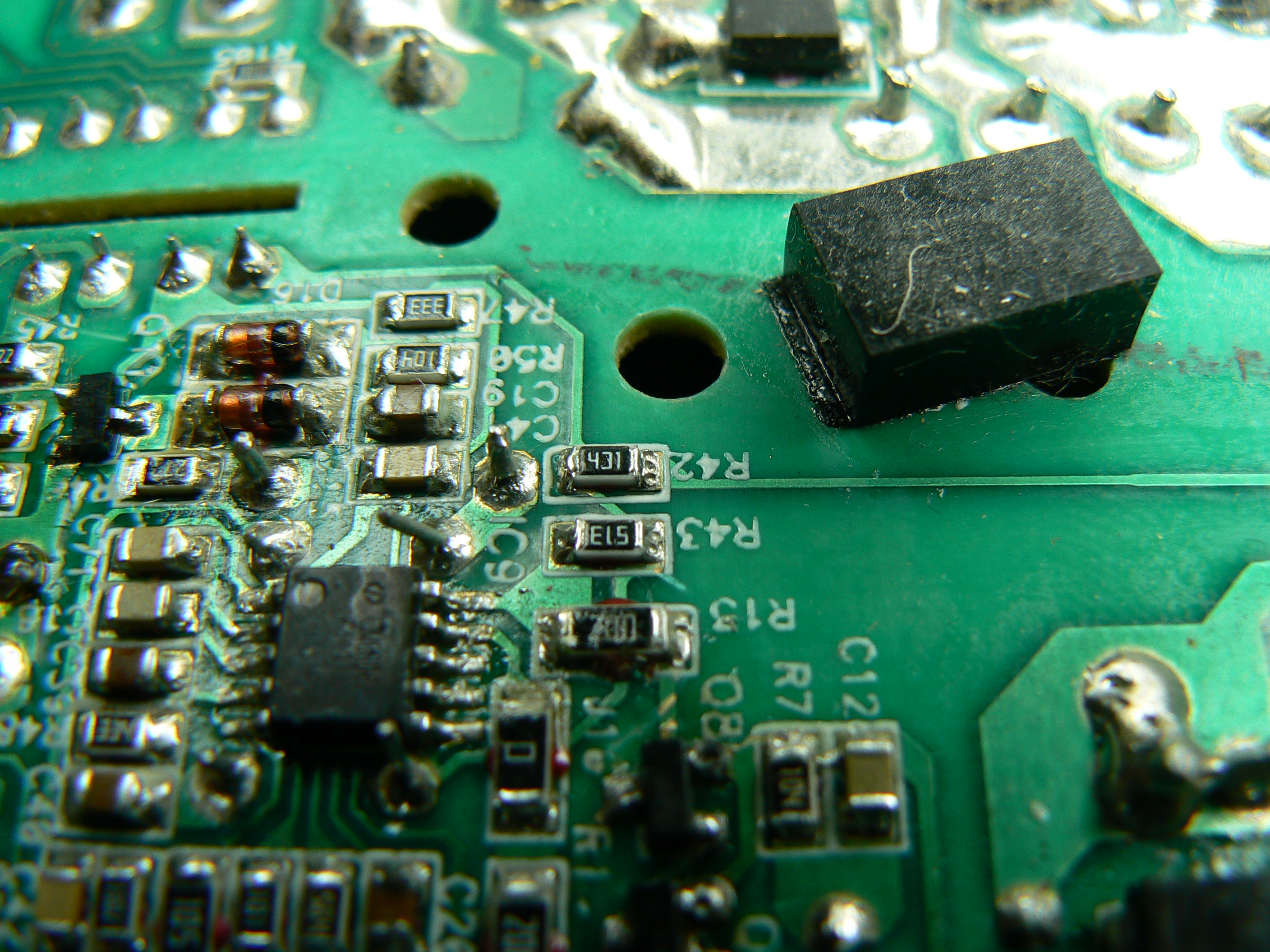

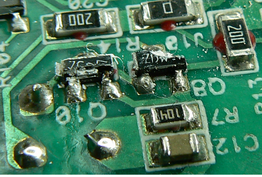

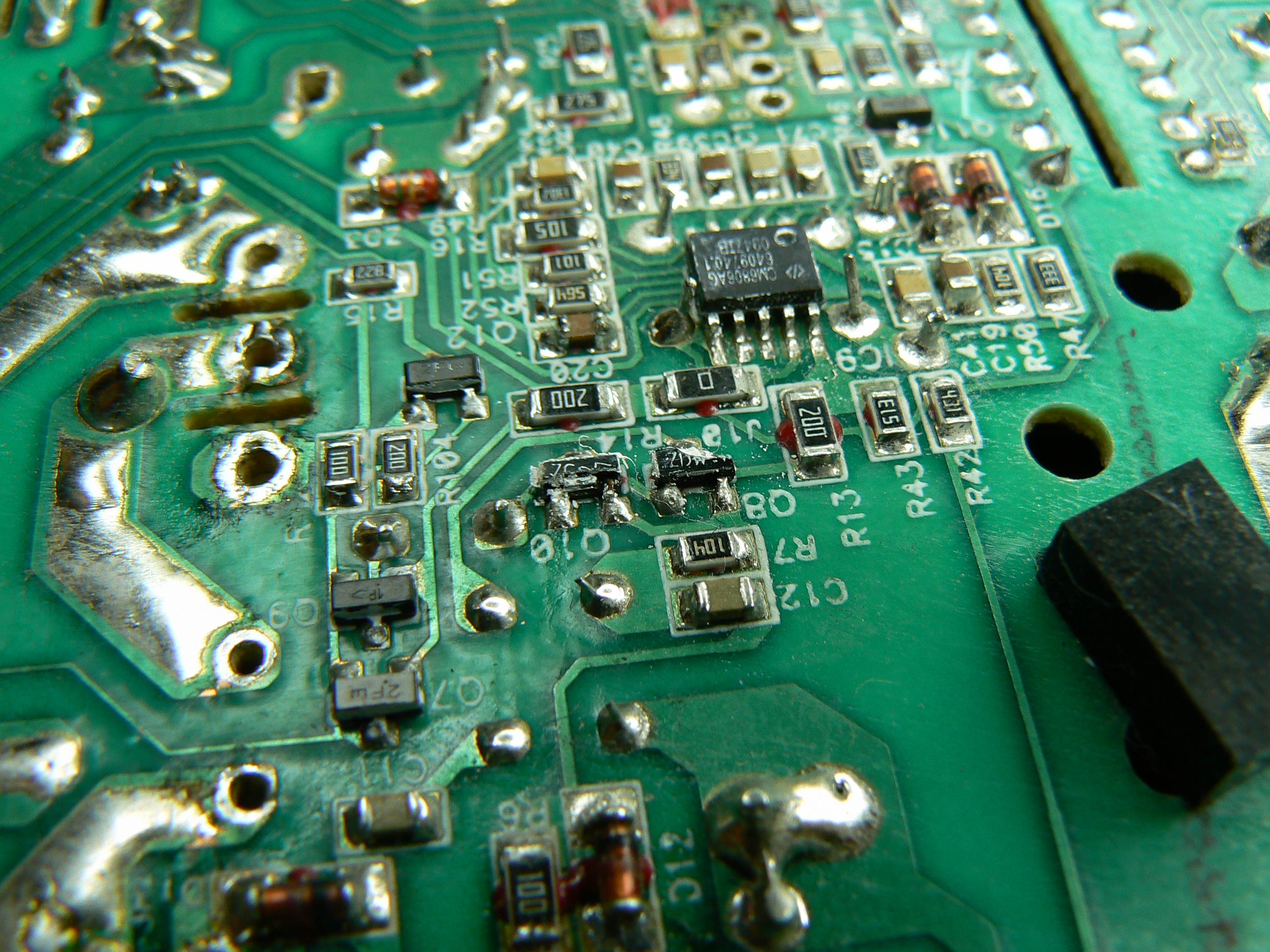

    I am attempting to repair this Ultra X4 supply but I am not sure what my best option is on replacing a couple of surface mount transistors and I am hoping I can get some helpful input from the forum.
    I think I have identified them, but of course I am not 100% certain. One I can easily find a replacement, the other one is not in stock at Digi-Key so I am not sure what part of its' specs are the most important when trying to source a replacement.
    These two transistors are the only ones on this supply with these particular markings and of course they are not complete due to the transistors being blown. Q10, I believe is marked ZC which I think is a MMBT4124. The MMBT4124 is the transistor in stock at Digi-Key. Q8 appears to be marked ZD which I think is a KST4125. Digi-Key does not stock this transistor and it is the one for which I need to find a suitable replacement. I could be completely wrong on both identifications and if anyone has a better idea on what they really are I would appreciate the input.
    These transistors are connected to the CM6068A PWM pin. The CM6068A controls both the APFC and the primary side PWM functions. It appears that these transistors act as the driver between the chip and the main FETS.

    I have decided to replace Q10 with a MMBT3906 and Q8 with a MMBT3904. These transistors have a higher voltage rating than the original which I think is beneficial. How well they will work remains to be seen. I am just hoping I have correctly identified the original transistors in the first place, if not my testing may get very interesting at least for a few seconds. Identifying surface mount components is a real pain in the rear and somewhat of a crap shoot IMO.

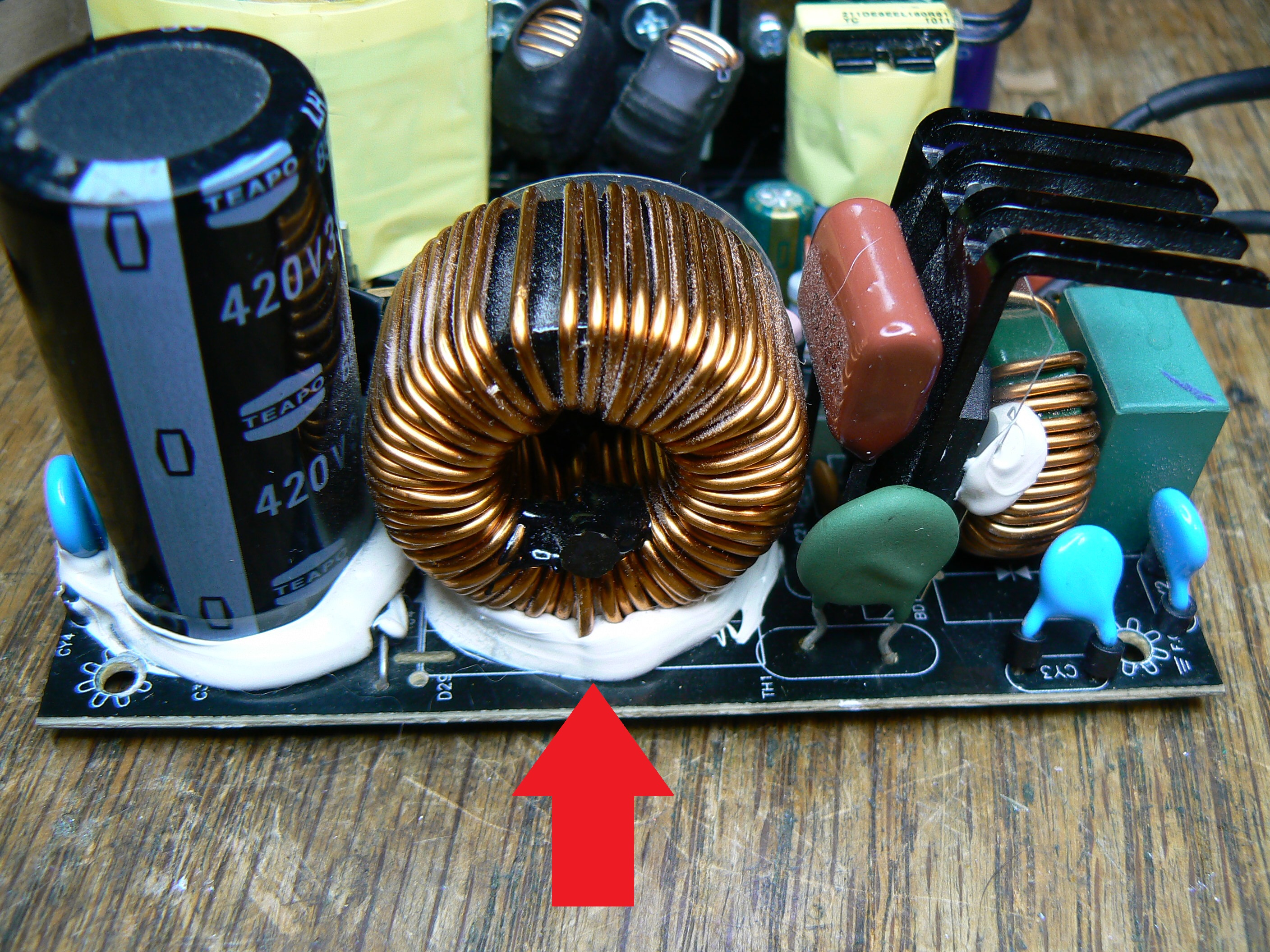

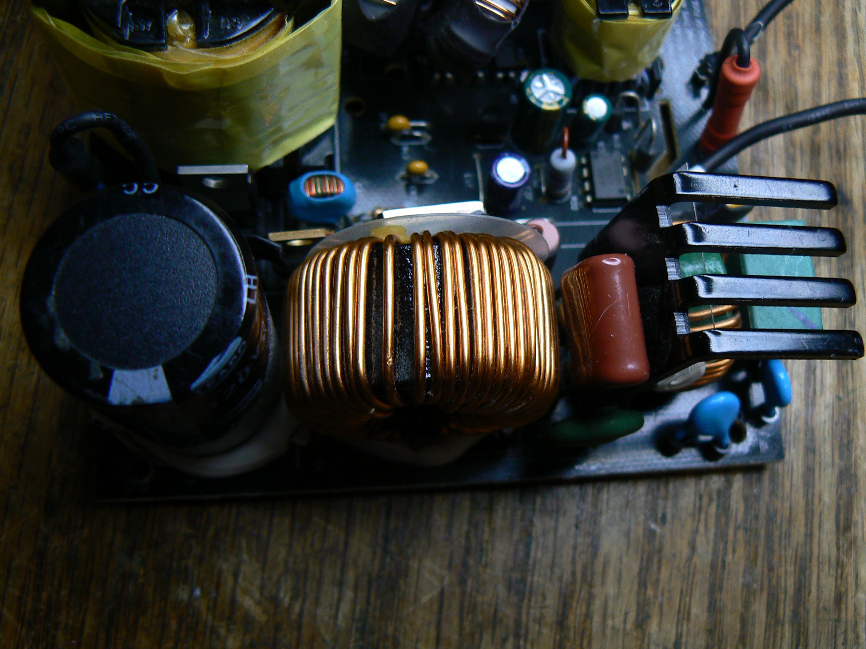

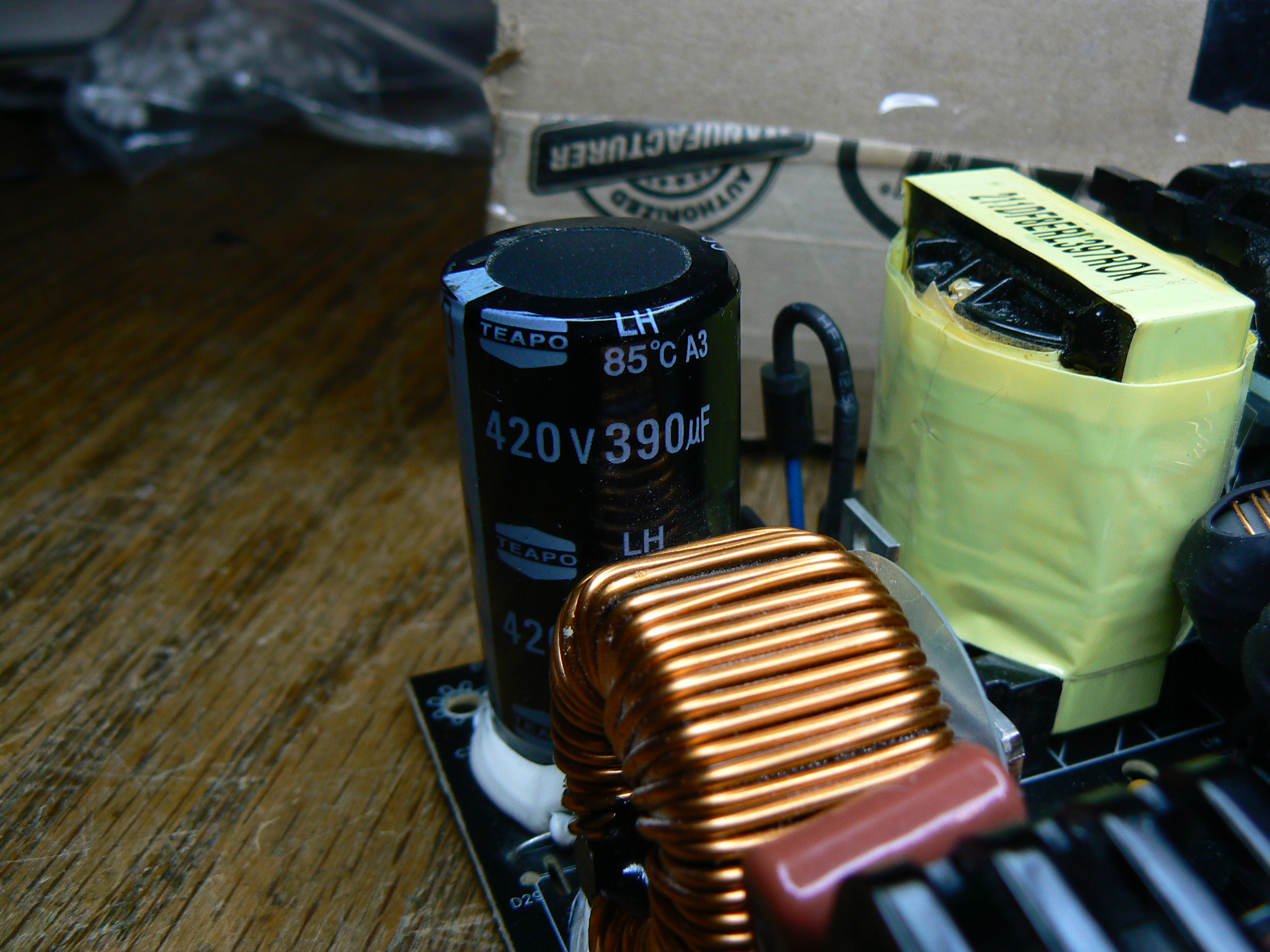

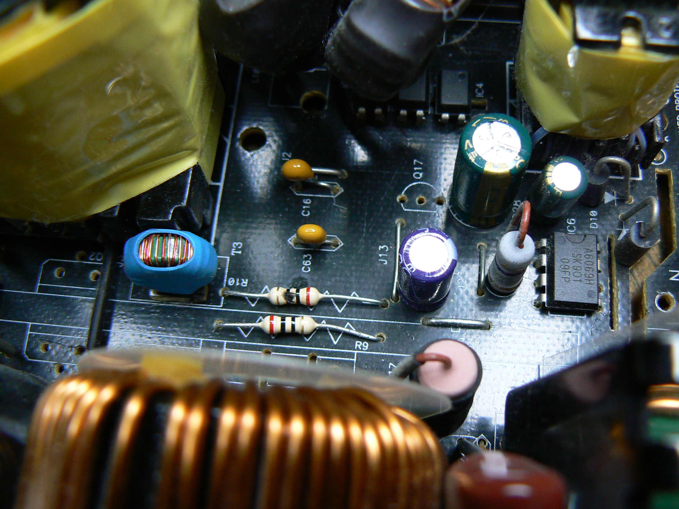

              I was able to take some pictures last night. Just to make sure I am understanding you correctly, when you say booster coil you are talking about the one the arrow is pointing at in the first attached image, correct?
                  Yes, that is the booster coil. Visually, I could not see any difference between a good coil and a shorted coil. Only the ring tester could verify a problem. Also, temperature is a factor. The hotter the coil runs the more likely a short. Use a temperature gun to try to determine operating temperature. If the mfg. uses a cheap core, the coil will run hotter and cause problems with time.

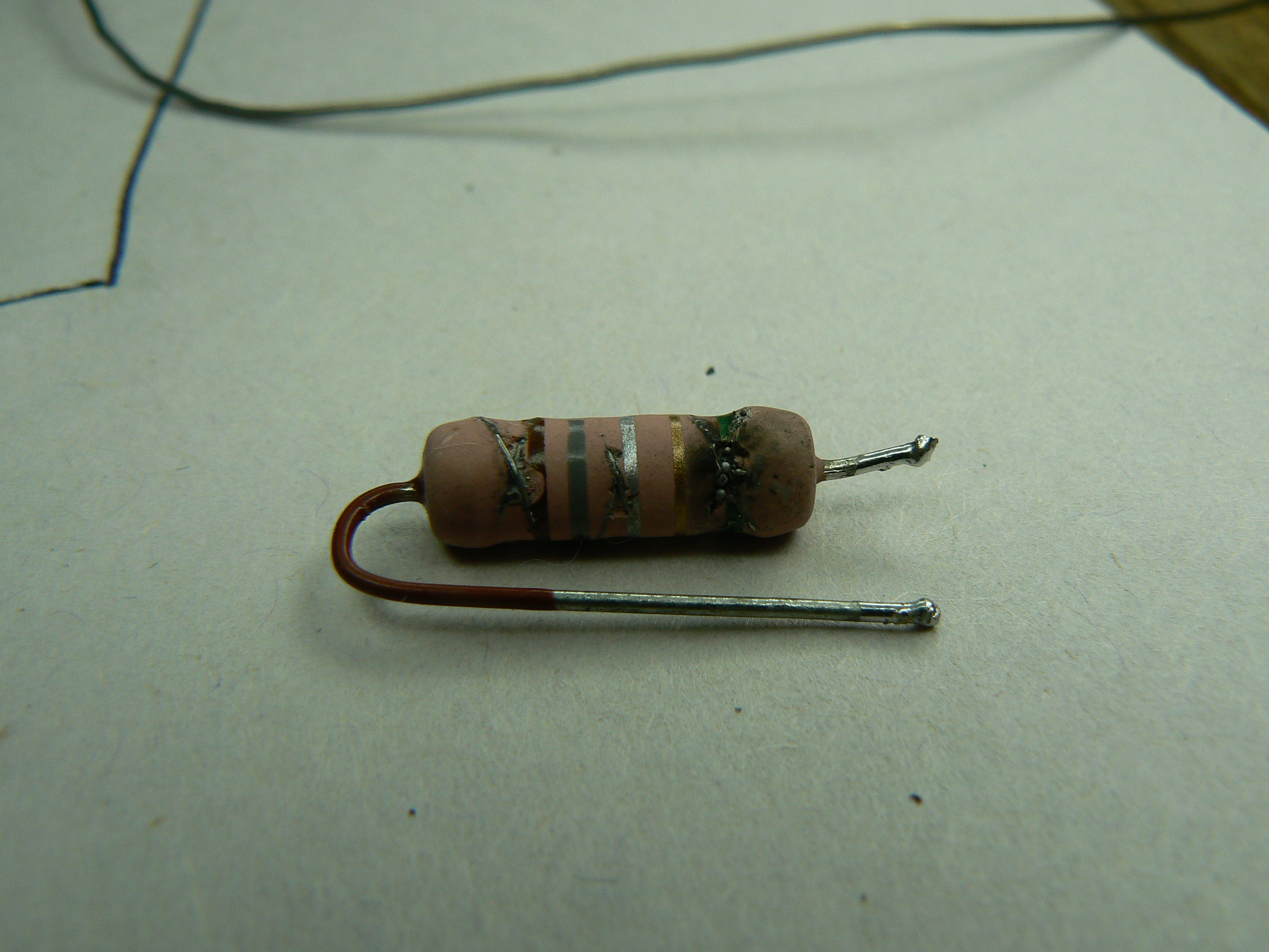

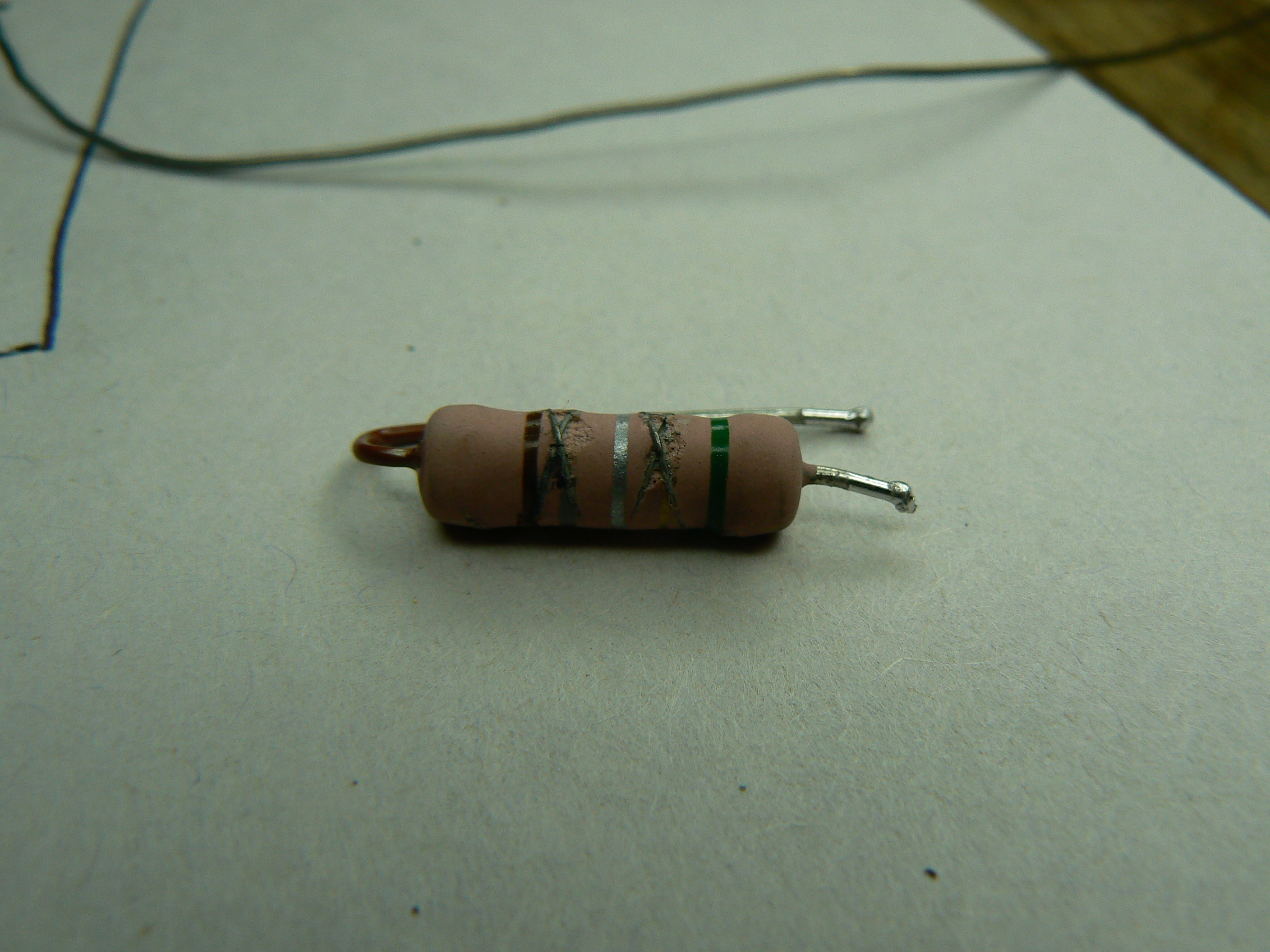

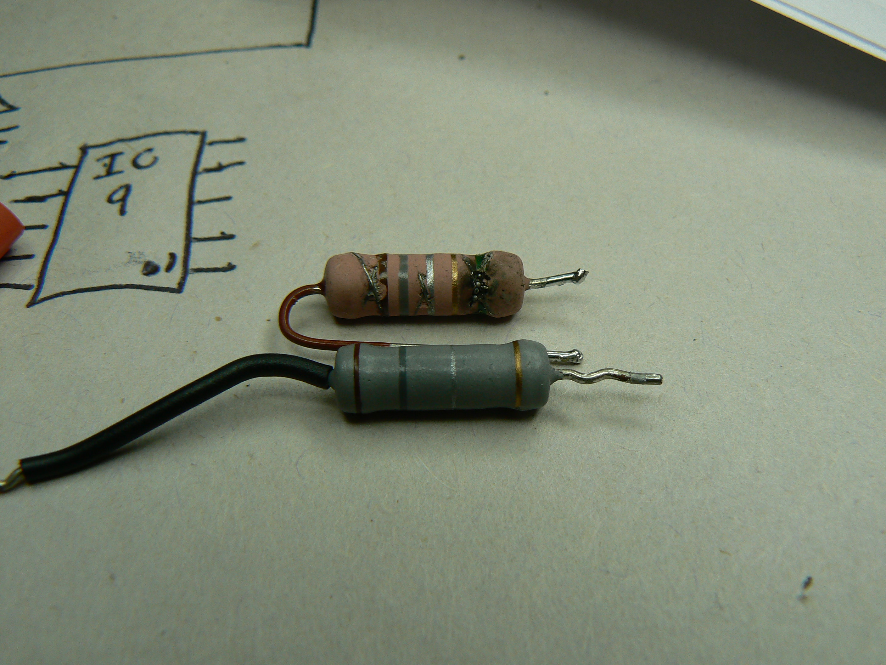

                      I think I may have found the reason this supply is not turning on. The "current sense" resistor between the the FET and common was blown. Normally I do not have a problem determining the value of a resistor if I can make out the color bands but this one is confusing me so I am hoping for some input as to its' value.
                      It looks to me like the the colors are:
                      Green - Gold - Silver - Grey - Brown
                      or
                      Brown - Grey - Silver - Gold - Green
                      Either way these colors in these orders do not make any sense so any input would be appreciated.
                      I have also ordered a Blue Ring Tester, I have wanted one for a while so I went for it.
                        or
                        It's pointing towards a 0.18 ohm +/- 5% resistor (meaning of the 5th band is unknown in this case). That is with the second possible orientation. The first is completely invalid, as the first or second band cannot be silver or gold.
                          This is what I was thinking myself but I was not sure, the green band was throwing me off.
                            I think that green band is either the type of resistor or the manufacturer of the resistor. Some of those low ohm resistors are flame resistant and others are not.
                              It would have been much better if they had marked it in a different way.
                              I found a replacement for the burnt resistor, but the supply still did not turn on. I then discovered that R42 was open. I replaced R42 with another 430 ohm resistor but still no luck. It looks like more probing and troubleshooting are in my future with this supply.

                                My ring tester shows that the booster coil is good.

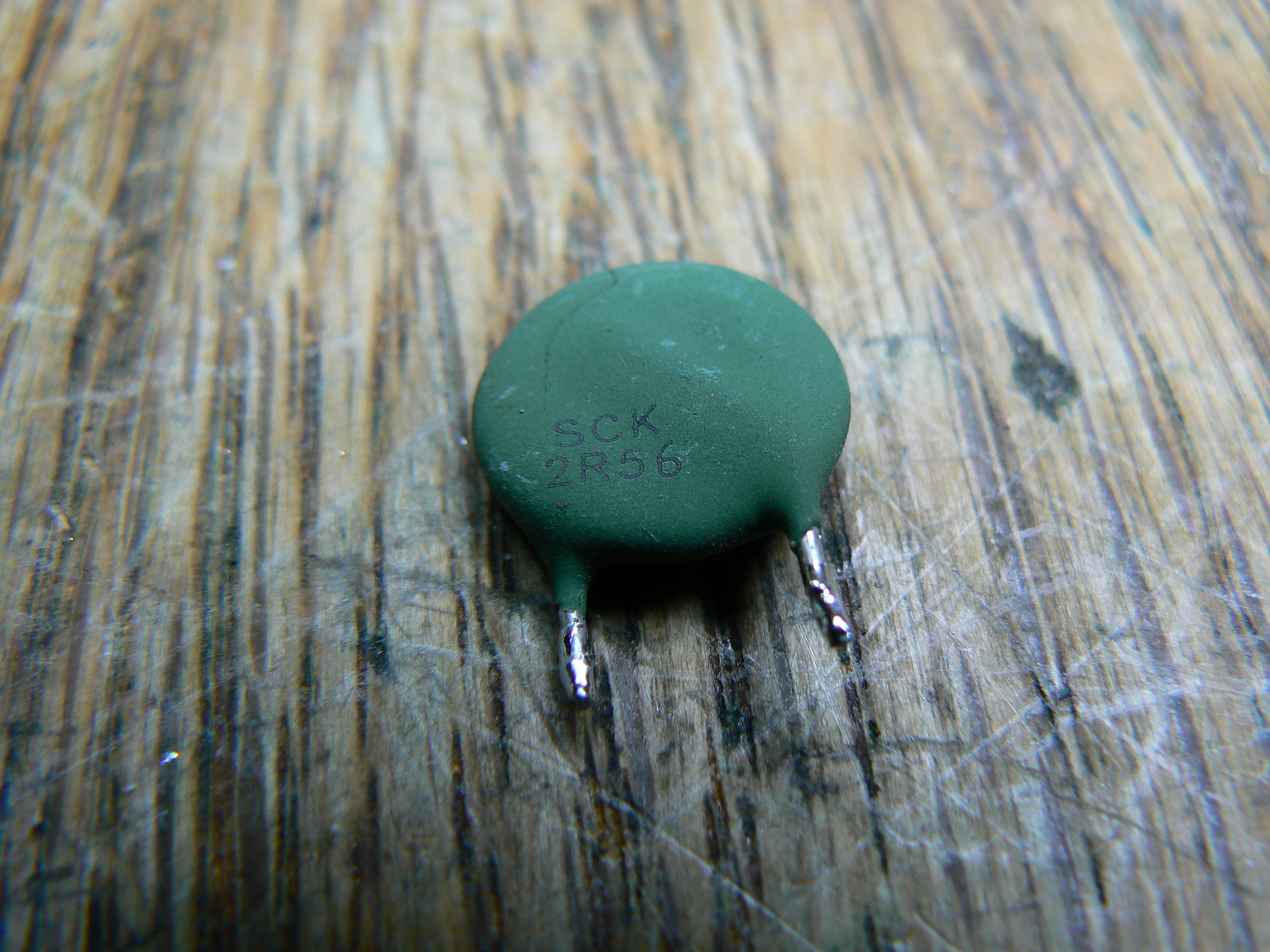

                                        I have made some good progress with this supply but I am going to make several small posts about it instead of one big one.
                                        I wanted to start by asking for help in identifying the rating for the part in the attached picture.
                                        I am reading it as 2.5 ohm 6 Amp however that does not seem like it would be correct for this supply. The main fuse was rated at 15 Amps and the APFC diode is rated for 16 Amps so why would this only be rated for 6 Amps if that is in fact the rating? Any useful input on this would be much appreciated.
