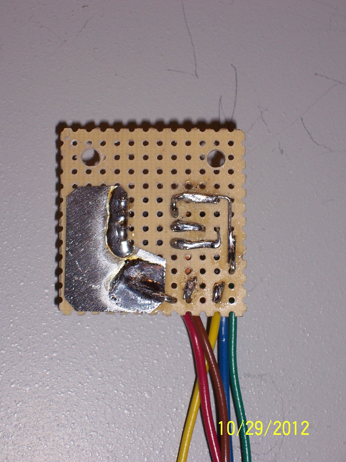

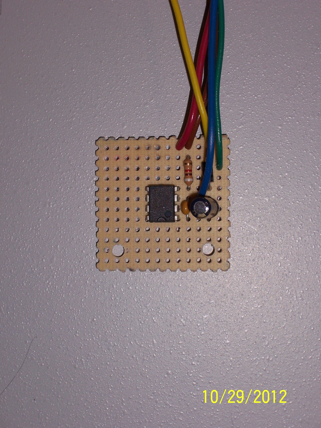

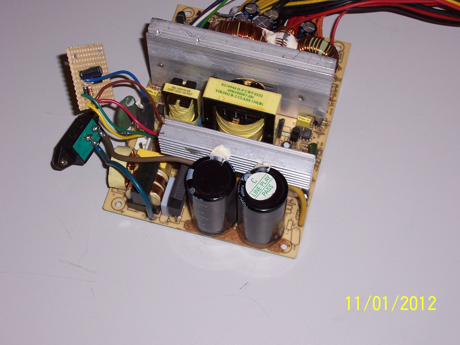

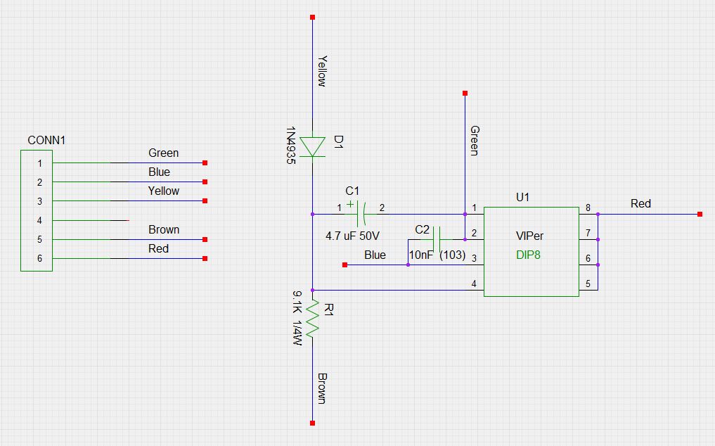

    Re: Antec Smart Power SL-400 5vsb mod using VIPer 22A
    First step, build the add on mod board using commonly available perf board. Radio Shack sells this in 4 inch by 6 inch sheets. The schematic is shown using different colored wires to make assembly much easier. Pictures show top side of the board and bottom side of the board. There are only 5 parts used, a VIPer 22A chip, a 9.1K quarter watt resistor, a 1N4935 (or equavilent) high speed switching diode, a 4.7 uF/50 volt electrolytic capacitor, and a 10 nF film capacitor (usually marked 103).

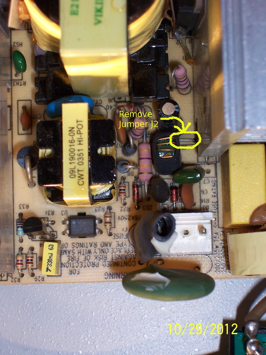

      Next step is to remove jumper J2. One side of this jumper goes to the collector of the 5vsb switching transistor. The other side of the jumper will be used for attaching the red wire which goes to the drain of the VIPer 22A pwm chip. Removing the J2 jumper removes the switching transistor from the new circuit so that you don't have to unsolder it and remove it from the heat sink.

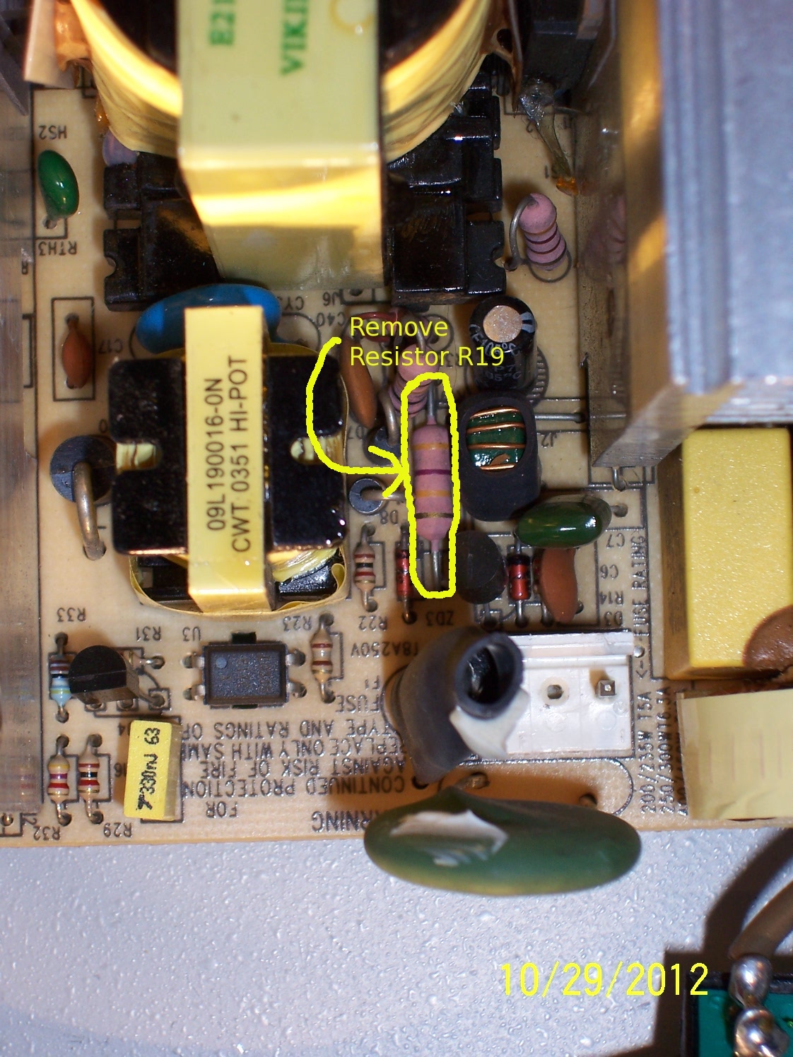

        Next remove Resistor R19. This is the startup resistor which provides the startup voltage to the two transistor circuit. Removing this resistor assures that no accidental startup problems occur.
        Old proverb say.........If you shoot at nothing, you will hit nothing (George Henry 10-14-11)

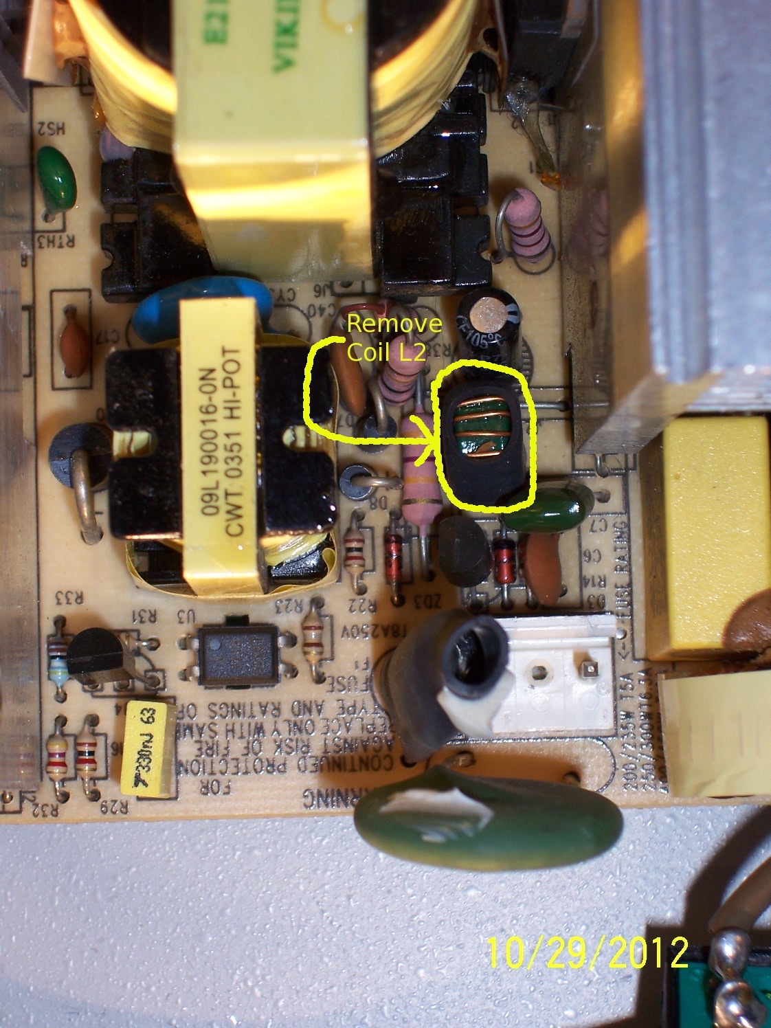

          Next remove Coil L2. One side of this coil location will be used to provide the Vdd power to the VIPer 22A chip. The yellow wire will be be attached here a few steps from now.

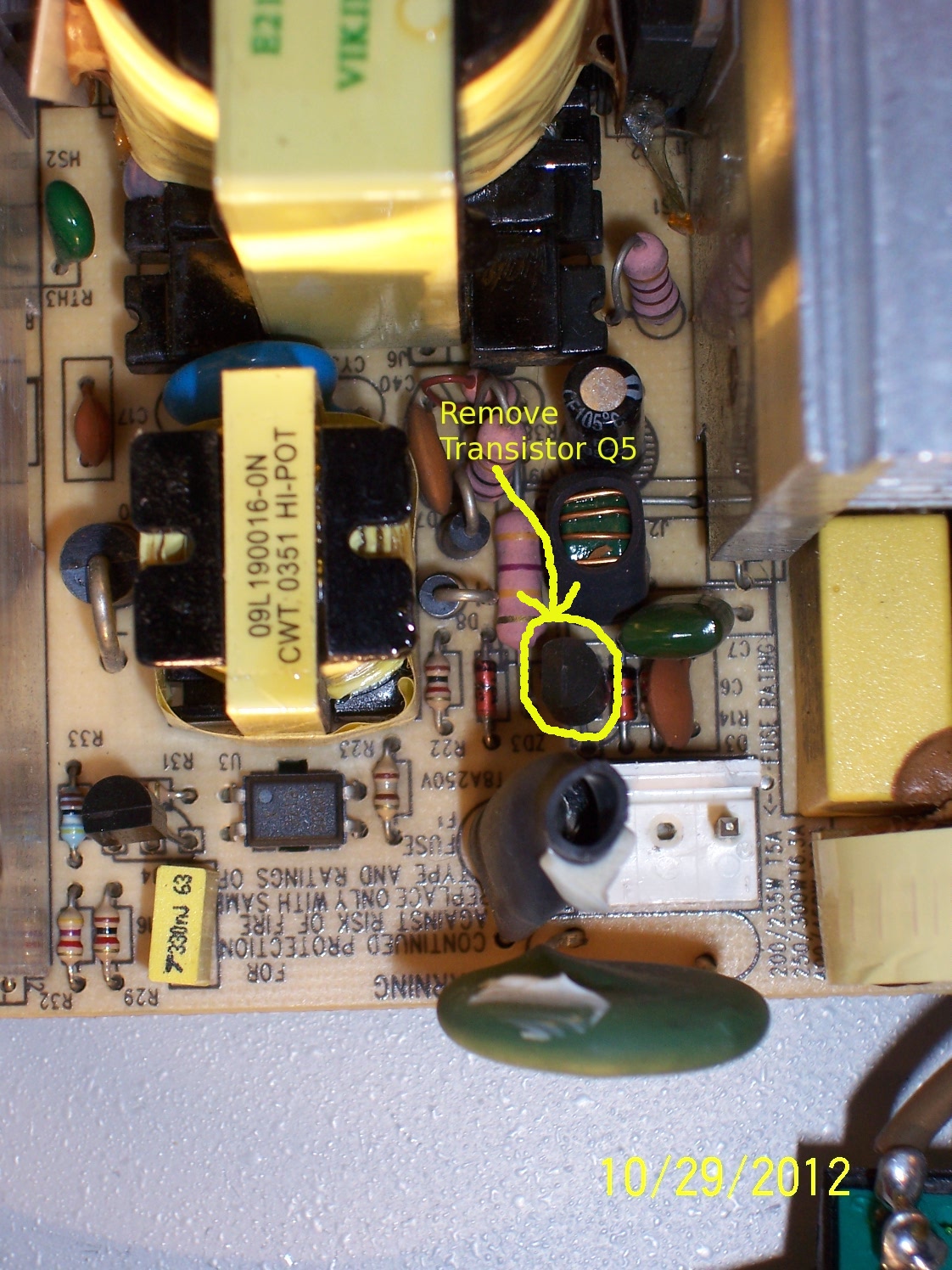

            Now remove transistor Q5. The emitter of Q5 is grounded, so this ground location will be used to attach the green ground wire to the VIPer 22A mod board.

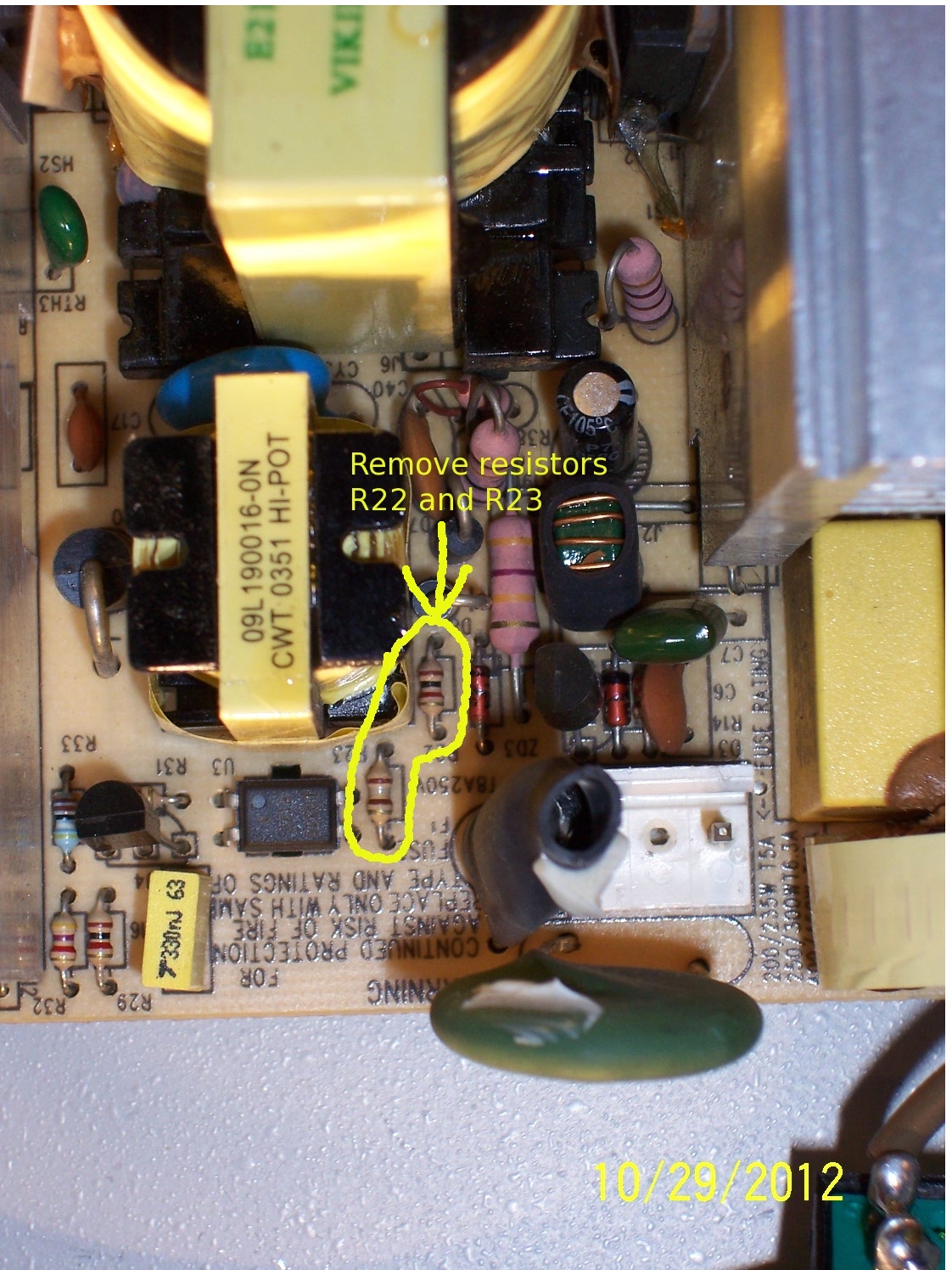

              Next remove Resistors R22 and R23. This will remove the optocoupler from the old two transistor circuit and give you the holes for attaching the blue and brown wires to the VIPer 22A mod board.

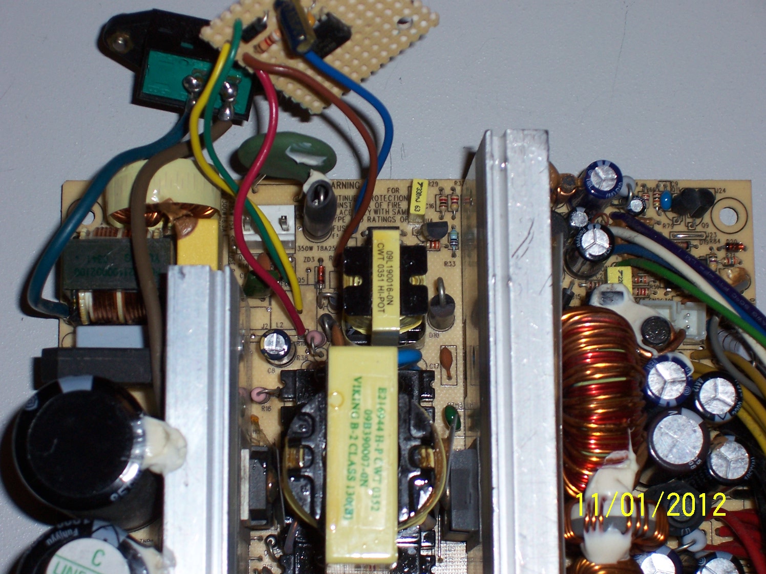

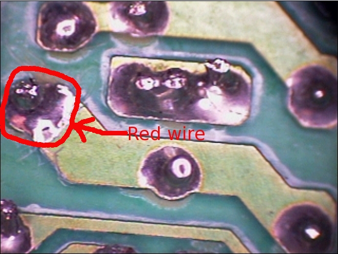

                Now it is time to work on the bottom of the power supply pc board. Attach the red wire to the hole formerly occupied by jumper J2 and as shown in the picture.

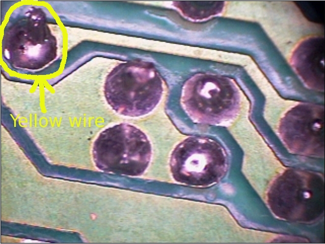

                  Next attach the yellow wire using one of the holes formerly occupied by coil L2 as shown in the picture.

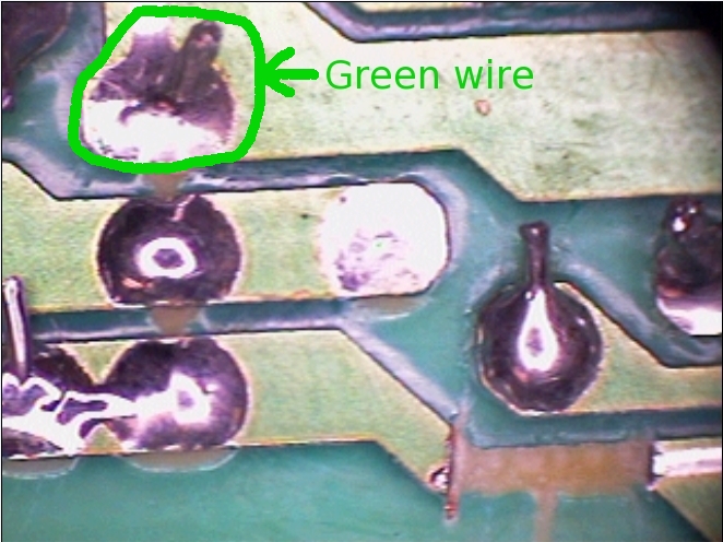

                    Next attach the green (ground) wire to the hole used by transistor Q5 emitter as shown in picture.

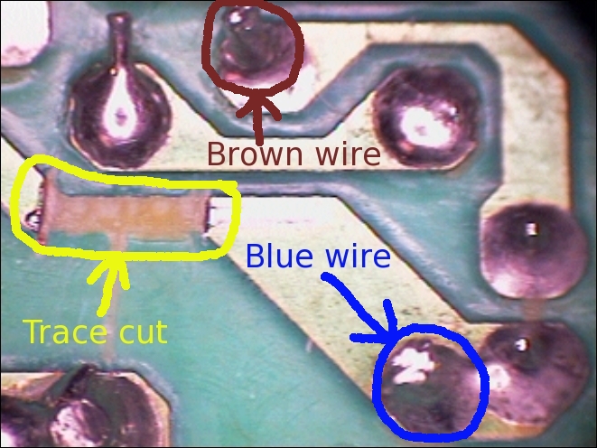

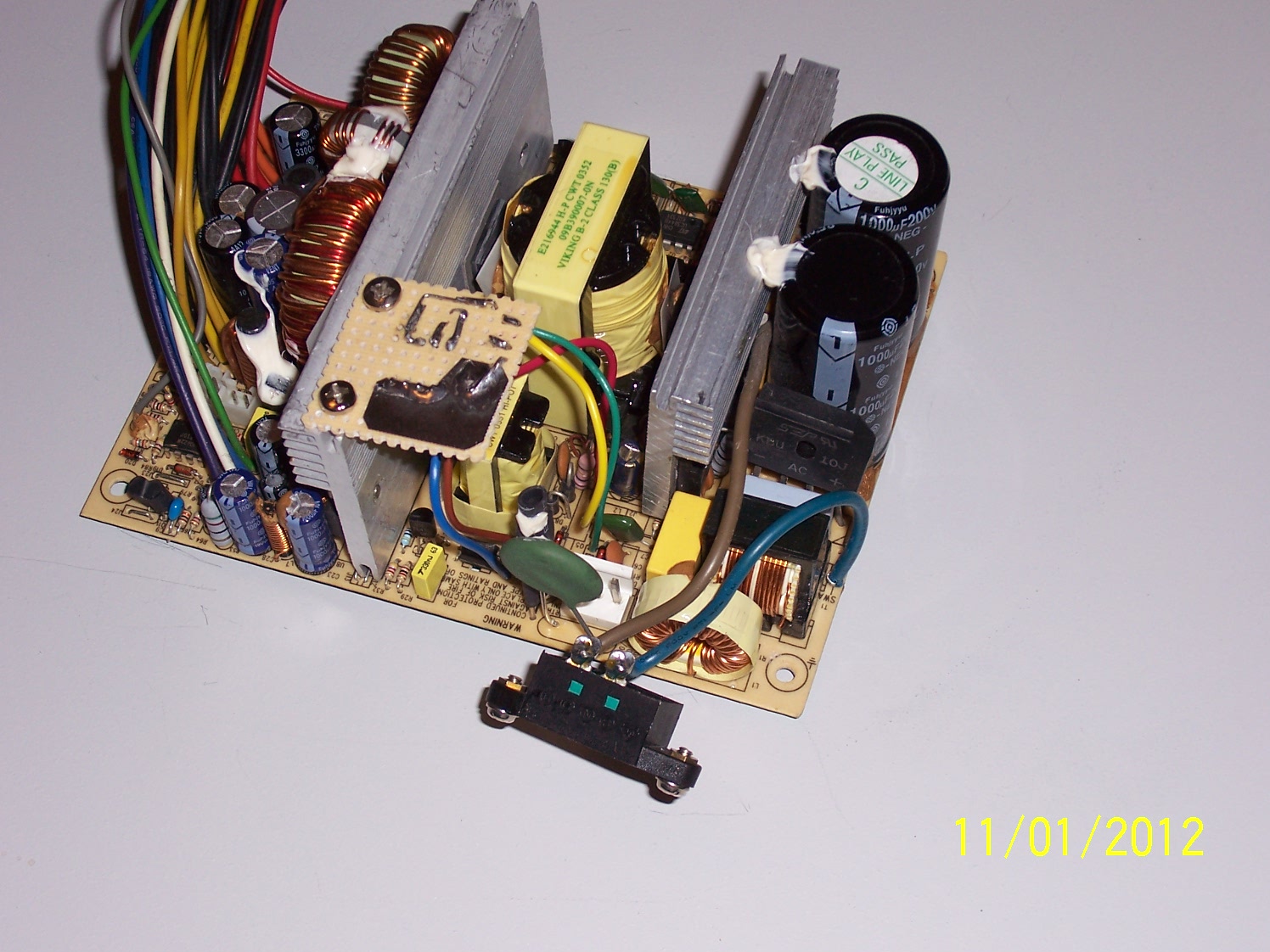

                      Finally, attach the brown and blue wires in holes formerly occupied by Resistors R22 And R23 as shown in picture. Also, you will need to make one circuit trace cut as shown in the picture. This will prevent voltages from going back into the two transistor circuit.
                        Check your work carefully to be sure you have no solder bridges. A small brush and alcohol can be used to clean the area you have been working on. Pictures show the 5 wires going from the VIPer 22A mod board to the main pc board and how I mounted the mod board to one of the heat sinks. You are now ready for smoke test!

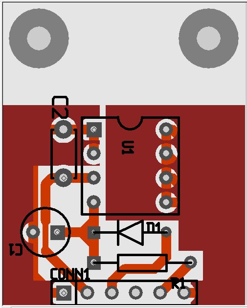

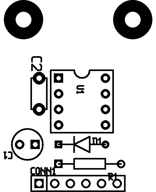

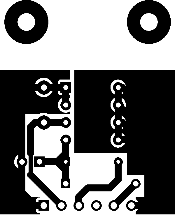

                            This is my interpretation of Everell's design. I have not etched it yet but I hope to do so before the end of the week.
                              You're gonna etch it with the laser printer/acid/copper method?
                                Yes, that is the method I normally use.
                                  Would you be open to selling me an SMD version? I just bought bulk stock of pick and place excess for pennies on the dollar, I don't know yet what size they are, but I'm betting I can put them to good use in this project.

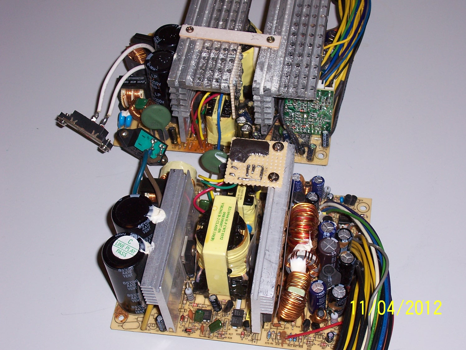

                                    Here is a picture of the Antec SL-400 (front) and SP-350 (back). This shows the difference in the pc boards of the Smart Power SL series and the SP series. Both are sporting the VIPer 22A 5vsb modification. Now if we can get c_hegge to add a short instruction on how to modify the fans to operate correctly................
                                      Ok, so I should look at the SP350 mod thread...
                                        What would be the result of using a 10k resistor instead of the 9.1K? I already have 10k but I would have to order 9.1K. No major deal, just not convenient.
