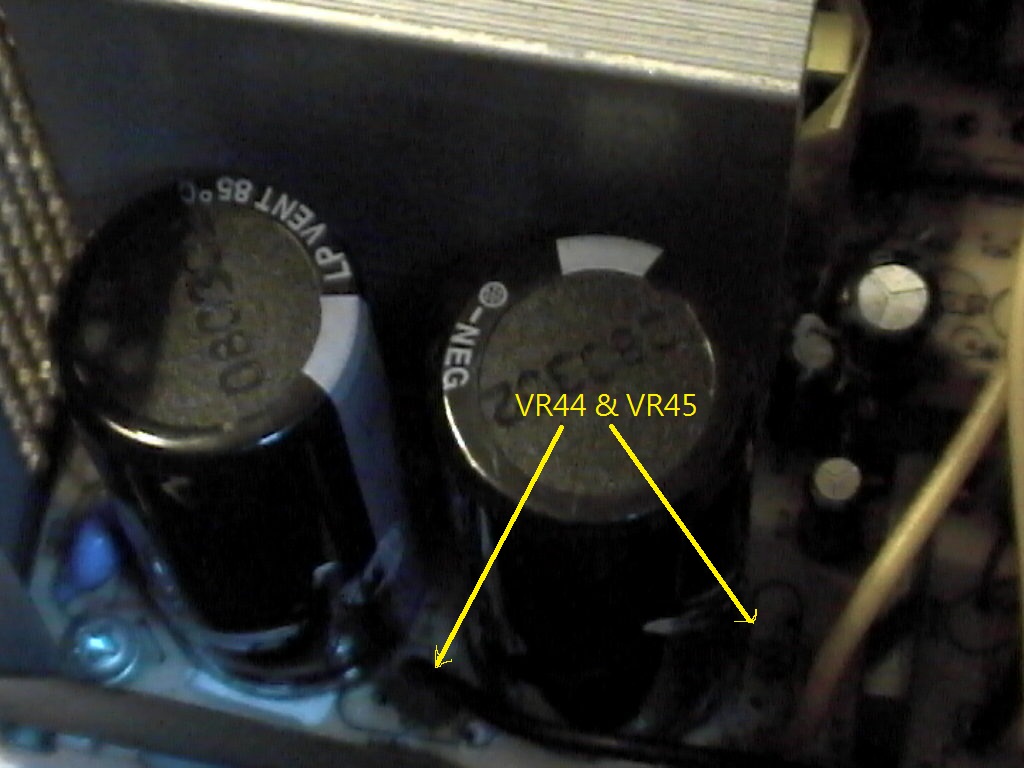

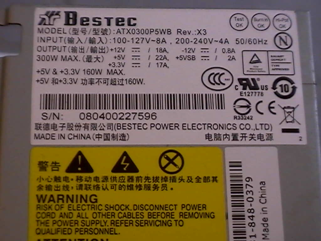

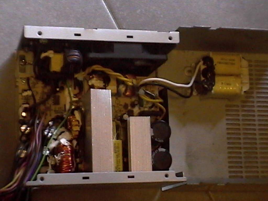

    Dear guys,
    I has a Bestec ATX300P5WB as follow, which stop working,
    Thanks to "everell" who provides its similar 5Vsb circuit to me, I found that TNY276 of 5Vsb circuit may be defective. I will buy one in the near future.

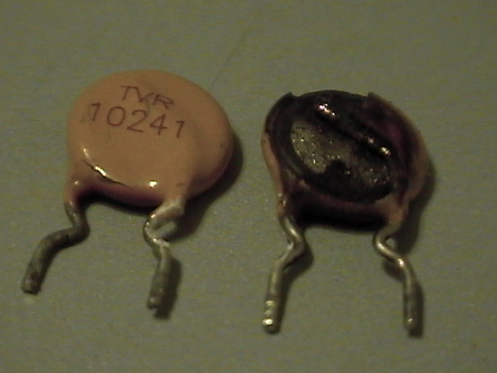

    Meanwhile, I found 2 varistors (TVR10241) as follows also burn out,
    I want to buy them with TNY276 on next time I visit the shop. But I am wondering why it use a 240V varistor. Can I buy two 180~200V varistor to replace them? Any part no provide?
    Any suggestion is very welcome !!!

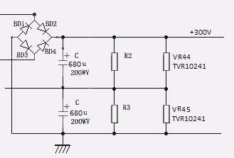

      But the design of Bestec is quite different. It use two varistors, each across one of the primairy caps. Therefore, it is equivalent to two varistors in series across the mains. So I think I should use two varistors with 1xx V to replace them. Any suggestion?
      • Behemot
        • 4845
        • CZ
        Re: Question about Varistor
        You haven't stepped up for the standard 230 V?
        Ah, I see. In full filtration circuit, there should definitelly be also one varistor before the rectification cascade to supress the spike before it can even hit primary caps. Anyway, there is as much as 311 V after rectification and if you have 230 as well, than 325 V. So I think 160V, or maybe safer 170V varistors would be good.

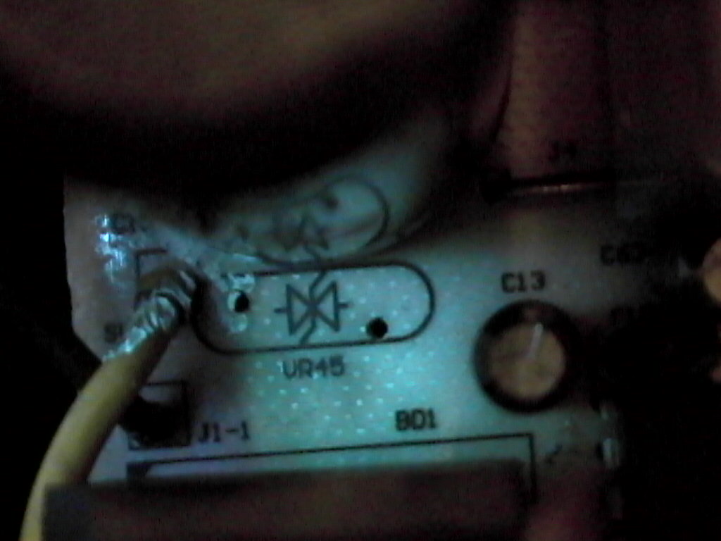

                I had double checked it, but I found no varistor before the rectification cascade.
                I think with this design it will suit for both 230V and 110V mains. The PSU has a switch to select the mains between 110V or 230V. I was always wondering how a 230V protective Varistor to protect the PSU which use in 110V mains.
                Of course, this design cannot protect the bridge rectifier.
                Yes, the rectified primiary voltage of the PSU is about 330V.

                    Just remember, 170 V DC (thats 130 V AC/RMS). If you'll buy 175 V AC, thats for 225 V DC and they start conduct at arround 270 V. (datasheet for mine varistors)
                    As for the switch, well, for 115 V it uses boost circuit so there is 325 V anyway on the input side. For that reason when there are these two varistor accross the input caps, they will protect them even on 115 V mains. And usually as there are very short spikes (ms wise), they don't care about the bridge rectifiers as they (usually) use 600 V ones even in el-cheapo PSU's (in higher-quality PSU's you can find even 800V or 1000V) which are able to sustain few kilovolts for fractions of second.

                      But I wondering why Bestec used 2 x 240 Vac varistor in series, which is equivalent to 480 Vac varistor, I think. Is it a bad design?
                      • Behemot
                        • 4845
                        • CZ
                        They survive for longer time, most manufacturers do that. You are correct, over some specified voltage the varistor becomes more and more open and conducts the spike to ground. And yes, it damages itself, it has both limited maximum power it can handle, and also some number of "conducts" it can do.
                        Very much like thermistor…the less you use them, the longer they survive. That is one of the reasons why NOT to turn off and on PSU completelly every day. (second reason is you have to buy CR2032 battery every year )

                            Also if the one varistor of yours is nearly open, I suggest changing it. With low resistance under normal circuimstances, current will flow through it to ground and it can go soon
                            • hkqq2010
                              • Sep 2012
                              • 39
                              • CHINA
                              You're welcome
                              Yes, I intend to replace all of them.
