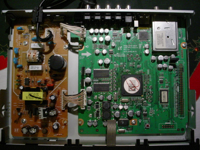

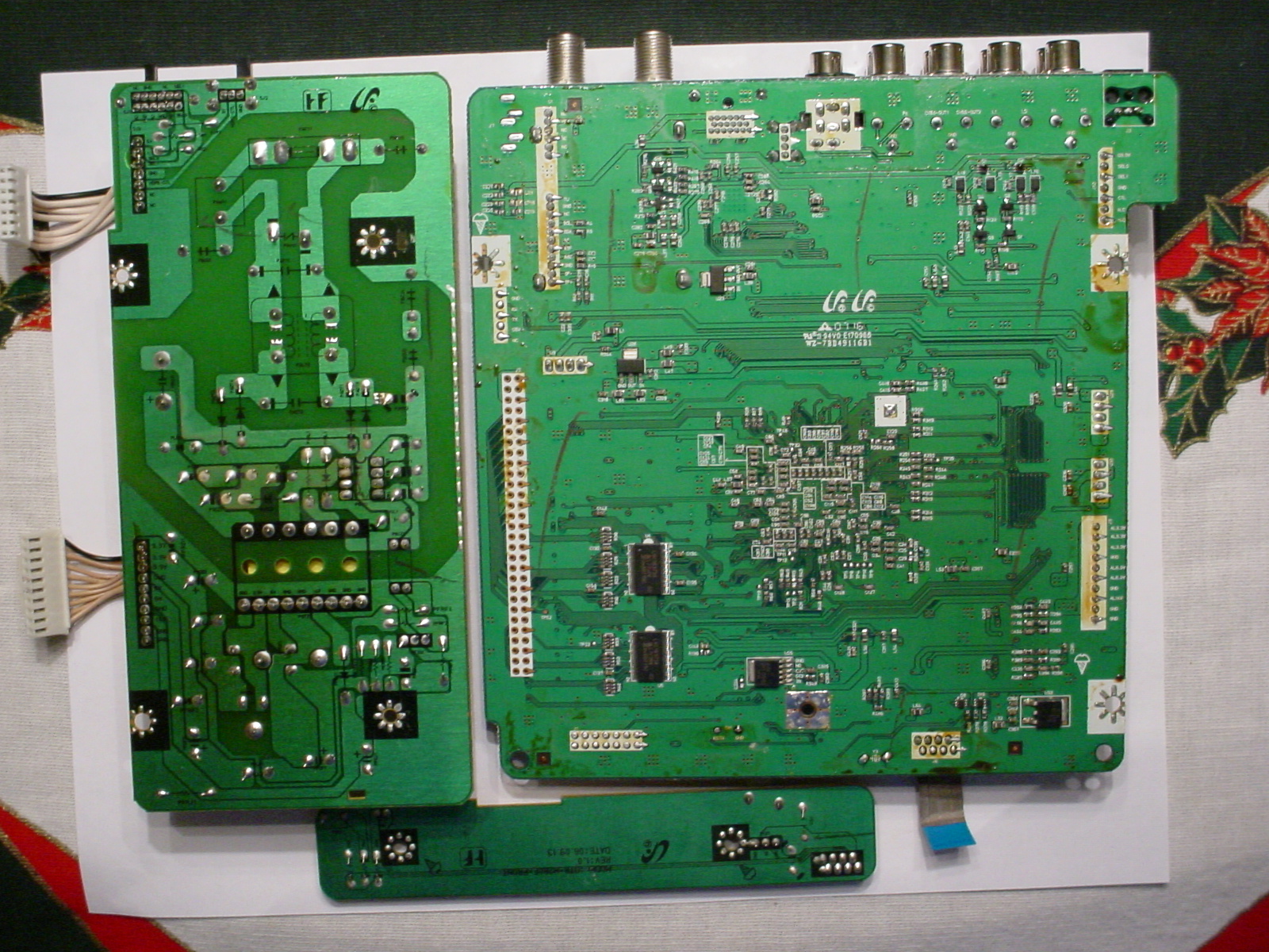

    This is a stand alone antenna HD signal receiver. I use it with a Mitsubish HD ready TV that does not have it's own receiver. Whithout warning, it powered off and will not do anything. It has a fuse inside the case, but it's good and has power going thru the fuse. There are two boards inside, I see nothing that looks wrong anywhere. I'm verrrry new at this, but would like to repair this thing, I need it. Any help on where to start?

    Please take photos of the boards, in good light, preferably without flash to avoid glare.
    You can attach them using the 'manage attachments' button when you reply using the advanced editor.

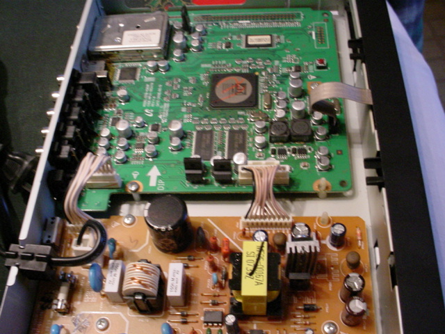

          Had a little trouble attaching files. I hope you can tell something from these.

                  If you look at the bottom wiring harness that connects the power supply to the logic board, you should see the voltages silk screened on the circuit board. Also, maybe on the top wiring harness too. Hard to tell from your photos.

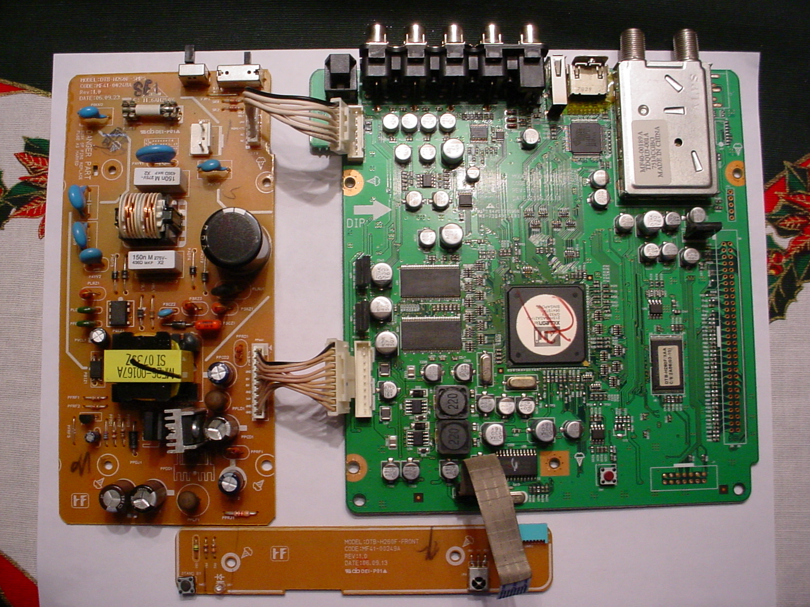

                            In order for members to help you, we have to see what you're seeing. Personally, I can't make out any components that would help me suggest what to test next. Please post some clear closeup photos of both boards (top and bottom) per the link below:

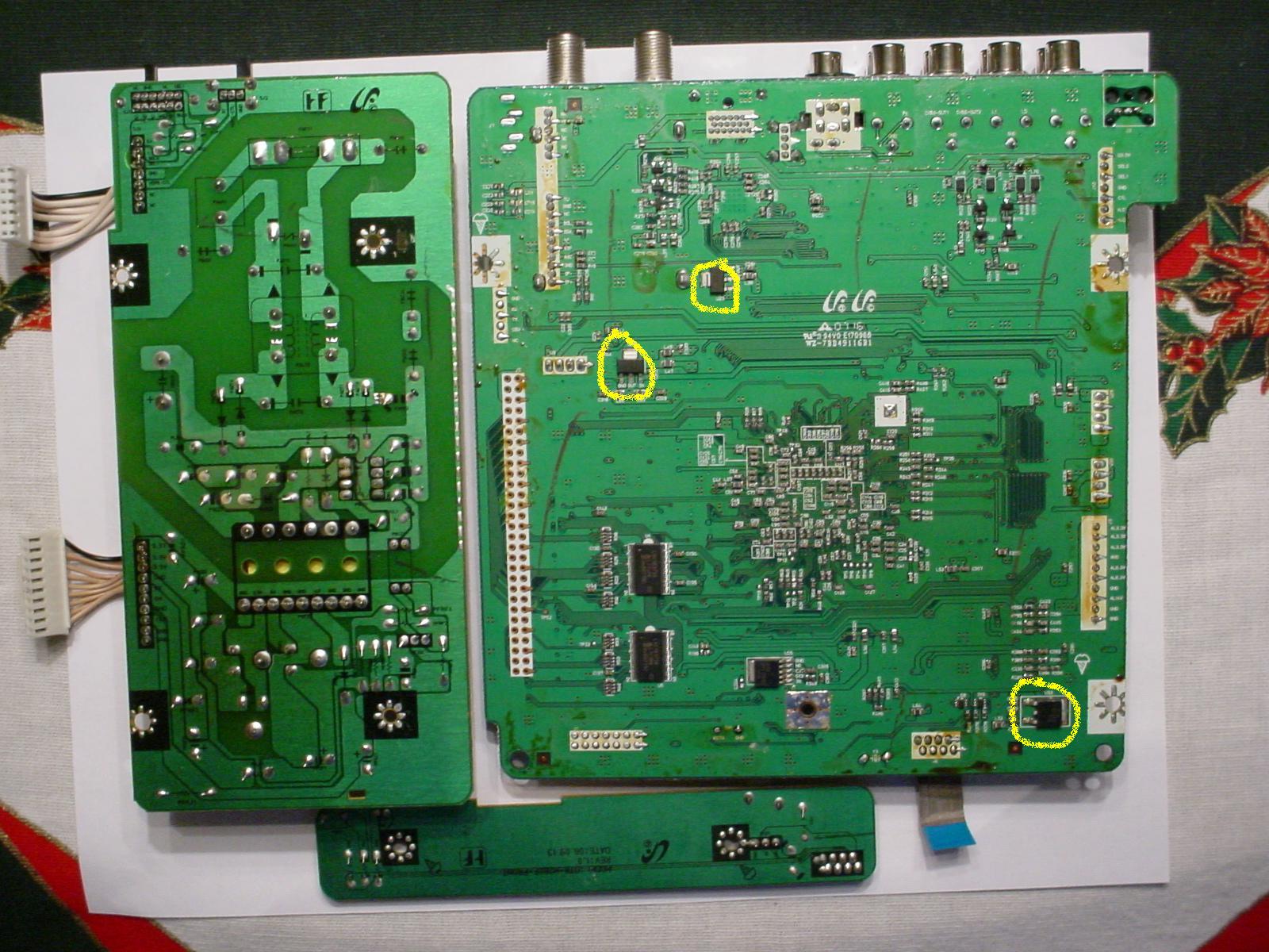

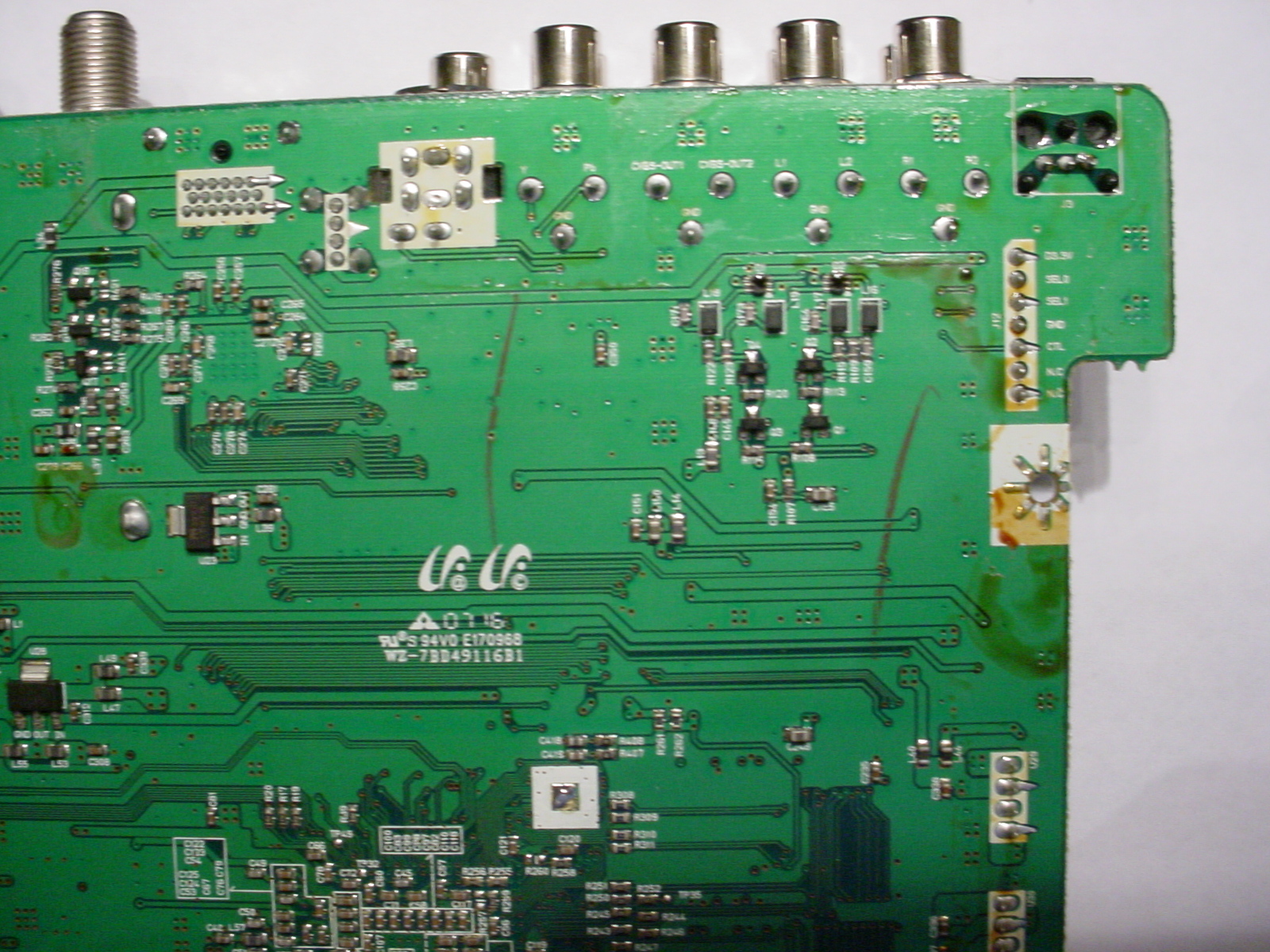

                                I hope these are better.
                                Thanks for your time & help.

                                    You could have the same problem as the others in that thread - does the blue light (I assume power light) come on like theirs?
                                    But your capacitors aren't bulging - then again, they can fail without doing that. Although it looks as if 2 of yours are kinda indented? Weird...

                                      The bulging caps you mention, are those the brown ones? I can get a better close up of those for ya.

                                        Looks like the link describes power supplies that won't start up. Since you're getting 3 output voltages, it looks like the power supply is working, but the logic board is not getting power.
                                        1) Check under the logic board for surface mount fuses. They are generally marked FX (where "X" is a number).
                                        2) What are the part numbers of the devices I circled?
