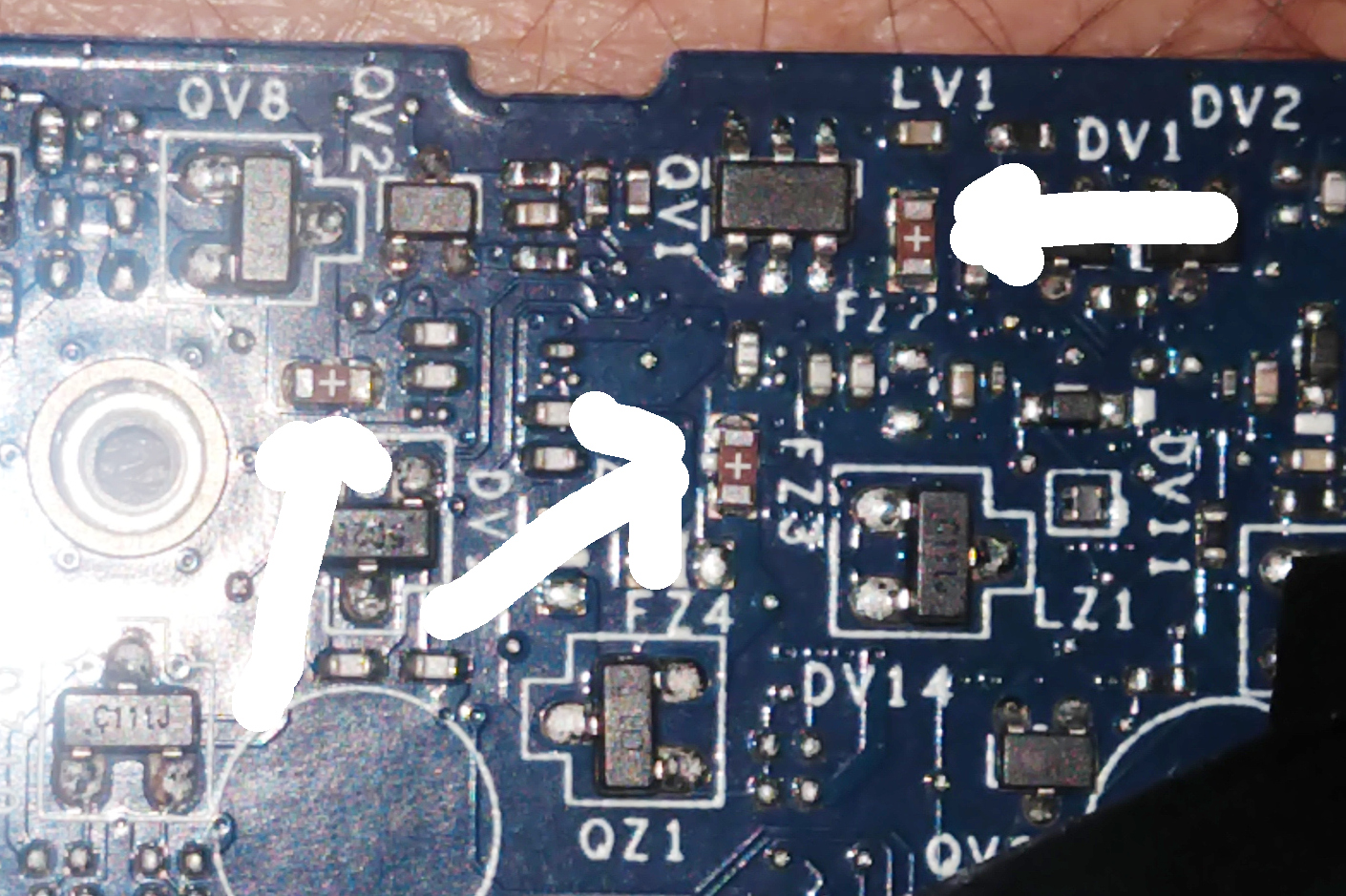

    Need to know the specification of the screen connector fuses - there are 3 with a little plus on them that I have not seen before

    Post a pic of your LCD screen connector on the logic board.
    A fuse does not have a polarity so the '+' marked devices are most likely polarized (tantalum or similar) capacitors.

        Re: Anyone with schematic for Dell Latitude 5400 LA-G891P / LA-G892P ?
        They are fuses - unusual to find fuses like this with a simple plus sign on the back
        (eg FZ3 is 1A_65V_T0603FF1000TM)
        (Markings explained on the attached AEM pdf - the plus on these fuses indicates a rating of 1A)
