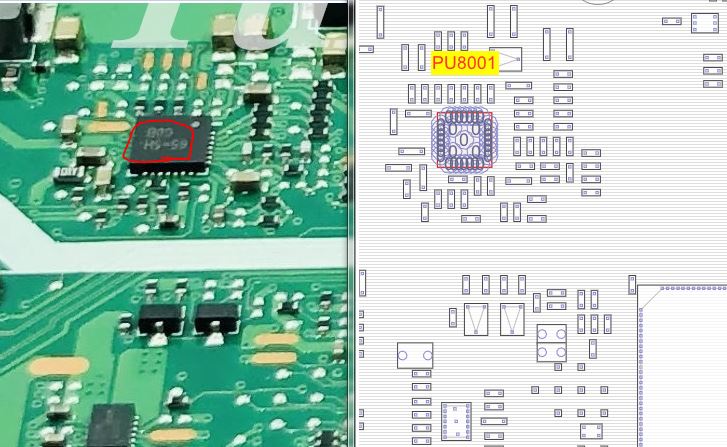

    Hi all, I am working on ASUS model TP401M (MotherBoard Part # TP401MAR R2.0). The motherboard is totally dead. I am getting the 19 volts on the motherboard but am not getting the 3.3v & 5V. All chip on the board have customized numbers. Does anyone know what are the real IDs of these chips. 1. 65=7E B1R (28 pins, two of these present on the MB) 2. 2N=7E KBX (20-pin). Requesting if someone can share the Schematic or boardview for this model, I would appreciate. Thanks in advance.

    Parts with an = will almost certainly be Richtek parts - https://www.badcaps.net/forum/showthread.php?t=90619

        2N= RT8249CGQW https://cdn.badcaps-static.com/pdfs/...d7b1efab2b.pdf
        65= ATK1602AGQW ,no datasheet.There`s 2 of those in the X507MA boardview - https://www.badcaps.net/forum/showthread.php?t=94822 .No TP401MAR boardview available yet afaik .

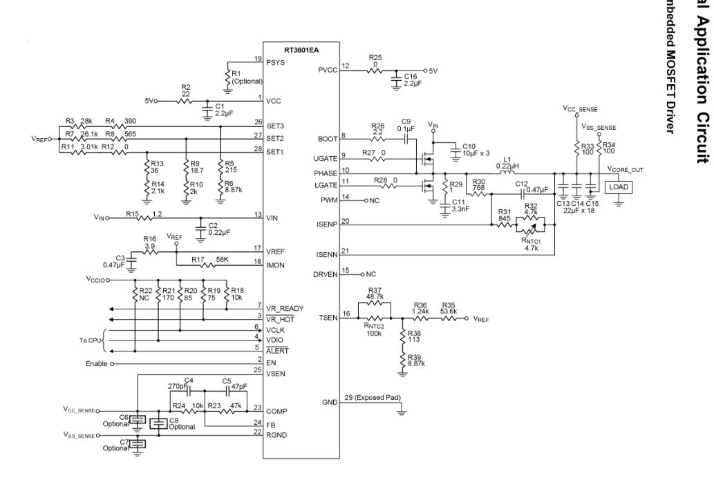

        I think the RT3601EA (Marking 3H= ) is the equivalent Richtek part number,there`s 2 different Typical Application Layout Circuits in the datasheet ,using embedded mosfet drivers (X507MA) ,or using external mosfets .Check the pins to make sure which layout yours has.

          You are so very right "SMDFlea" about this board using embedded mosfets, the TP401MAR also has two MOSFET, but one show 0 ohm, remove it but still zero ohms, No idea why is this. There is a current resistor 1ohms next to it, removed it but the reading still show 0 ohms., I injected 1.2 volts to find any short but nothing is getting hot. At least you have given me the reference of X507MA Boardview. I will surely look into it today. Thank you very much for your help.

              Boardview

                @AL._.EX thank you very much for the Boardview...
