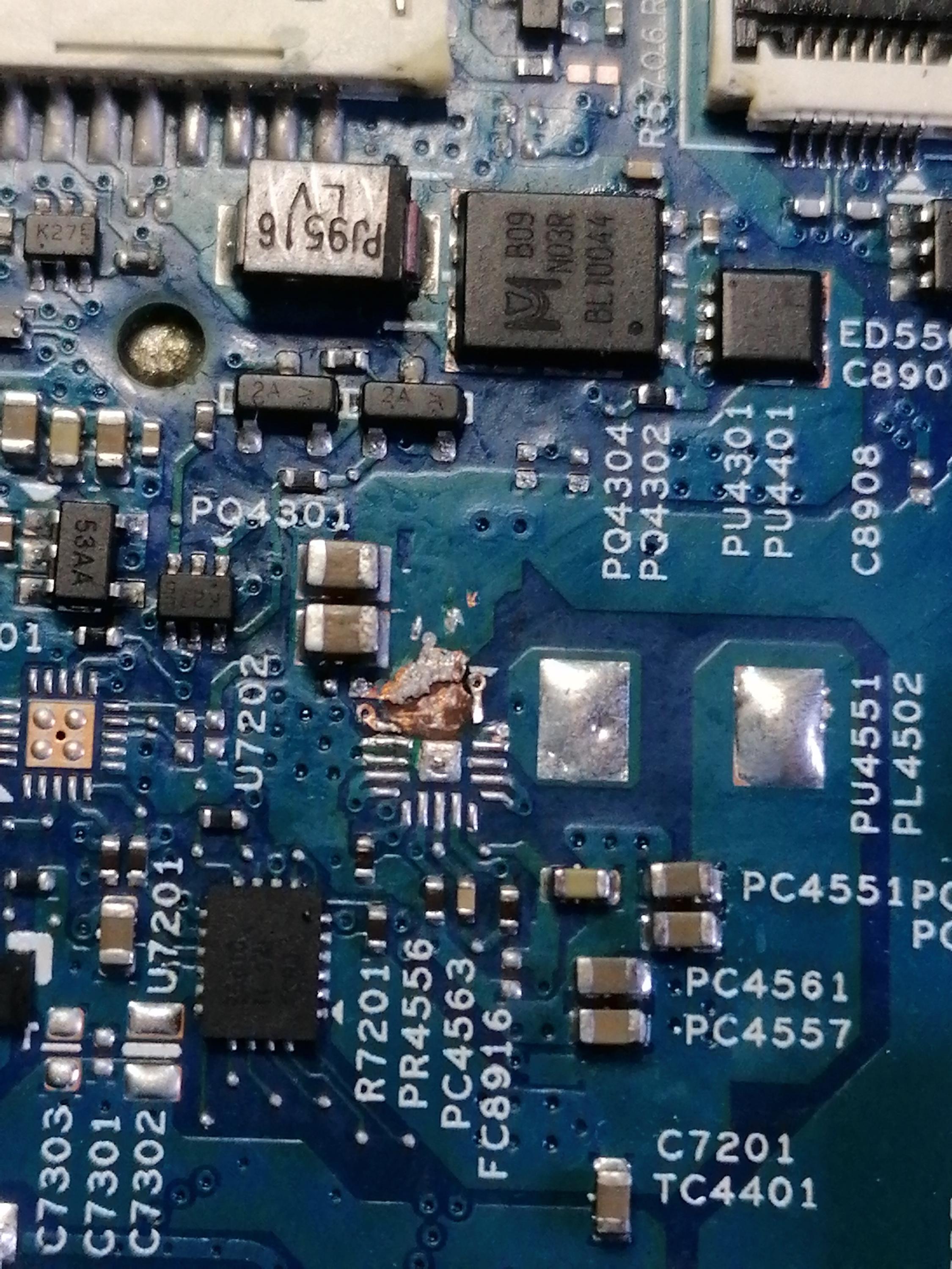

    Hi, does anyone hve a schematic for this model, laptop is after water damage and seems IC explode. Someone tried to fix this but without any result.

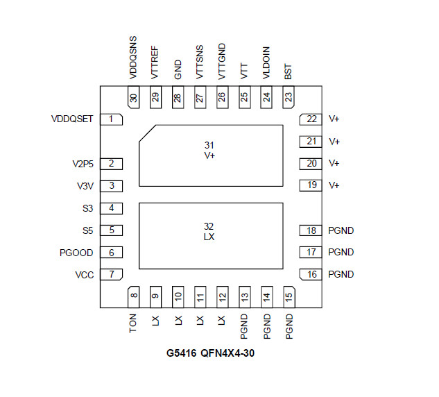

    Faroe_dis_x32_mb_mv 18742-1
    I need datsheet of g5416 ddr4 pwr supply ic or schematics of faroe_dis_x32_mb_mv 18742-1 448..
    Pls reply if anybody have

      Re: faroe_dis_x32_mb_mv 18742-1 HP Pavilion x360 convertible model 14t-dh100
      hello, that ic is marked as BACCCZ, maybe a colleague knows what it is.
        • 21652
        BAC*** SY8288CRAC - N/D (Quanta ZHP ZSP)
          RAM PWM DDR4 1.2v PL5101
