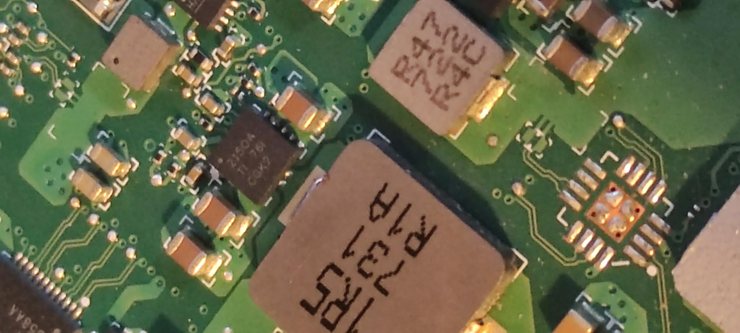

    Need a schematic (or component identification) for a ASUS C231 Chromebook. Board is DA00Q7MB6E0 Rev E (Model 0Q7).
    I've got a dead short on a few caps near the power switch. With voltage injection and thermal camera, fault is this IC. It's a Texas Instruments chip, but unable so far to properly identify it.
    Numbers on it are 2150A TI 761 CQ

    As a FYI, this IC has an unusual QFN package layout, known as VQFN-HR-18. Has 5 leads up each side, with 6 at the bottom and 2 at the top.
    What threw me on this one is that the number is 215OA, not 2150A. So it's a TPS56215OA buck converter. Here is the link for the datasheet. Now to find where to get one.
    https://www.ti.com/lit/gpn/tps568215oa

      Made from unobtainium. Not even TI have this IC in stock. There is another one avail without the OA suffix. Lower current rating (8A vs 10A) but it's a Chromebook so meh. On to the junk pile it goes.
