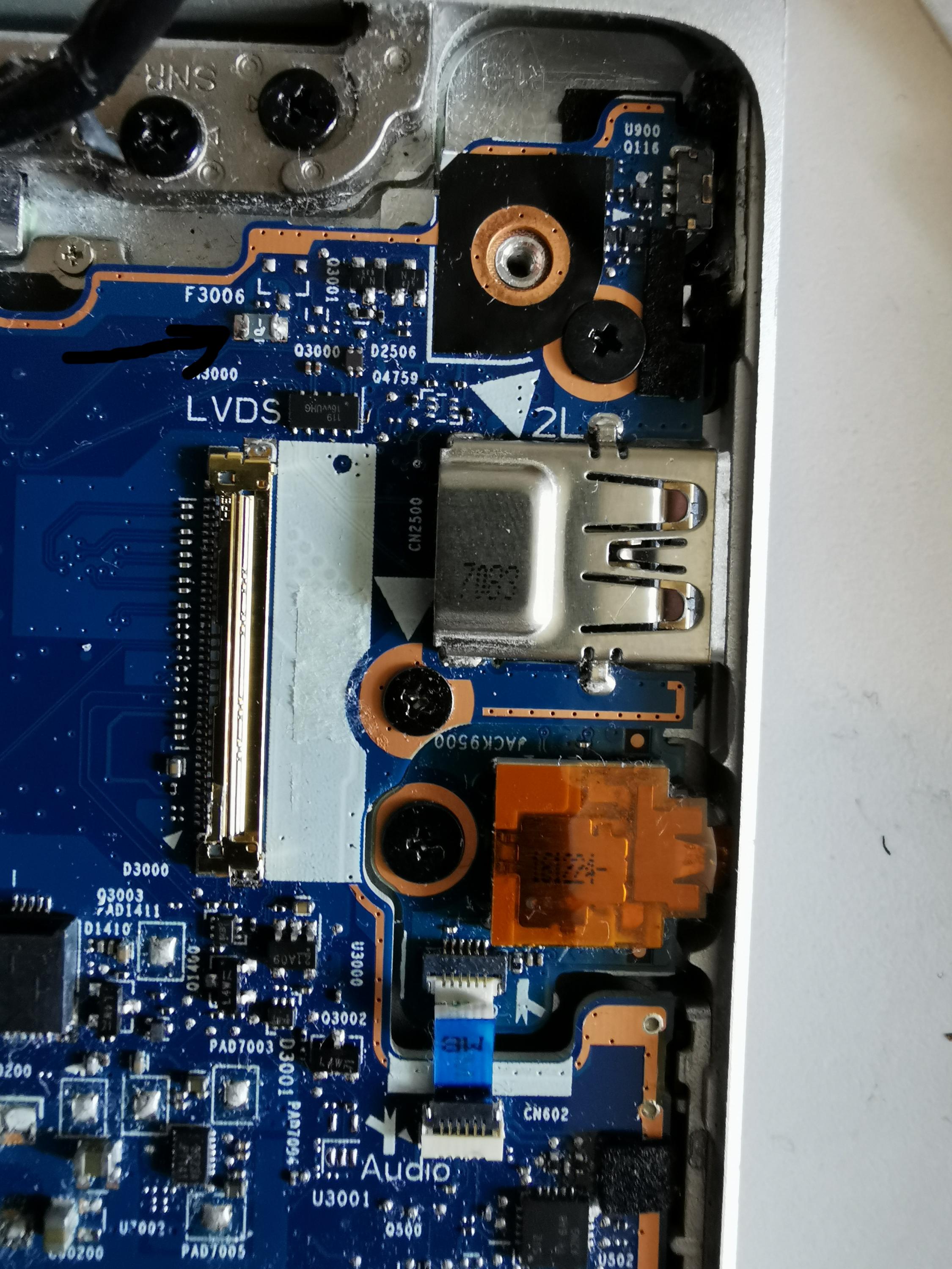

    I cant find the location of backlight fuse on the motherboard. All the fuses seem ok, but there is no backlight. Anybody know where it is ?

        Post clear and zoomed up pix of the LCD connector cable area. The backlight fuse should be nearby.
        Often the fuses are WHITE in body color but sometimes vary.
          Re: X360 1030 g2 backlight fuse
          I tought that the marked one is the fuse, but that one is ok.
          There is nothing on the other side.

            If the board is marked OLDMAN-6050A2848001-MB-A01 ,there`s currently no schematic available
              Yes, the one in your picture is the fuse.

                I there
                I dont know if this helps, but i had a similar problem with my X360, same motherboard.
                I looked for the schematics, fuses on the motherboard and nothing. The fuses i found on the motherboard where aparently all good.
                Then i bought a used lcd + assembly + cover from a old pc on ebay, and in the new/lcd all was good, i had retrolight in it.
                Then i dissasembled my lcd and i found that the 40 pin connector on the lcd from the motherboard, was a little disconnected, just a little but was plenty enough not to make contact.
                I plugged back the connector and by my surprise the lcd had backlight.
                The problem was that for some reason the 40 lcd connector disconnected a litle.
                Maybe this can help.
