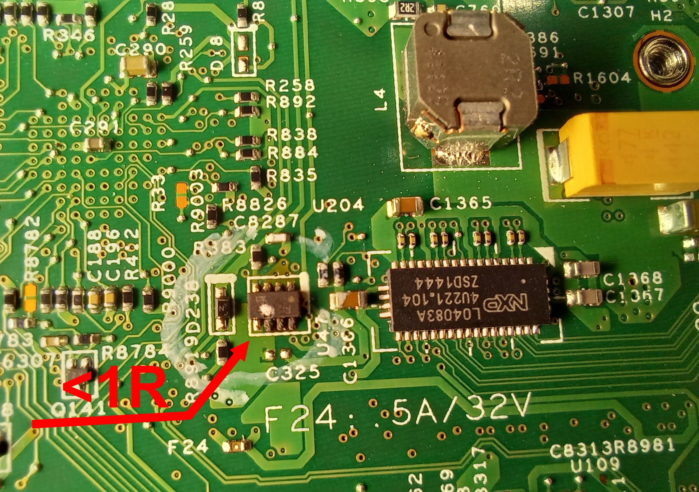

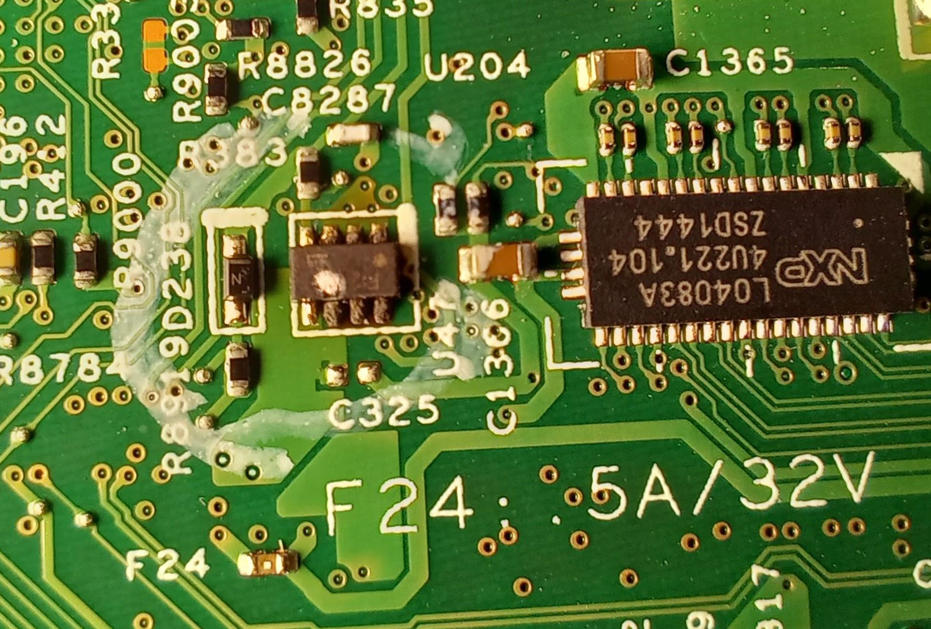

    I ask the Lenovo ThinkPad W540 WISTRON LKM-1 WS 12291-2 scheme. Or help in the extraction of the burnt component under the number U47.
  • Soleng
    • Jun 2020
    • 8
    • Ukraine
    Re: Lenovo Thinkpad W540 Wistron LKM-1 WS 12291-2
    On the 5th pin of the element is understated resistance. R<1 Ohm. Please say where is this conclusion connected?
        Originally posted by SMDFlea
        Schematic .
        Thanks for assistance, punched HUB has been revealed.
