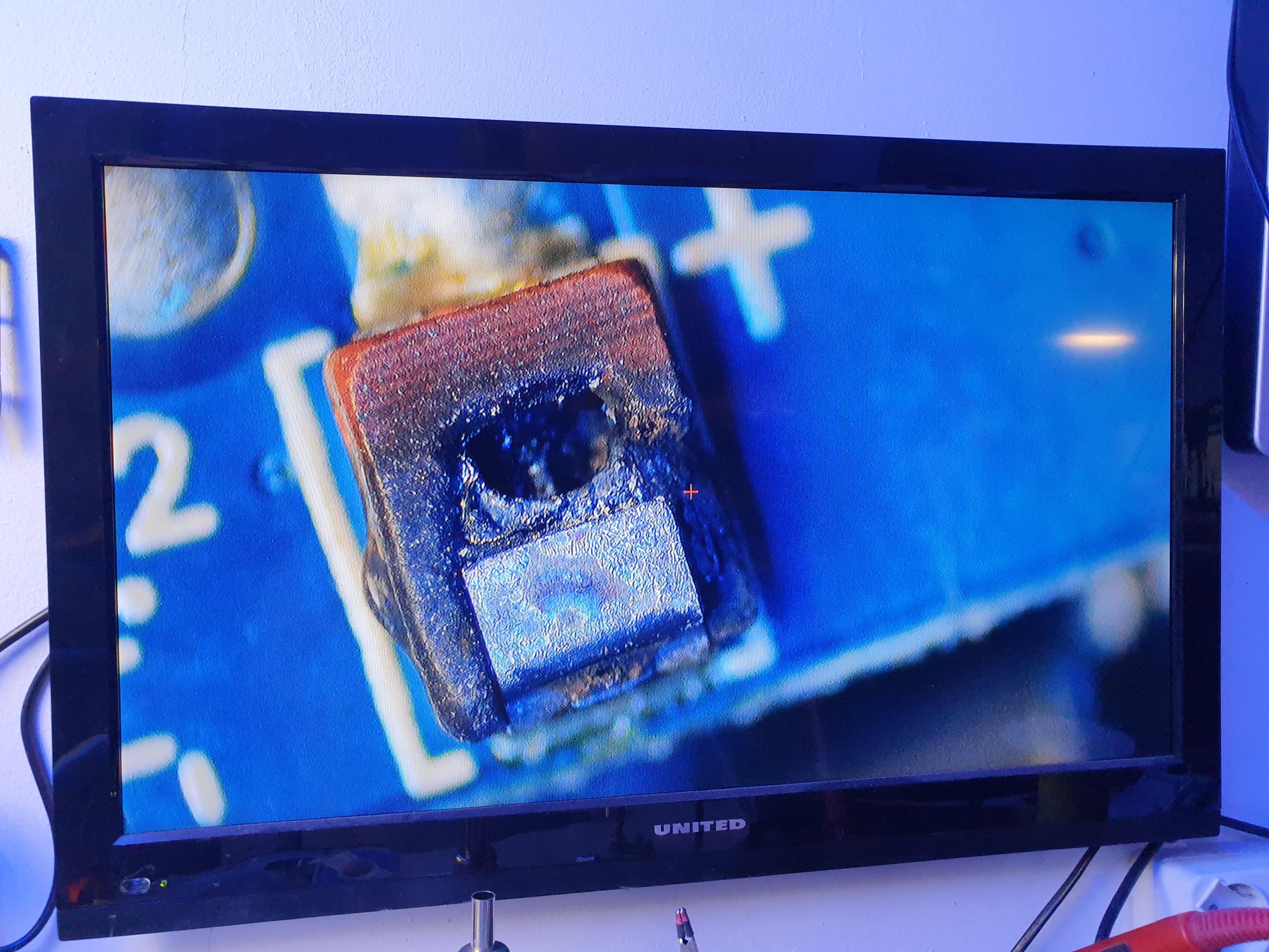

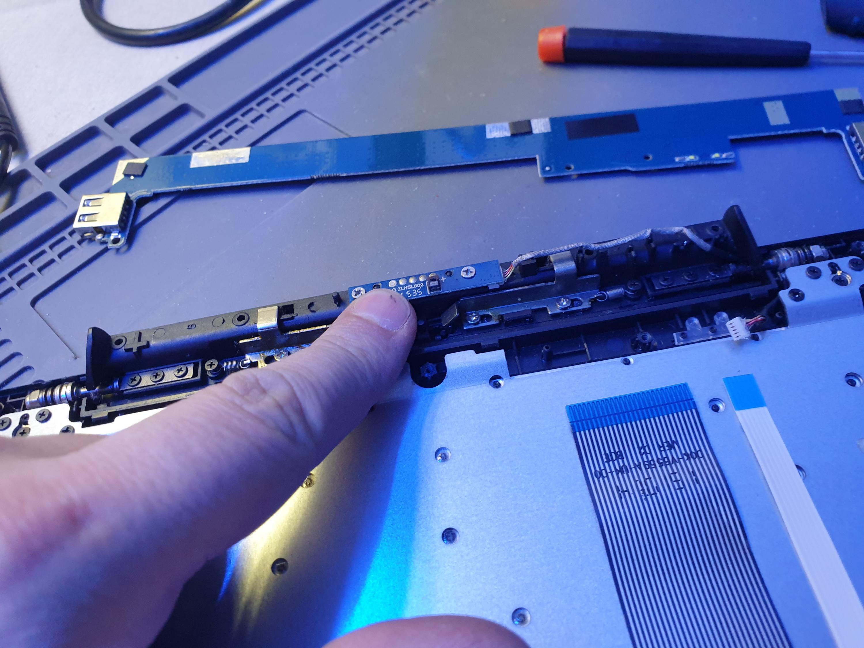

    this is the diode (on detachable keyboard)
    burned because the customer inserted the power jack on a USB port...
    anyone know what diode can be this?
    2 pics on attachments
    probably thesame diode can be found on miix 310 ... or 320.. but icanàt find schematics about this "new" miix tablets.

    Re: Lenovo Miix 300 schematics for a burned diode.
    i'm thinking to replace with a schottky diode 2A... the SS24 maybe... 40V 2A (the fastest that can be dilivered on my shop looking at ebay) or the SK22... 20V 2A
    i saw that on arduito to protect main power line there is a 0.5A schottky placed on the same way...
