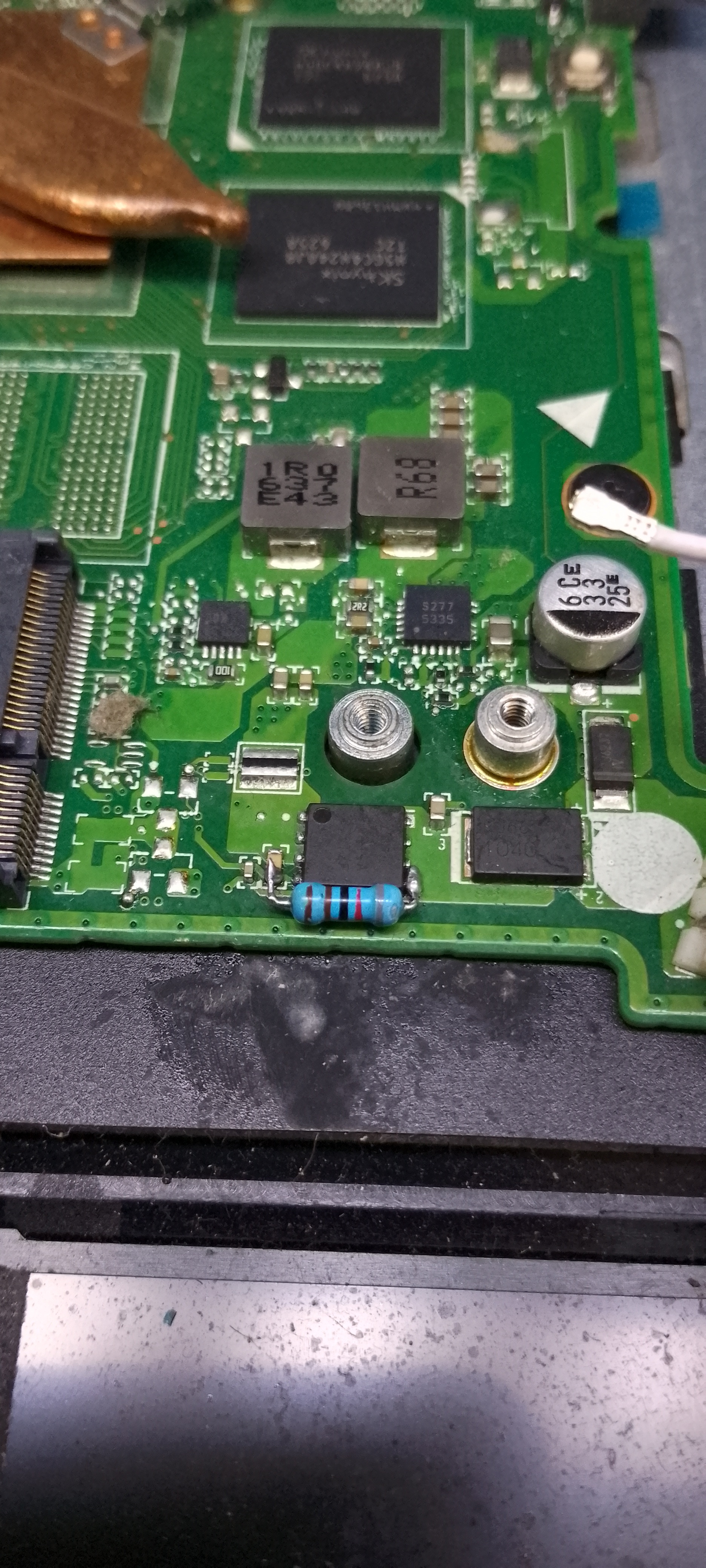

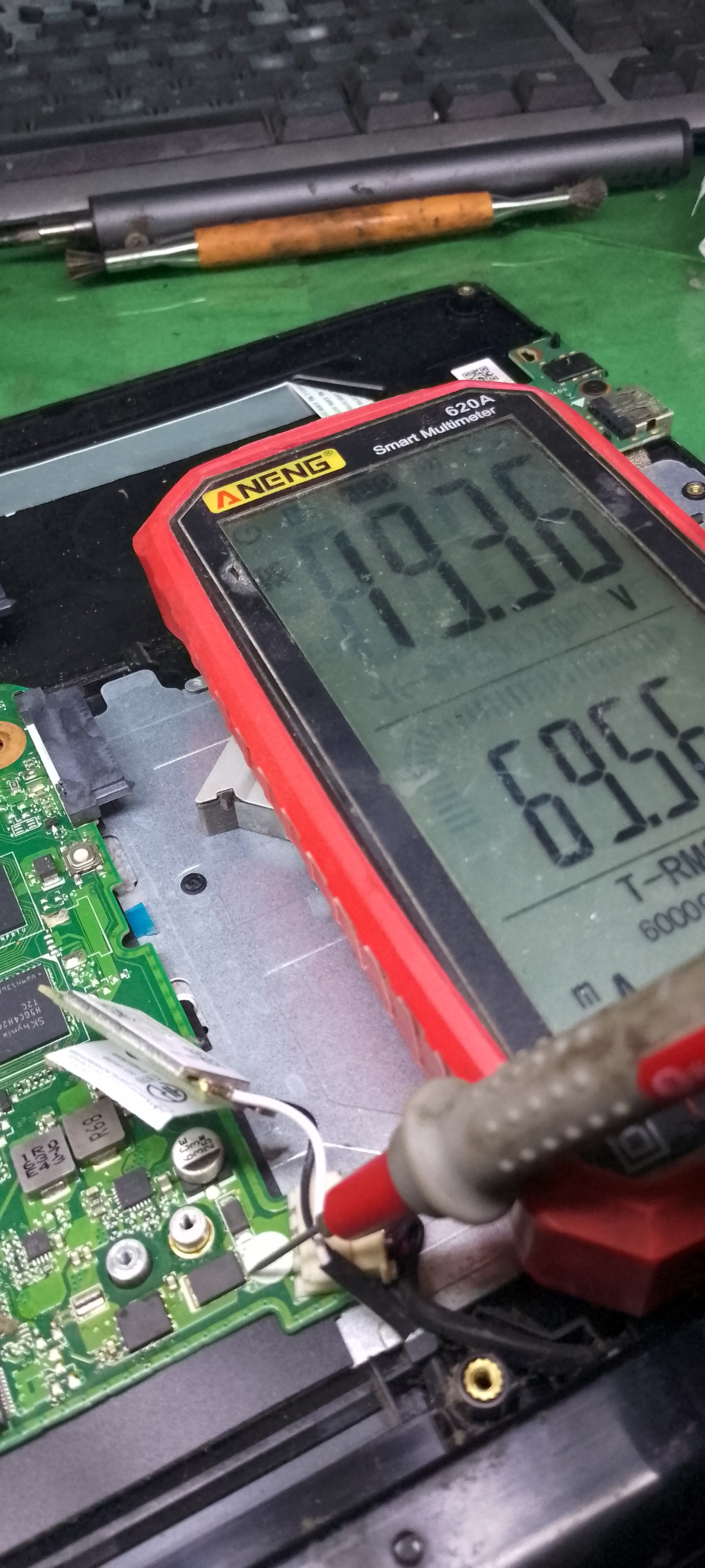

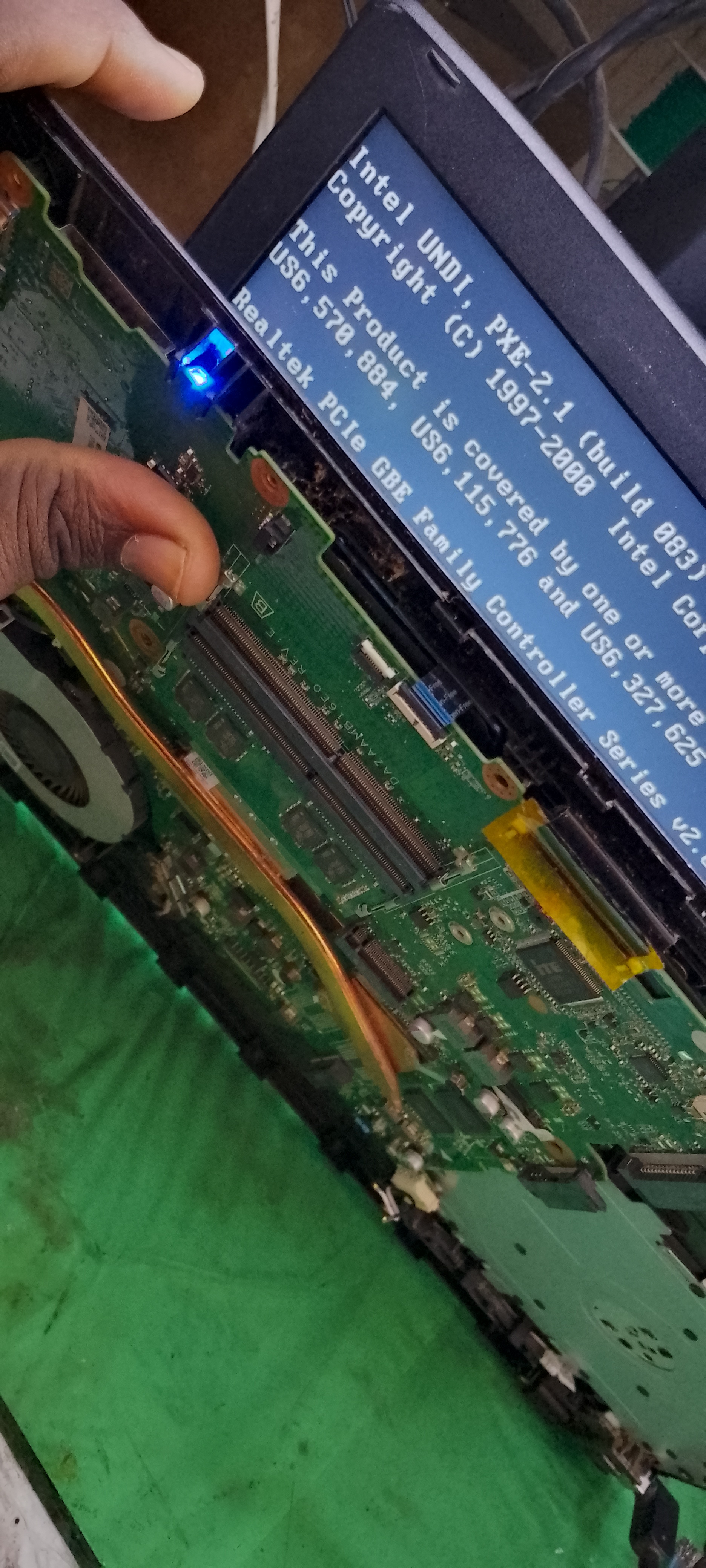

Schematic Acer Aspire E 15, modelo E5 575G-511A.
  • Goverdown
    • Dec 2021
    • 5
    • Côte d'Ivoire

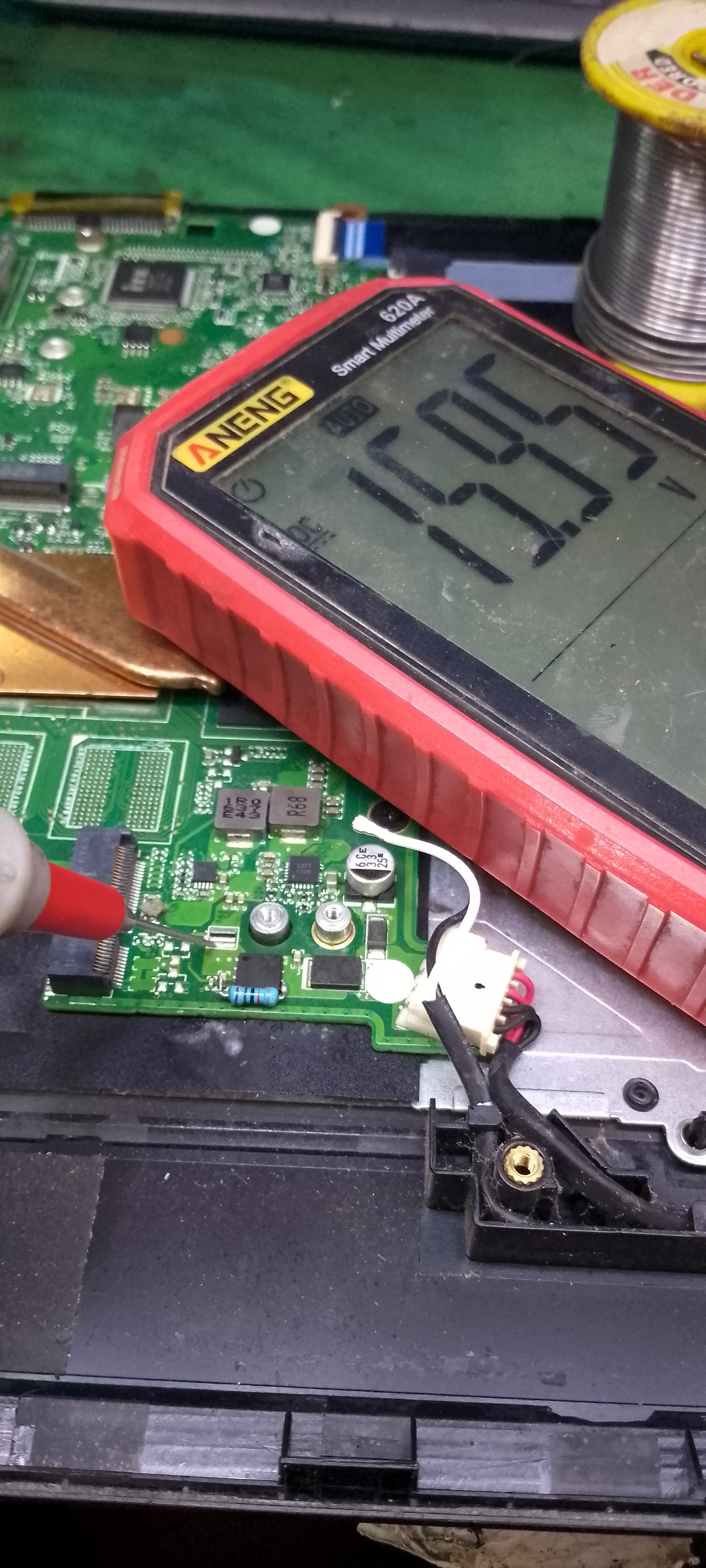

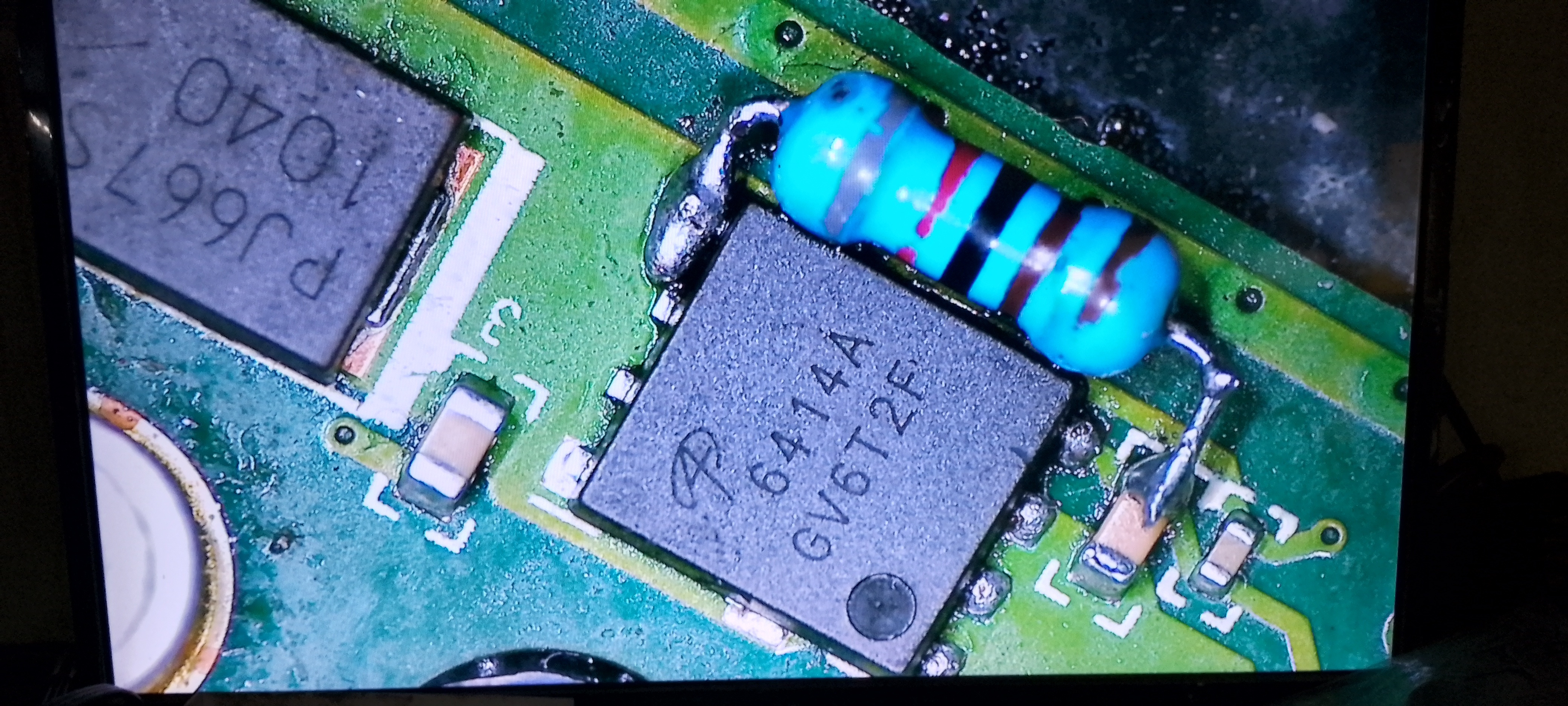

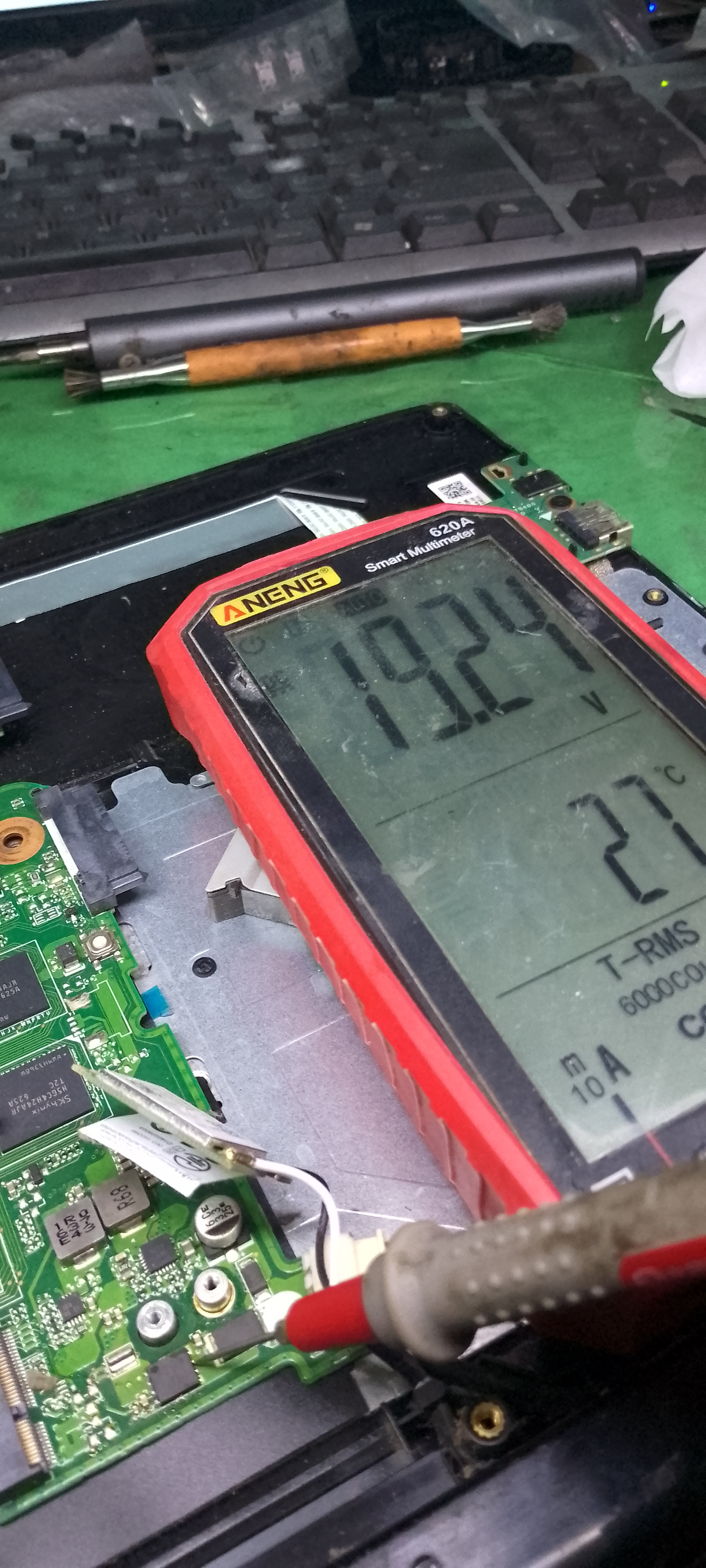

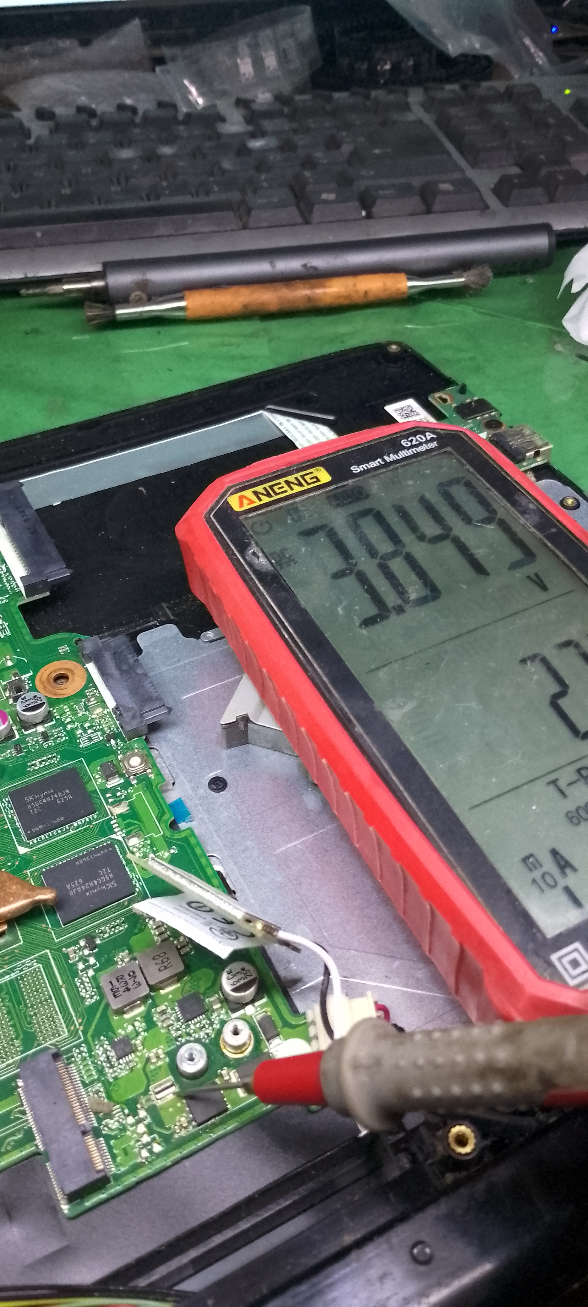

    Bypass 19v , Motherboard reference: DAZAAMB16E0 REV: E

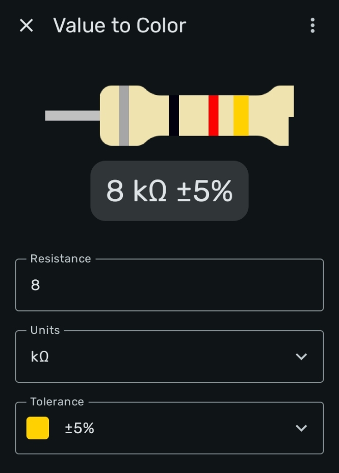

    Use 8k resistor To make the bridge .
