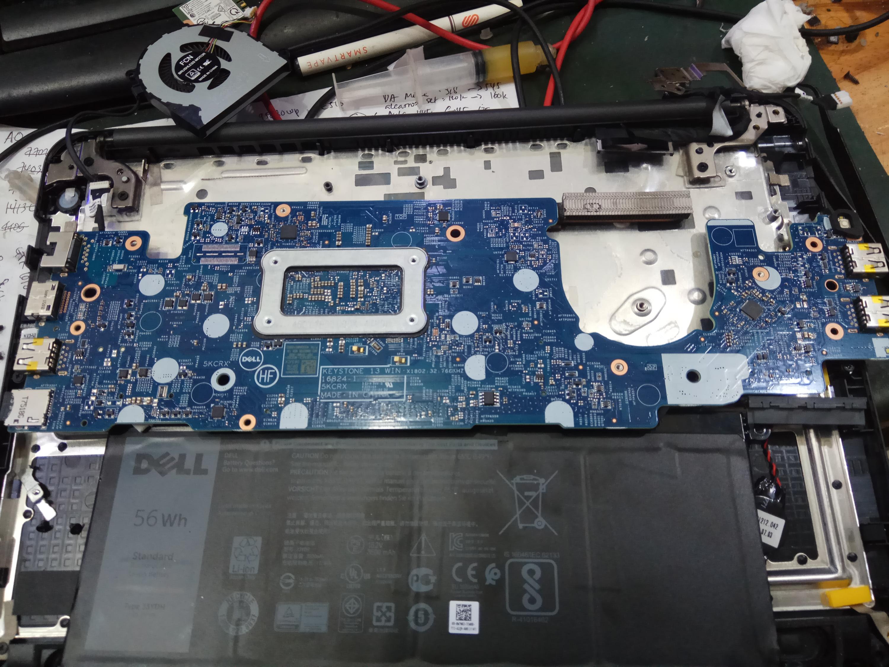

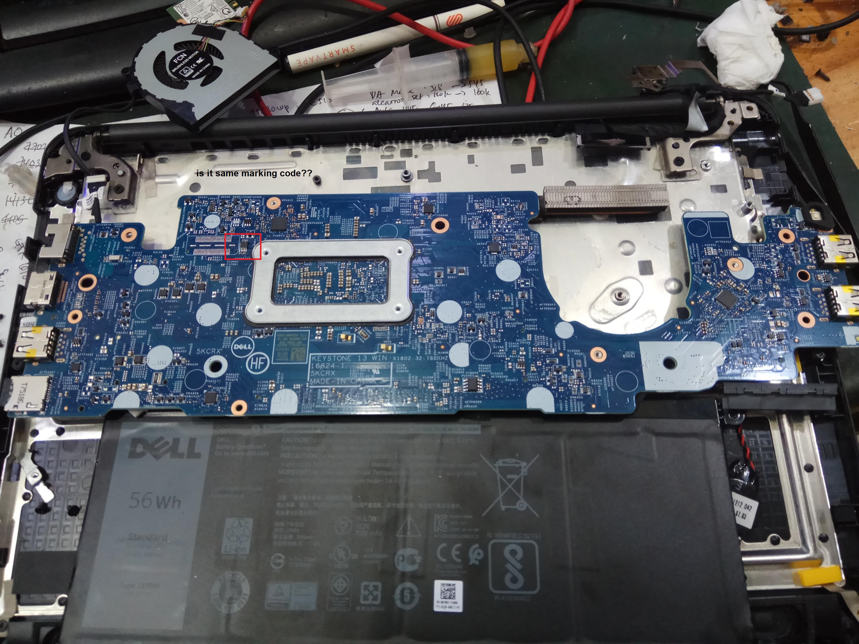

    hello guys, anyone have schematic dell lattitude 3380 (P80G002).
    and one ic get hot, but i dont know what ic type.

    The shape look like ic supplied for USB or HDD/ODD, but not sure 100%. Maybe Silergy's IC (similar or new revision for SY6288x), trace the pin out. Probably input connect from 5V_S0 and output connect to SATA / USB connector.

      ok tomorrow i check voltage every pin.

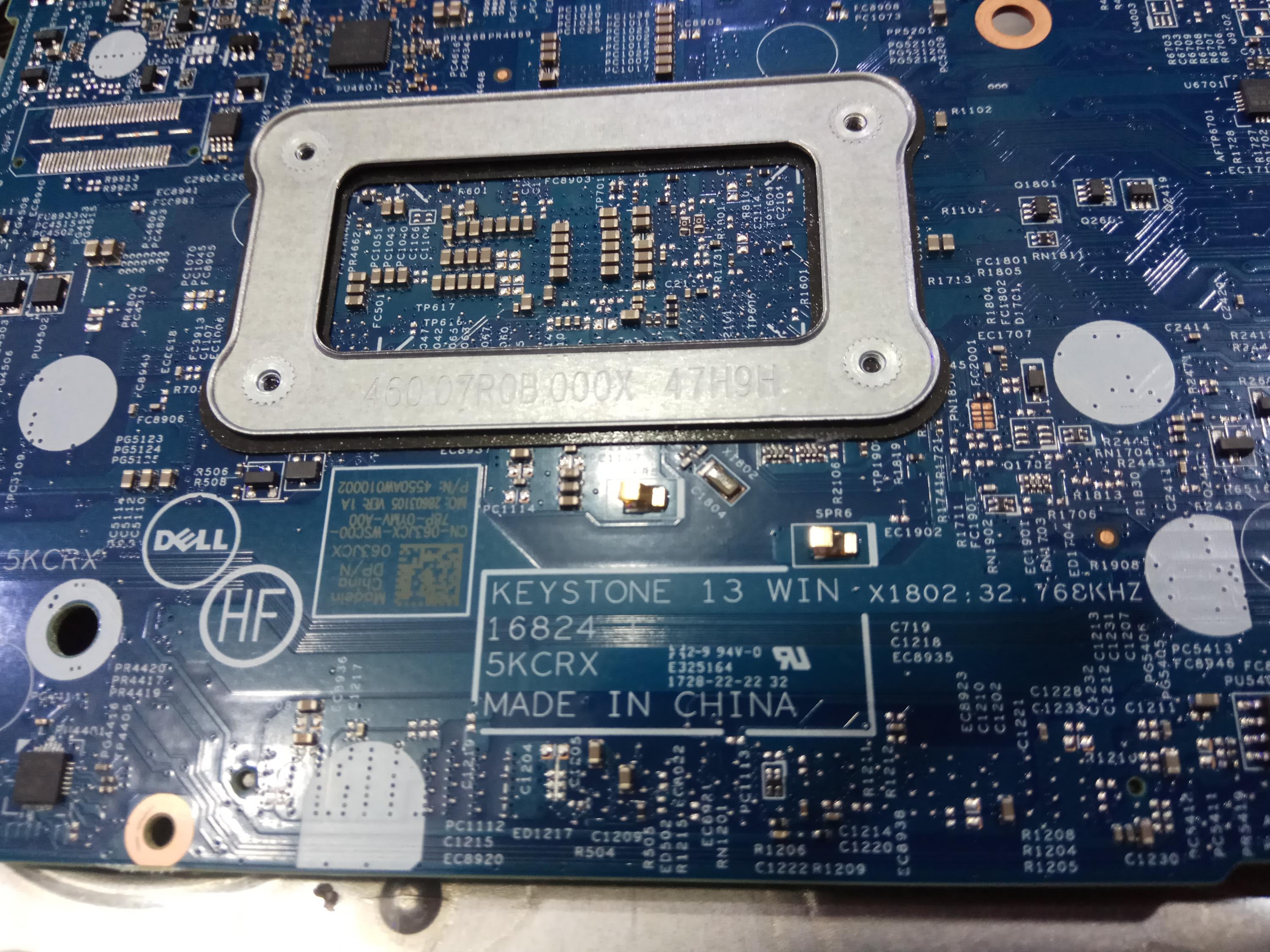

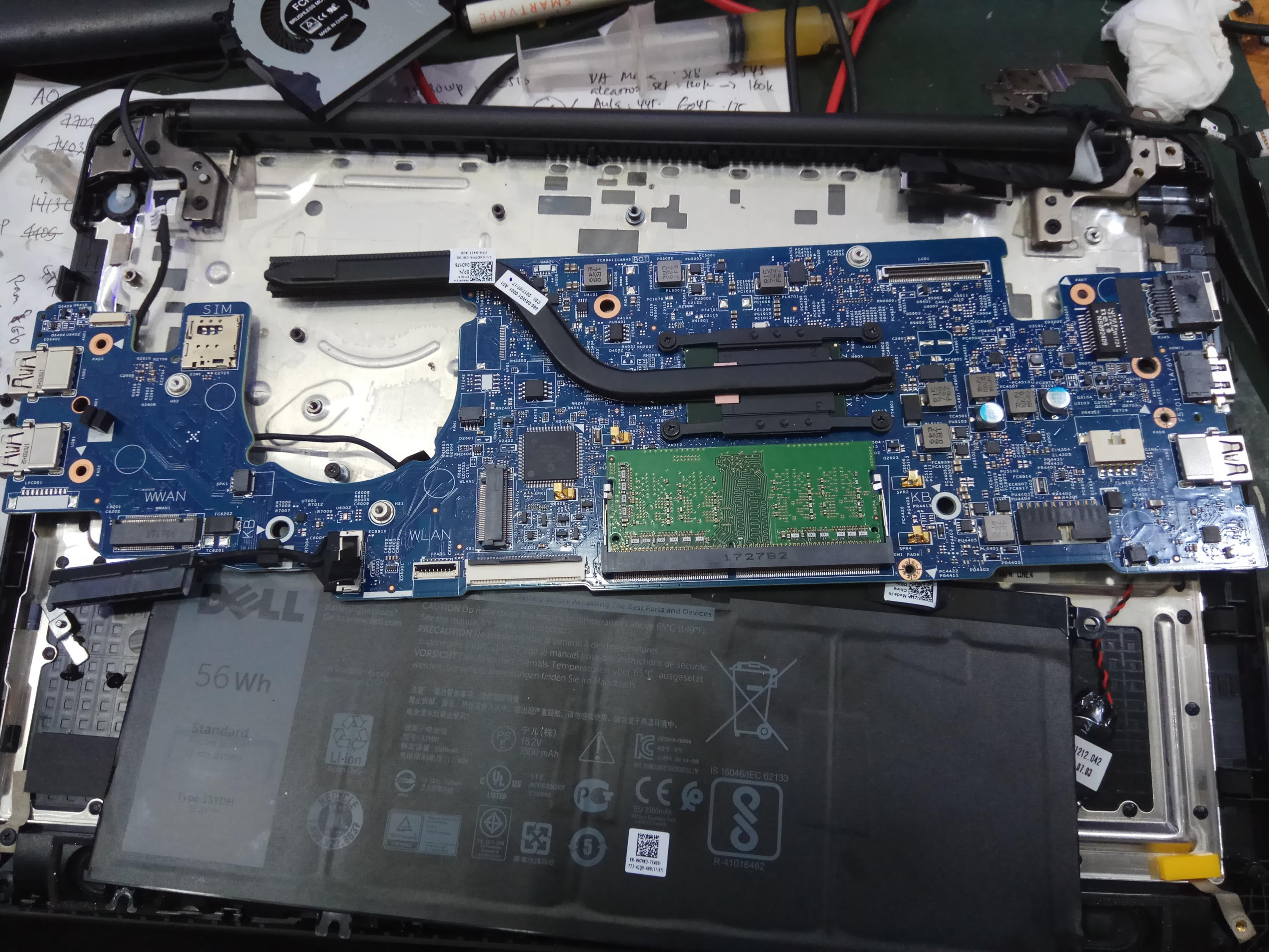

        Re: need schematic dell lattitude 3380
        this some picture

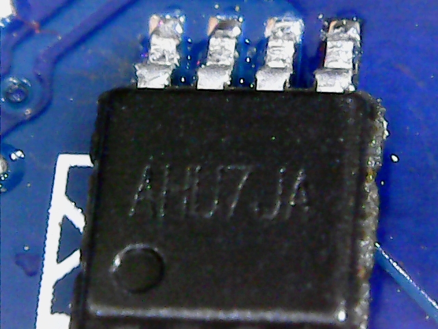

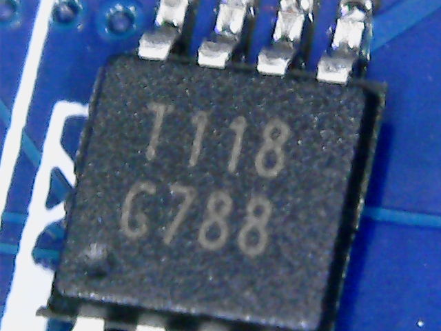

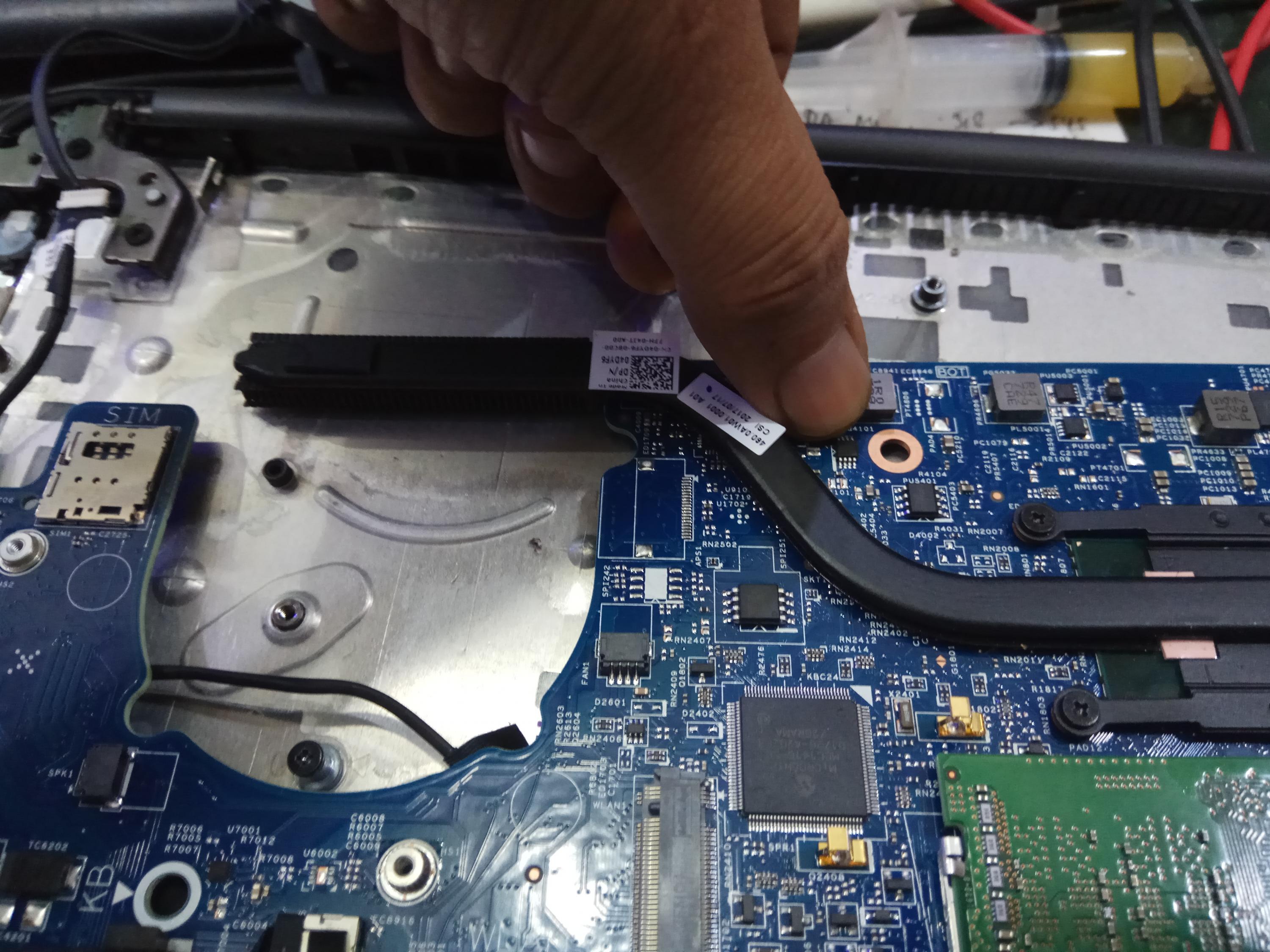

          The position near grey coil 1.0 uH make me doubt that it is IC for supply USB or SATA. that rails is too far for any USB or HDD conn.
          I have question on photo that part was marked red rectangle, Does it same marking code AHU7JA?
          EDIT: Forgot attached pics

            different marking code.

              case solved !!....i release the ic and inject 1v to pin 5. and my powersupply got 0.5A. i got hot caps. I replaced and problem solved.
              thanks brooo for ure help
