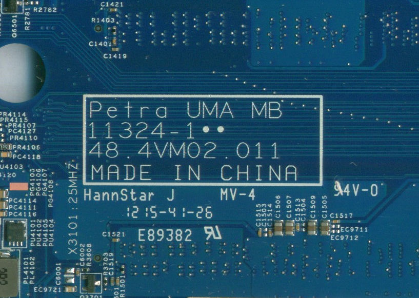

    Dell Inspiron 13-7368 Need For Help Schematic
    Dell Part Number: X6C95 0X6C95 CN-0X6C95
    I need Schematic Diagram for this Laptop
    i identify one the Part are code on PU4501 have Burn.
    On the Actual Test.
    I receive This Laptop. have no power, i plug in the charger Adapter On DC in Connector. the indication of light @ Adapter has been turn off.
    Isolation's need this i'll try to Remove
    the Following
    PL4501 near on PU4501 (suspected) but i dont know what ic is it? but they also have Chip Marking as a (AWV5YG) 5 side to side pin total of Pins 20
    Now the Adaptor is not turning off, if i plug in w/o install this parts PL4501 & PU4501 (suspected).
    Those any one have keep this Datasheet or Schematic Diagram. Would you help me Please

    Re: Dell Inspiron 13-7368 Need For Help
    AWV5YG =SY8286B
    Datasheet not available for silergy.
    Use schematic Compal LA-C341P as reference for pinout and function (already on this forum)
      I think this board is Wistron, and you give code from barcode.
      seek code like this in example Petra Uma 11324-1
