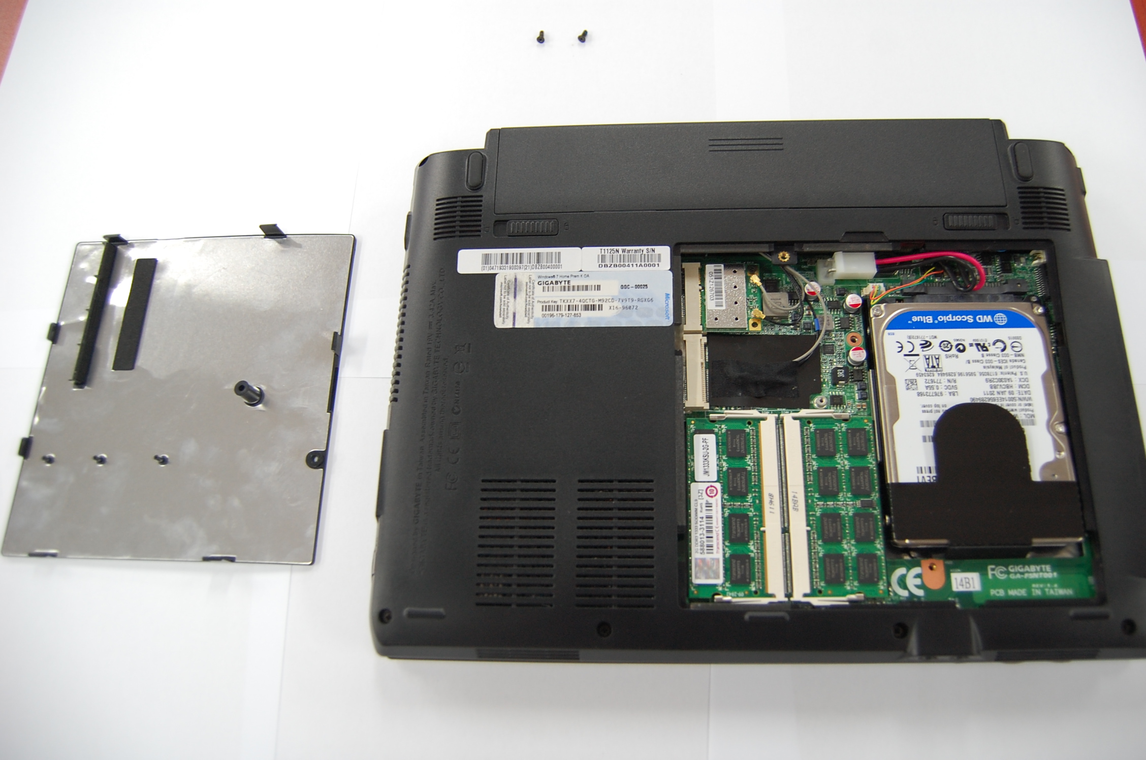

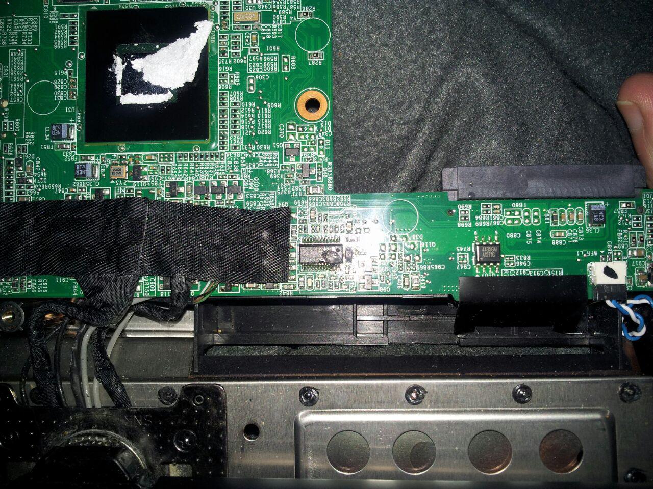

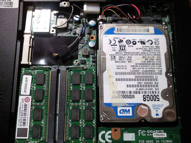

    I need to know which connection on the board is Positive + & Negative - for that wire going to the board.
    As well as the pin out on the board & battery header of those 3 colored wires.
    Total : 5 wires
    *board power header*
    positive + (red/yellow)(is it on the left or right?)
    negative - (black)(is it on the left or right?)
    *3-pin header*
    unknown - (orange)
    unknown - (yellow)
    unknown - (green)

    This video helps us get an idea but need to know which color on the board goes where & also need to be for sure that the positive negative terminal on the motherboard is connected correctly as well. Since the laptop has not worked with the battery at all... It's not a good design. I had to take the connect apart to solder smaller leads to the positive negative pins but did not take pics/ document where the wires were.

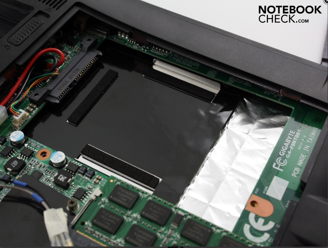

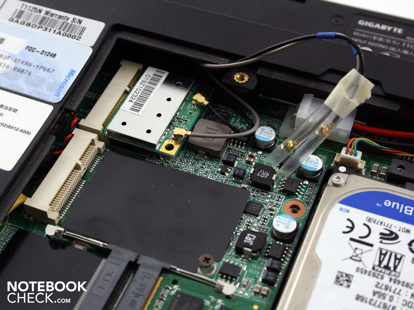

          I found one (small) picture that shows this connector. Unfortunately, it only shows clearly where black and red go.
          The other 3 wires are going to be clock, data, and either a thermistor or battery presence indicator. All should use 3.3V logic levels. You can measure the voltage on those 3 motherboard connector pins to make absolutely sure.
          As long as they all use 3.3V, it's really just a matter of time to find the right order. There are 6 possible permutations of those 3 wires. If you guess wrong, it won't be happy (thinking either the battery isn't installed or has a problem), but nothing should blow up.

            It's insane how blurry that picture is well... now the Laptop won't even startup over the power supply... & making a weird whining out of the speakers...
            I need clear photos because the laptop *WAS* working fine prior to adjusting the battery connections
            It won't power on at all any more.. I know + / - RED BLACK is correct but the other wires are F****D.

              Laptop is now TOAST... This sucks !!!!!!!!!!!!!!!!!!!!!!!!!! Smoke Billowed Out ... right under the 3-pin connector
