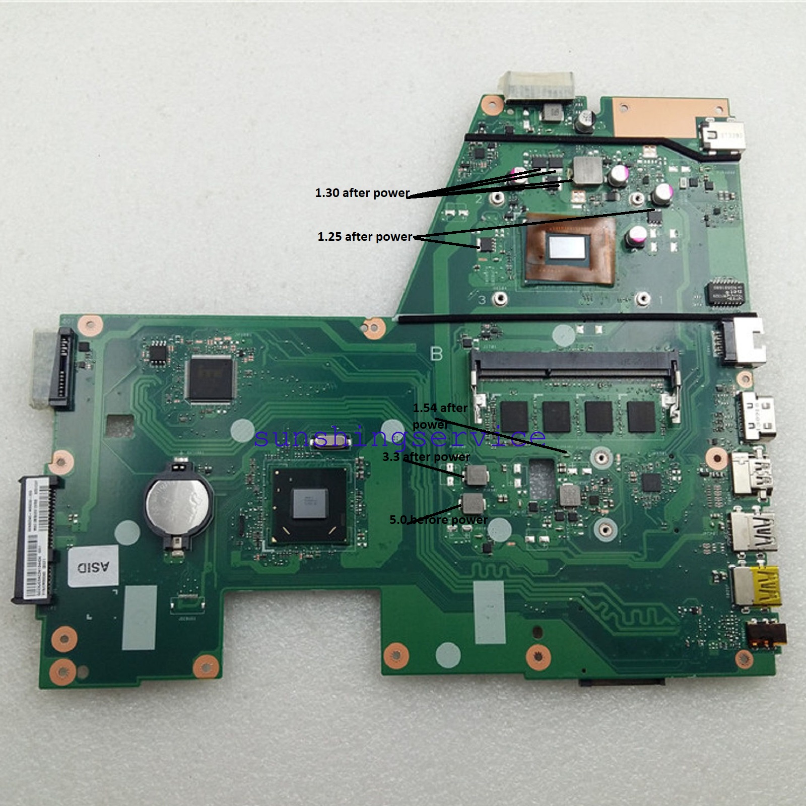

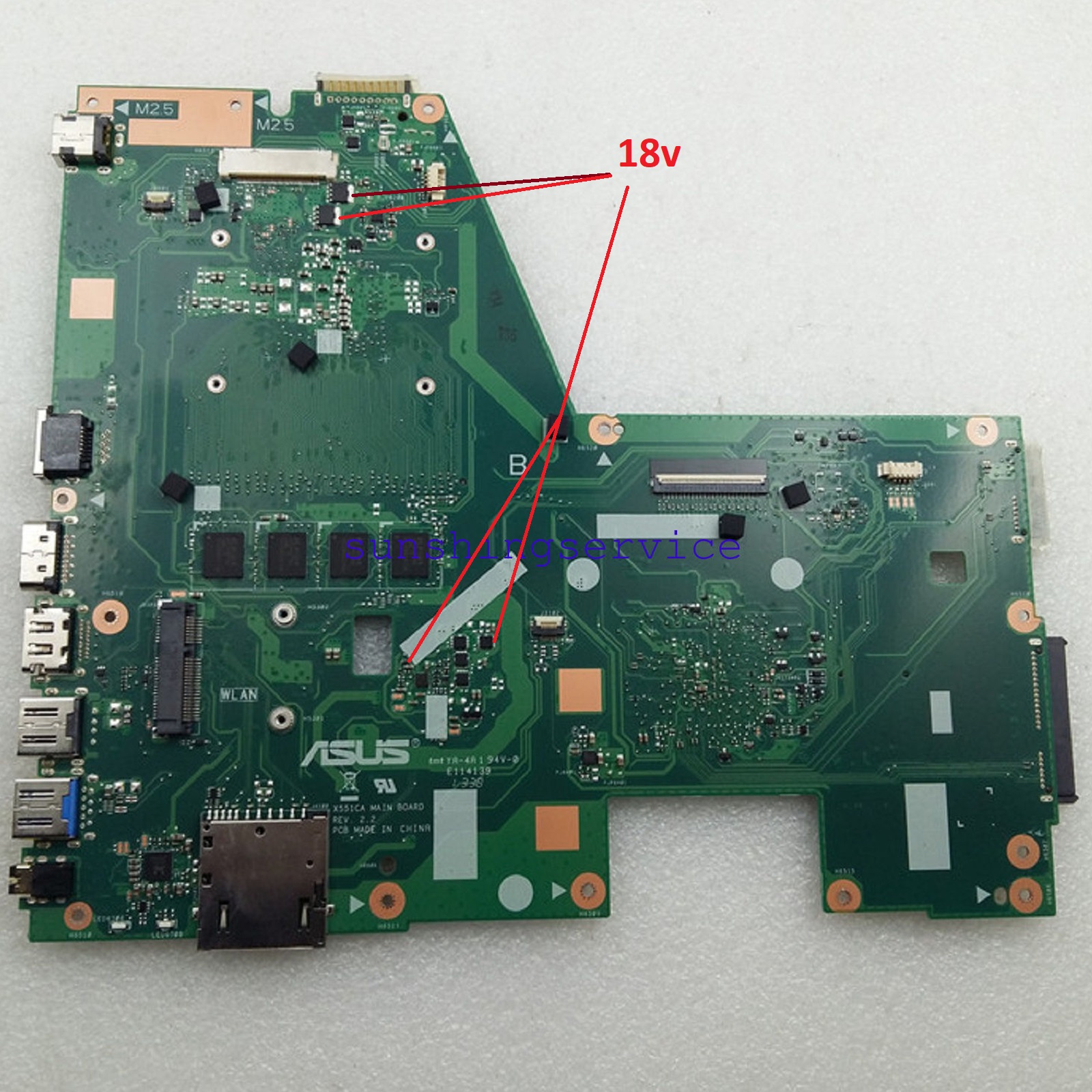

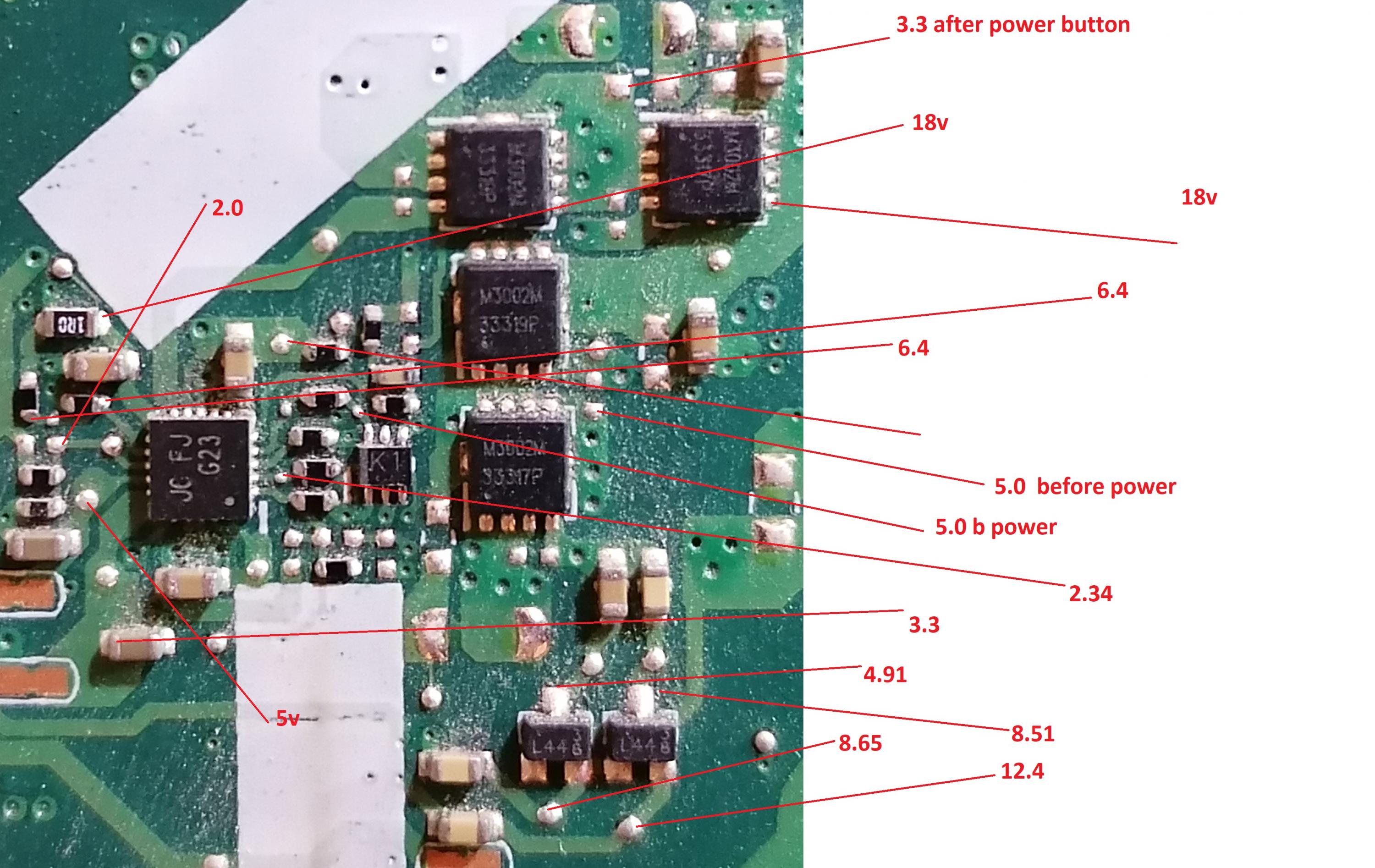

                        Repair guide...hope it helps you
