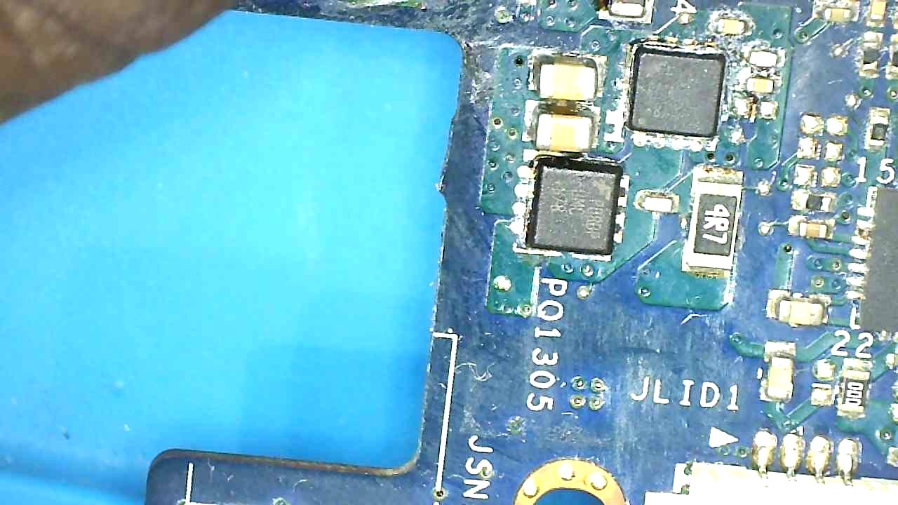

                                Re: Latitude 6430u shorts ac adapter/ need schematics LA-8831P
                                one caps shorted near of PQ1305, changed, laptop is ok
                                two big caps, up one was shorted
                                  Thanks for schematic.
                                  Have same problem (short circuit in B+). But not near PQ3105.
                                  After some tests (give power in B+) had find warm place near PQ706 and PQ704. One of capacitors was in SC. it was 10u 25V 0805 smd capacitor
