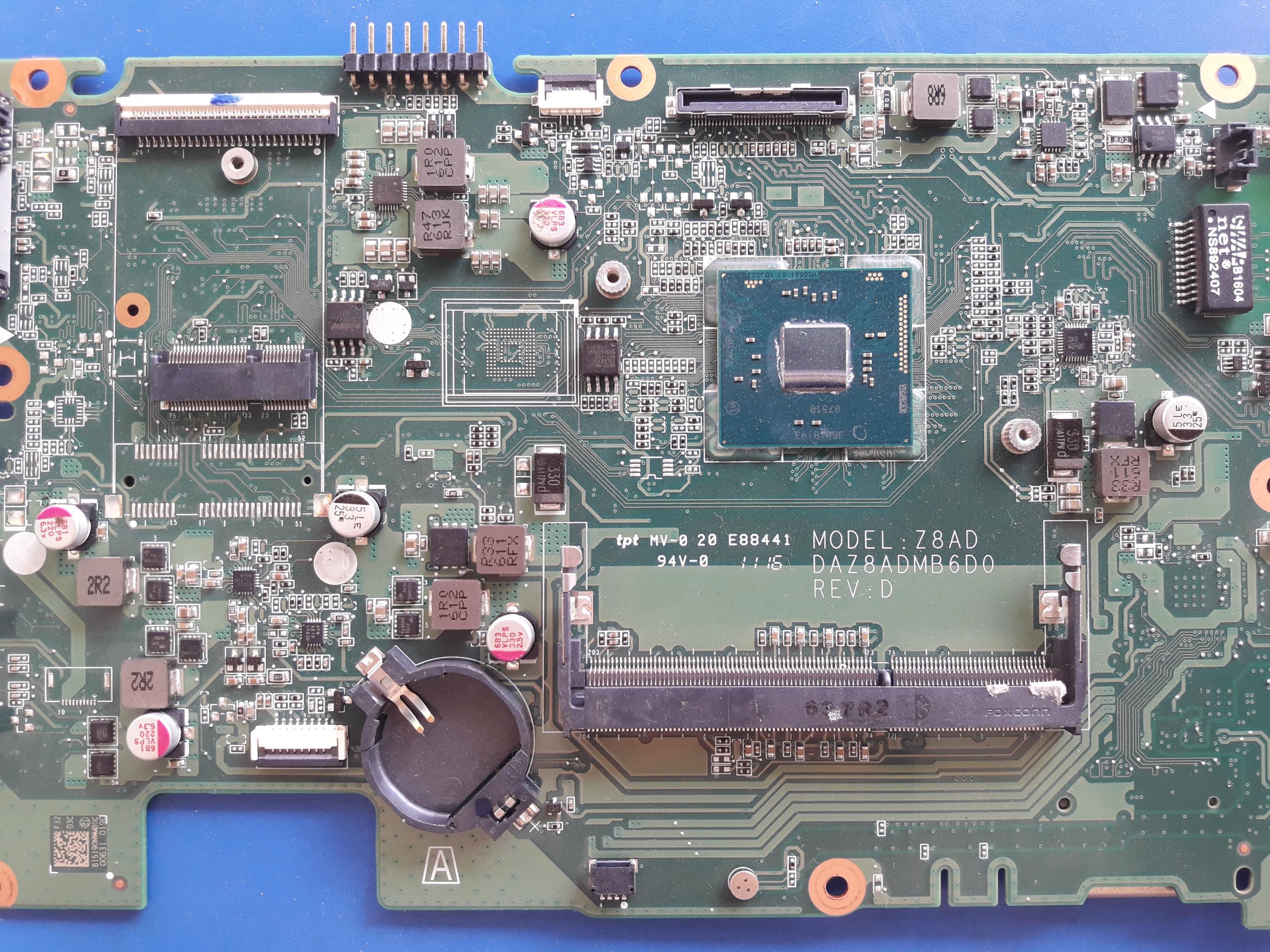

    Please share diagram for following model.
    Model:Z8AD
    DAZ8ADMB6D0 REV. D
  • dspok
    • Jan 2014
    • 553
    • Nepal
    Re: Acer ES1-431 schematic
    I found the schematic and found SPI_PWR is ground with 6ohm.
    Can't figure out the problem.
    Anybody?

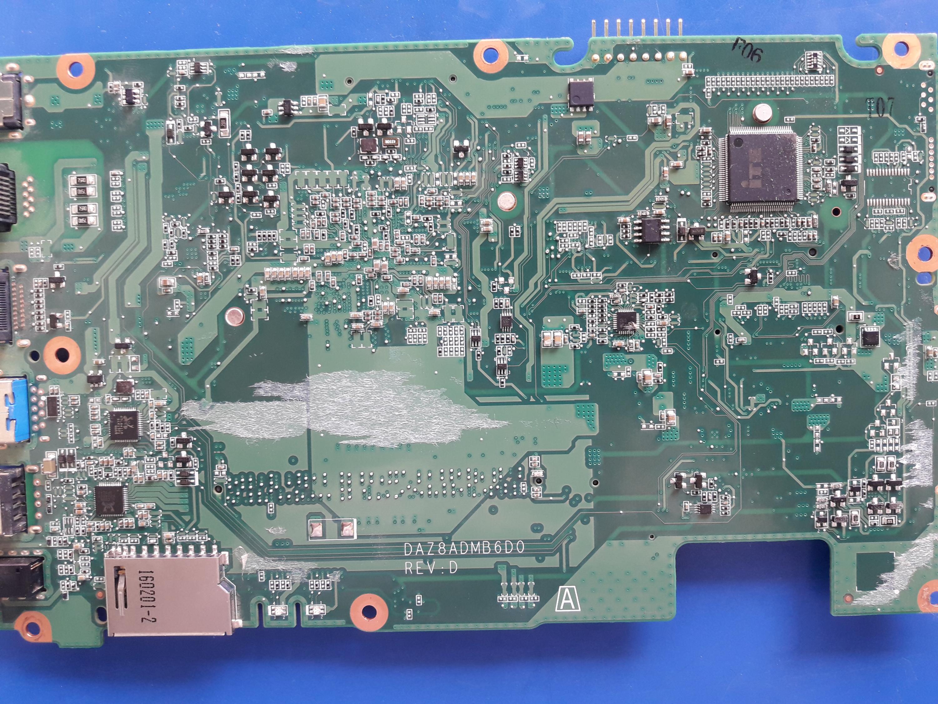

          No boardview and no markings on the board? Will not be an easy one... Can you post high resolution picture of both sides of the board? As much details as possible around the BIOS chip (trying to see where does SPI_PWR come from).
          • dspok
            • Jan 2014
            • 553
            • Nepal
            @piernov
            Yes no markings on board. As already said SPI_PWR is leaked to ground and it is vcc for both ec and main bios.
