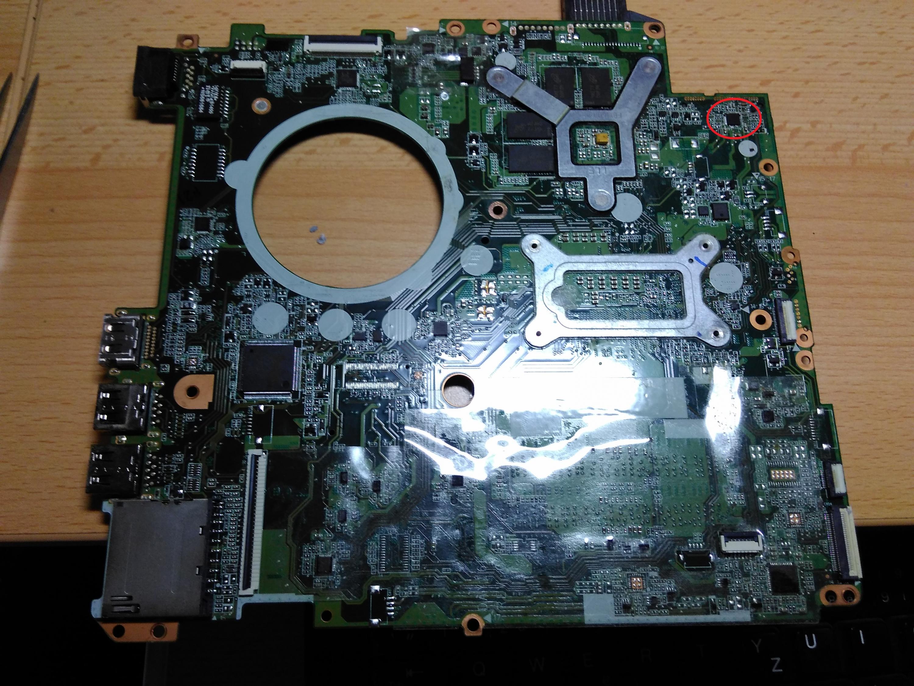

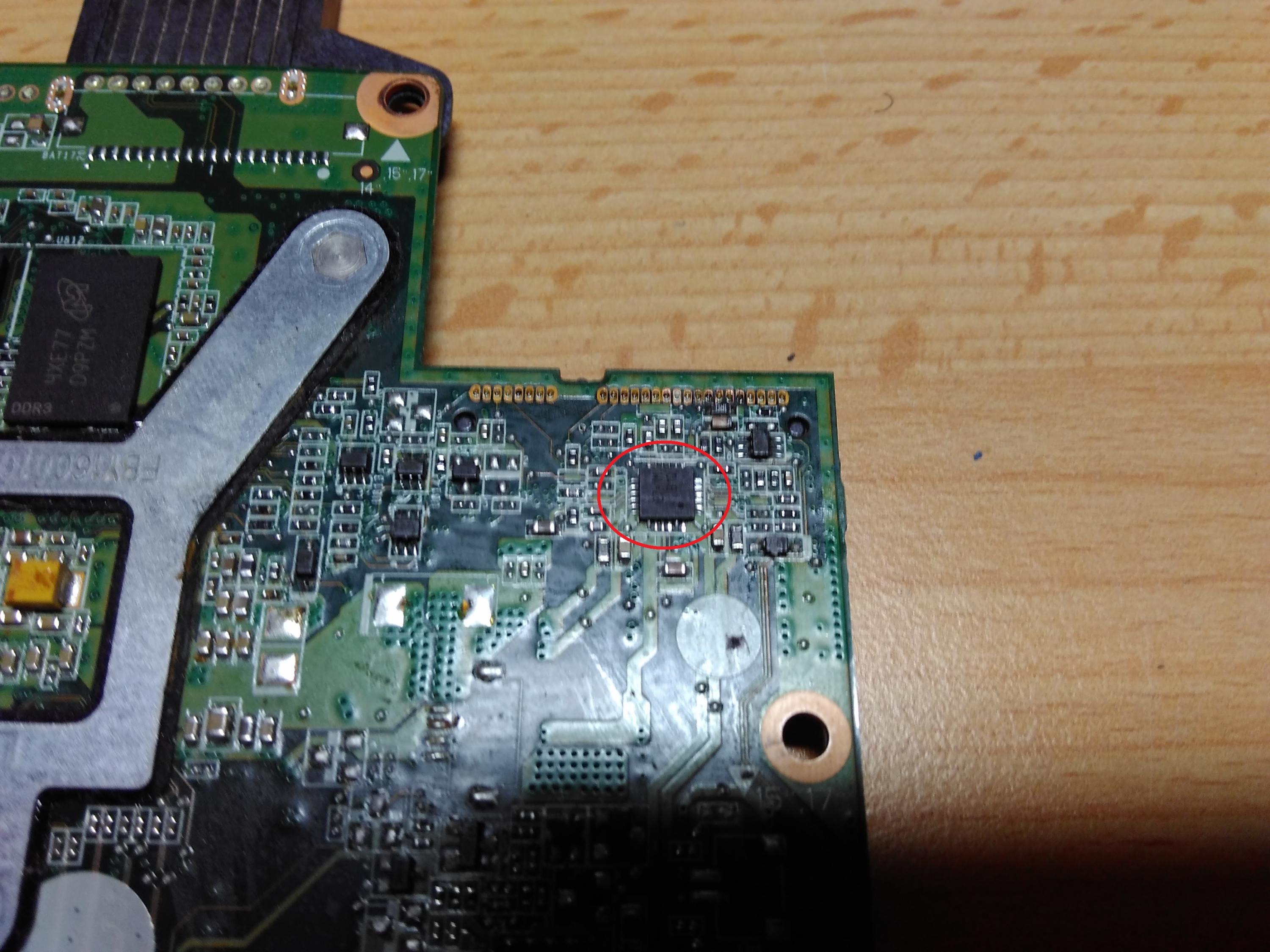

    I would like to ask for help with HP Pavilion 15-p ( Intel Core i5 5200U Broadwell, NVIDIA GeForce 840M 4GB, M.2 SSD 256GB).
    Laptop doesnt detect discrete GPU geforce 840. I need to identify component (see attachment) which is marked 27=1M as I cannot measure power for GPU.
    If possible, please share schematic, board DAY16EMB8C0 rev C.
    Thanks for any help

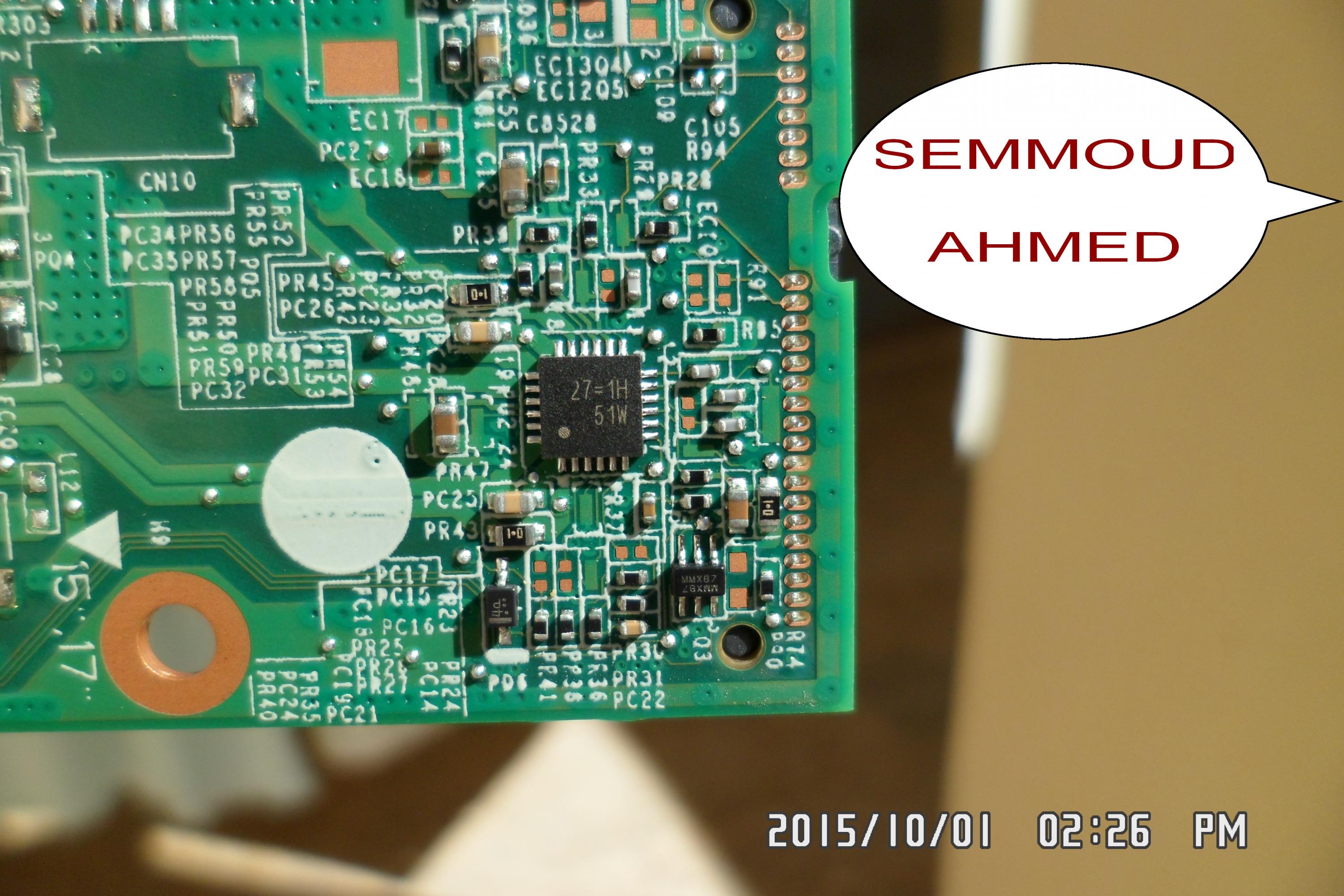

    Re: HP Pavilion 15-p schematic, identify component or problem
    The Component u asked for is
    Richtek RT8813C which is Multi-Phase PWM controller with PWM-VID reference.
    link: http://www.richtek.com/Products/Swit...specid=RT8813C
      AS this
