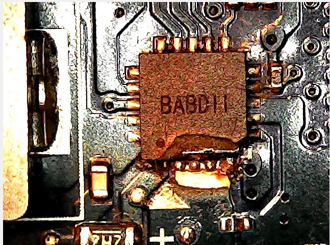

    Samsung Galaxy Book nb3586 nb3587_pcb_mb_v8 rev 1.3
    hi, I'm looking for the schematic of this laptop.
    On this laptop went just a bit of liquid from back when was on and an IC burnt.
    Now laptop doesnt' power on and if power adapter usb-type C is connected switch correctly to 20V but just 0,032A even if battery is connected.
    On battery there are 15V.
    IC is a 20 pin (5 for each side) and around it all seems to be fine.
    Its located on top board back the HDMI port and near 2 big 1,5 ohm resistors.
    Here's a pic of it clearly burned!

    Looks like a silergy chip - https://www.badcaps.net/forum/troubl...02#post1538202

      Yep looking the Silergy tab on the linked thread considering the first 3 letters: BAB should be a voltage regulator SY8288BRAC.

        Found datasheet is someone needs it.
