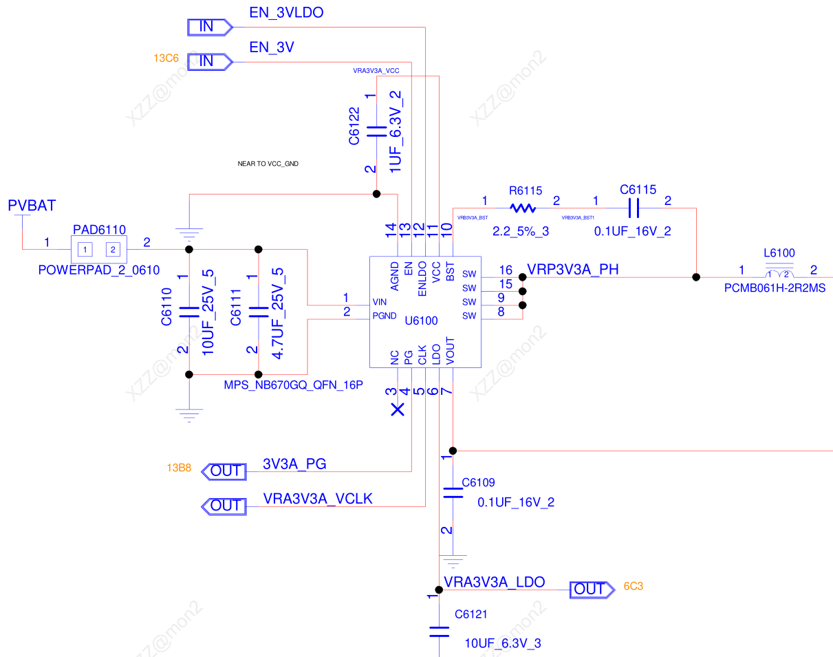

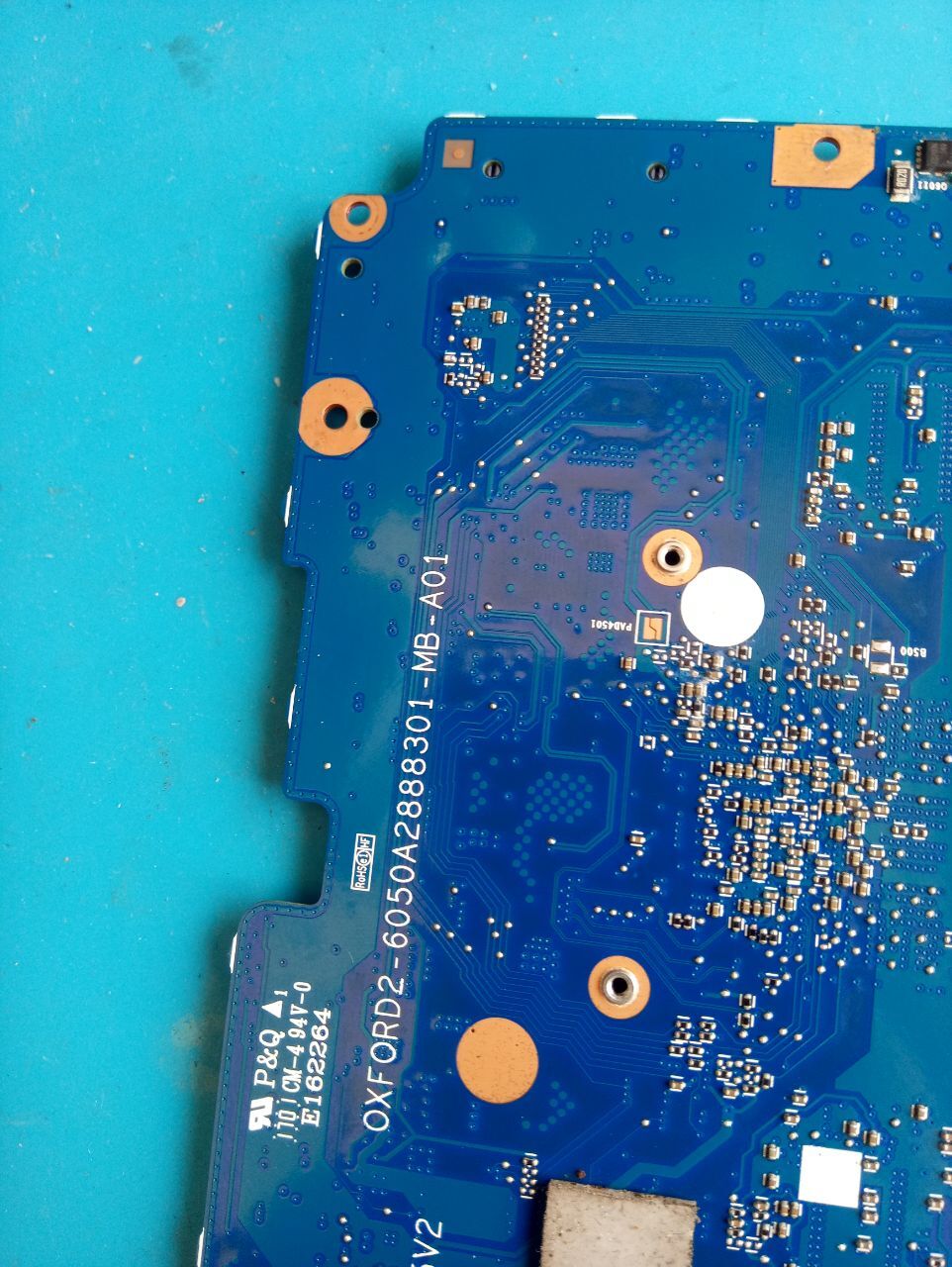

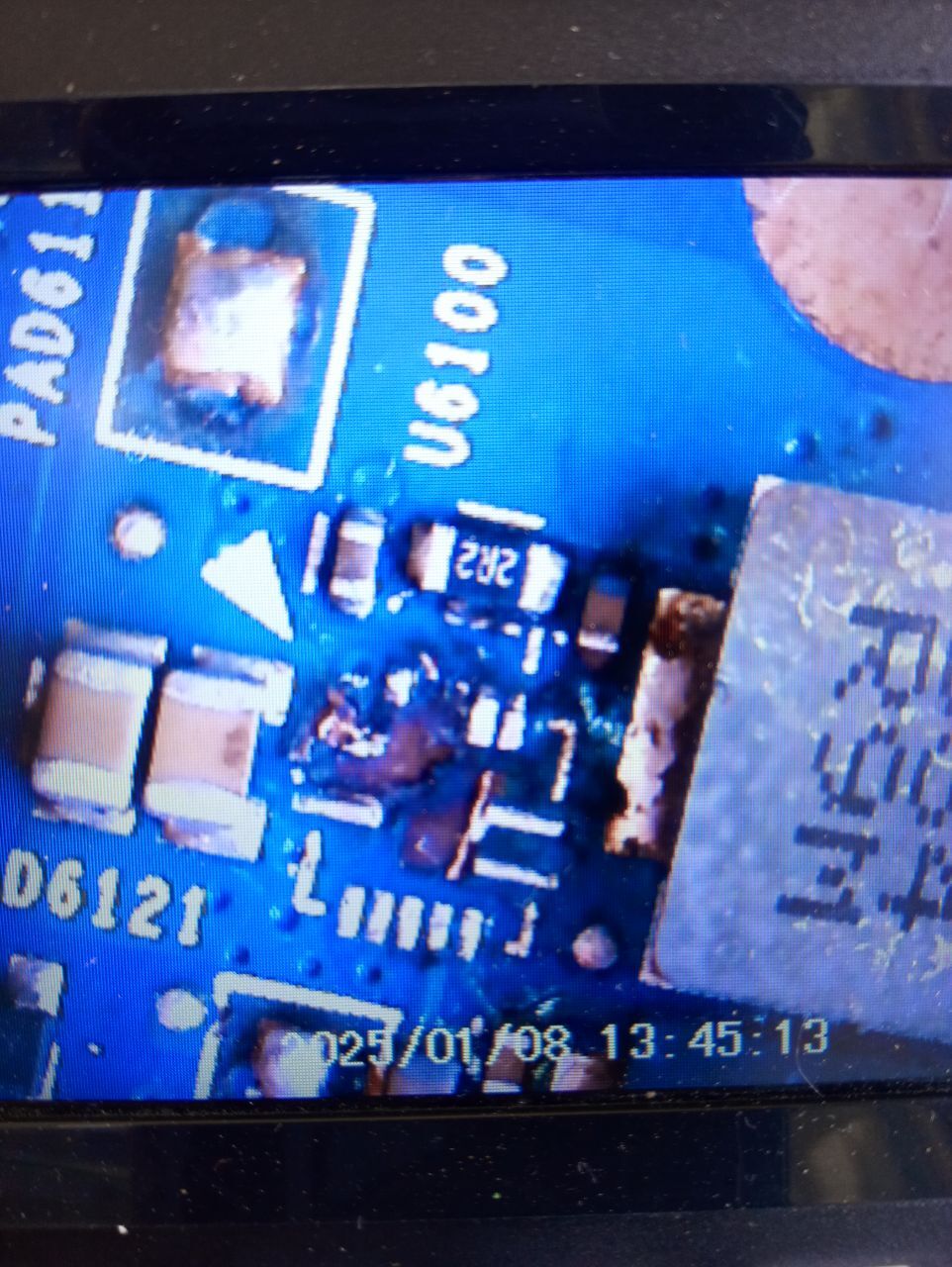

Someone help me identify this integrated in Acer Swift 1 laptop please.!!!
  • valente222
    • Feb 2021
    • 85
    • PERU
    Hello friends, I have this equipment with an explosion in the U6100 part, 3v alw source. Apparently (I don't know what integration it is) I have the schematic but an error appears in Allegro Viewer. I share the schematic in case someone has another compatible viewer.
    The model identifier is SF114-31
    BOARD: OXFORD2-6050A2888301-MB-A01 MODEL: N15V2
    S/n:NXSHWEB002710019D52600​

    U6100 : MPS_NB670GQ_QFN_16P
    Part # MPS NB670GQ

      You are missing some SMD pcb pads that will have to be rebuilt to allow for the replacement part to function like the original. Review the boardview file to study which pads are missing.

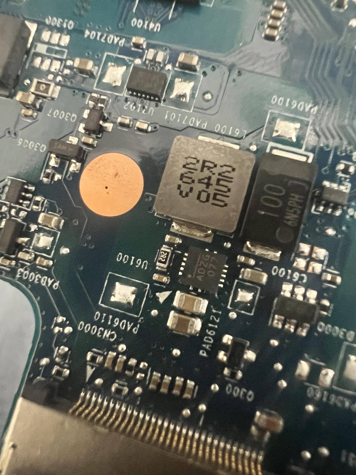

                today i have the same board this is the pic with your missing element Click image for larger version
