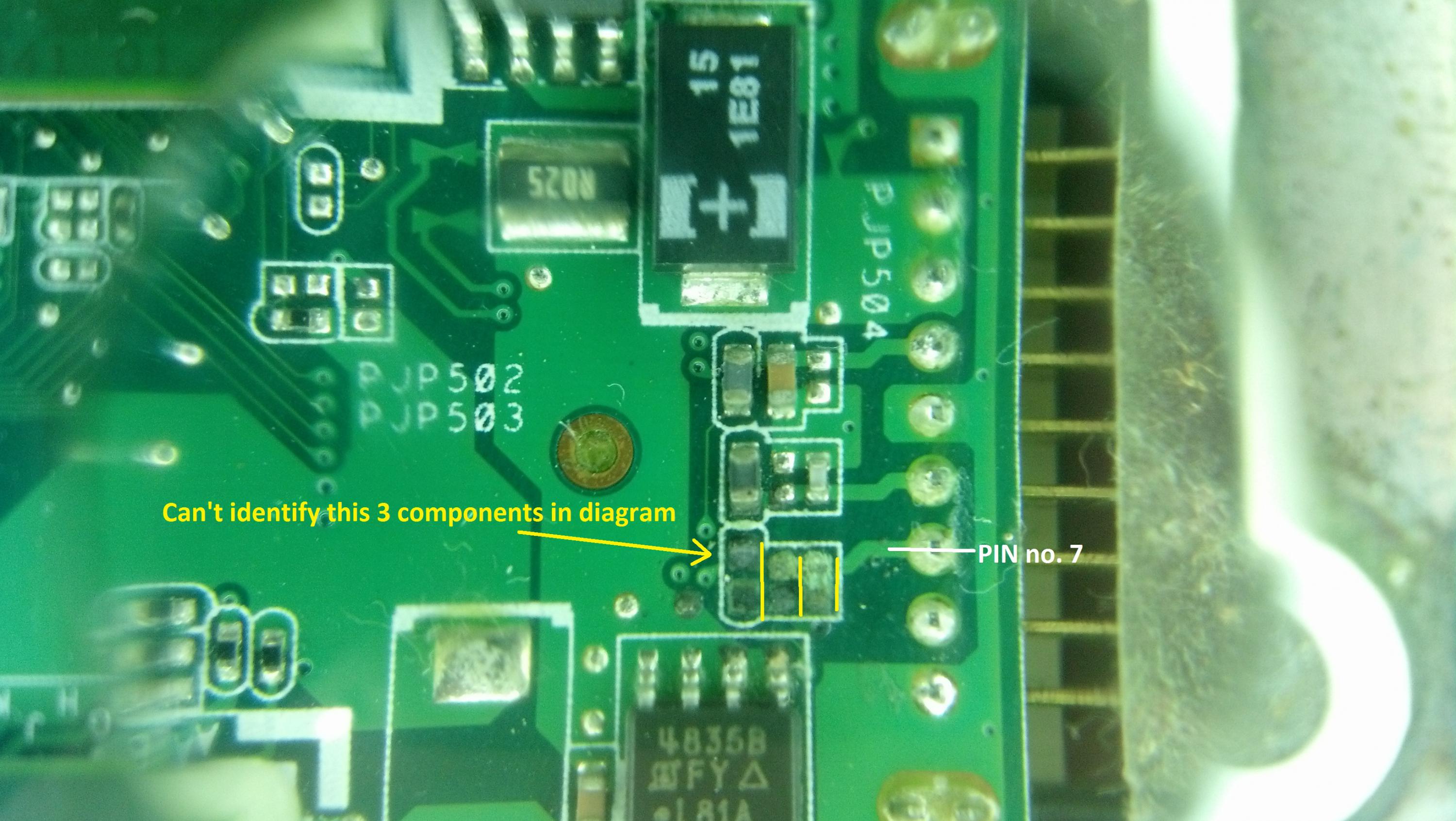

      I already found schematic for this one. Problem is when I connect battery and try to power laptop it shutsdown after bios screen never reaches the windows loading logo.
      The owner told me a few years ago battery won't charge, but confirmed battery works on other laptop. This laptop also works 100% without battery.
      I saw 3 burnt components along pin no. 7 of BATT_CON, but unfortunately I cannot identify them even with schematic. There's no prints on the board.
      On diagram, page38 pin no. 7 of BATT_CON, seems to be connected to only 2 components C139 and D22. I don't know value of D22 and at the end of line there is L34 which I think is and inductor with unknown value.
      Do you have any thoughts for this, or does anyone have boardview? Thanks a lot guys!

        L34, I think is an iron core inductor with a value of 120 Ohm 100Mhz. D22 is blank I suppose because of the term "Do Not Stuff" on the diagram. So the third component to the right will be C139 100PF 50v capacitor. Will someone please help me confirm, Thanks again

                I manage to replace bunt components along pin no.7 and pin no.8 of bat_con. And now laptop powers up with battery and can now boot to windows. But there is still problem battery does not charge. It works with adapter only and also works on battery only. Laptop detects battery and also indicates the capacity.
                Which pin of PU1A (MAX8724E) supply voltage to battery? I already have datasheet for it but still cannot understand some terms. I guessing pin no.16 Batt.
                There are no prints on the board which makes it difficult for me to trace components to battery. Thanks people
