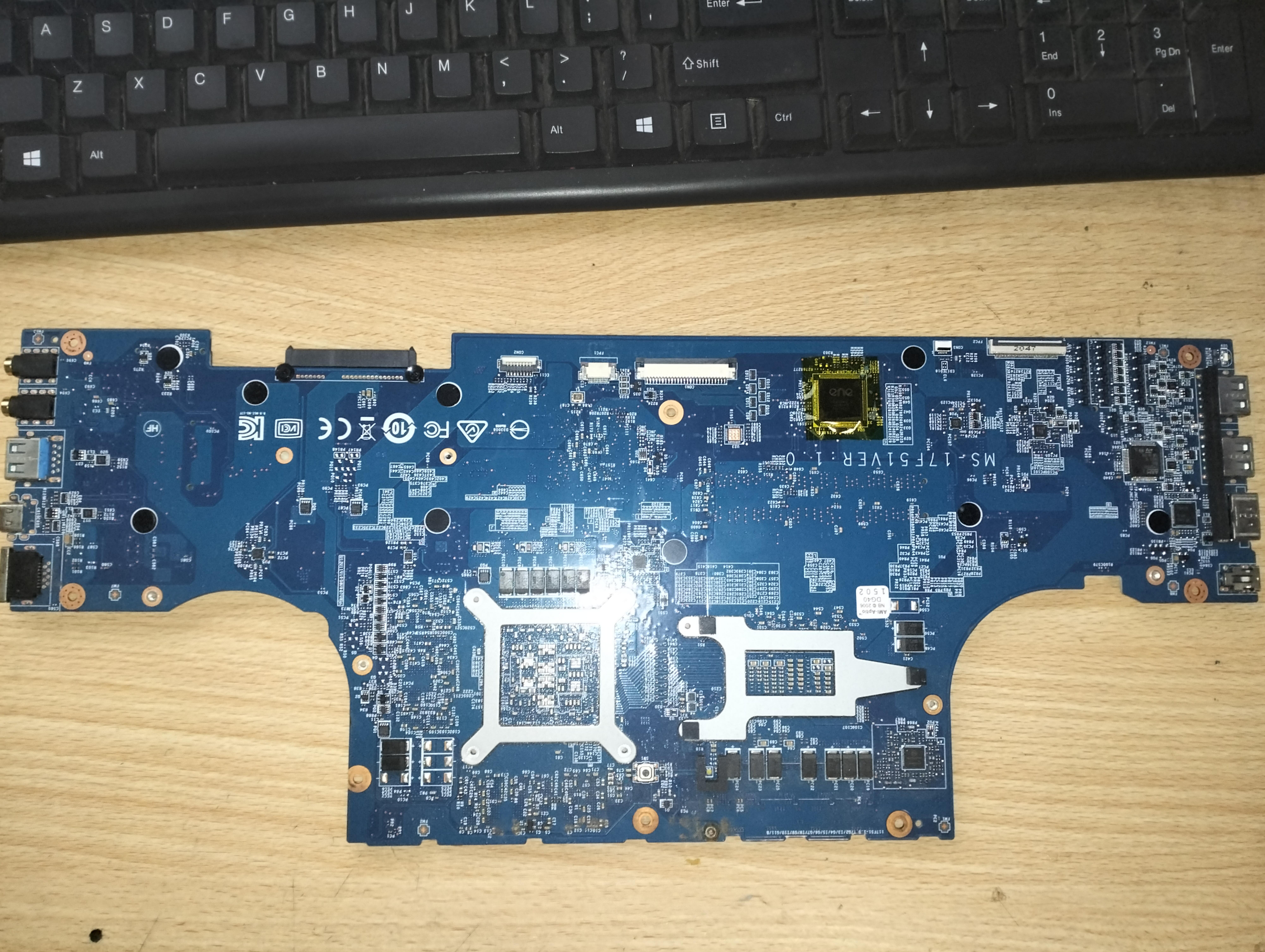

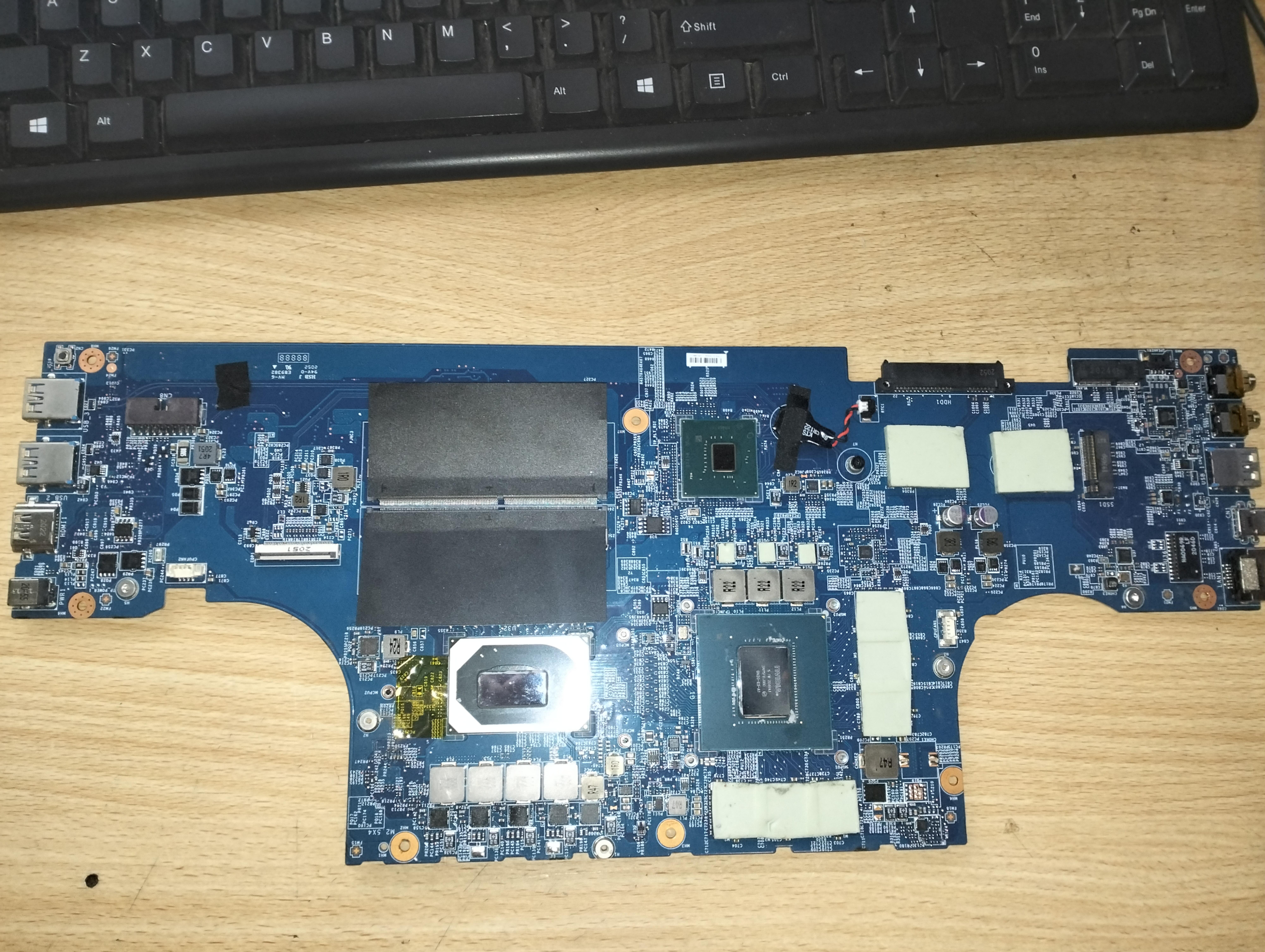

    Hello all
    Im looking for board view schematics of a MSI Gf75 Thin and some advice
    Specifically MS-17f51 VER:1.0
    It's not powering up all all (no lights or noise)
    Using 2 different chargers at the correct voltage and polarity, one charger confirmed working under load on other laptops
    When plugged in input voltage drops to almost nothing (less then 0.5 volt), one charger has a light and you can hear it resetting, so i'm thinking short on the charge circuit.
    Mosfett PQ28 (FDMS66817) gets quite hot, it also reads a different resistance then the identical chip next to it. I'm thinking possible short somewhere down the line of this chip, no obvious damage.
    The two board views i looked at (MS-17F31 and MS17f41) seam slightly different in this area.
    Can anyone please help me?
