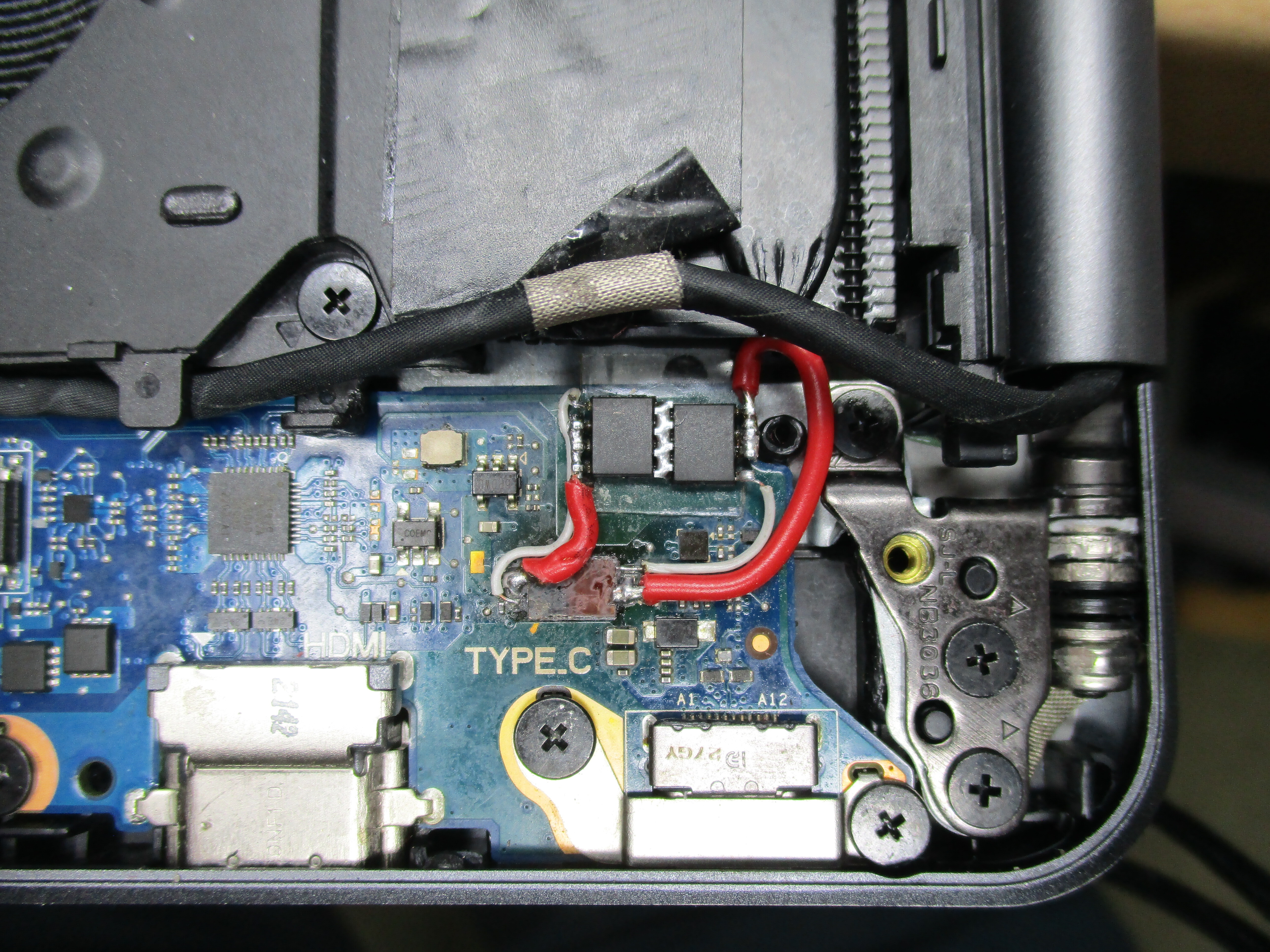

    has anyone schematics and boarview for this? Both USB-C power input Mosfets are blown due to low gate voltage and some components on the back side desoldered themselves from heat.
    Thanks in advance & BR!

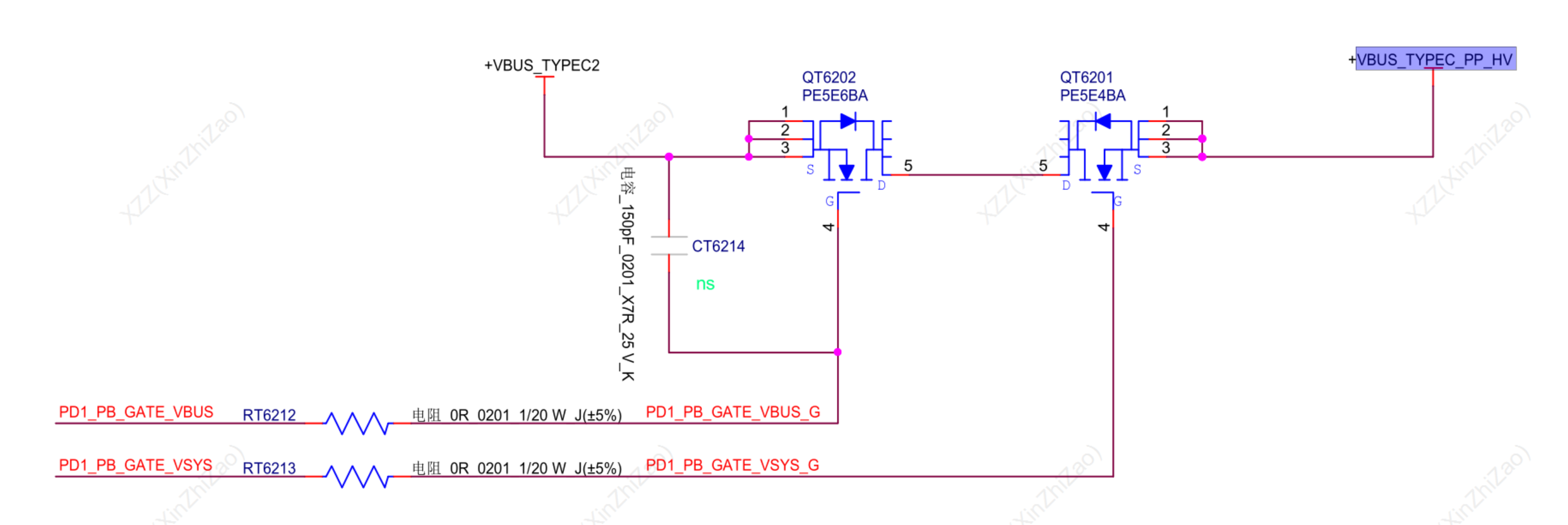

    See attached - not sure if this is what you are after?

      Thanks, interesting would be where exactly the gates get powered from. In my case, also the pads burnt off from the board and my solution right now looks like this. It turns on now, but my USB Meter now shows 19,8V And gate Voltage on both FETs is 21V, VGS measures exactly these 1,2V which is still too low and causes them to heat up quickly.
