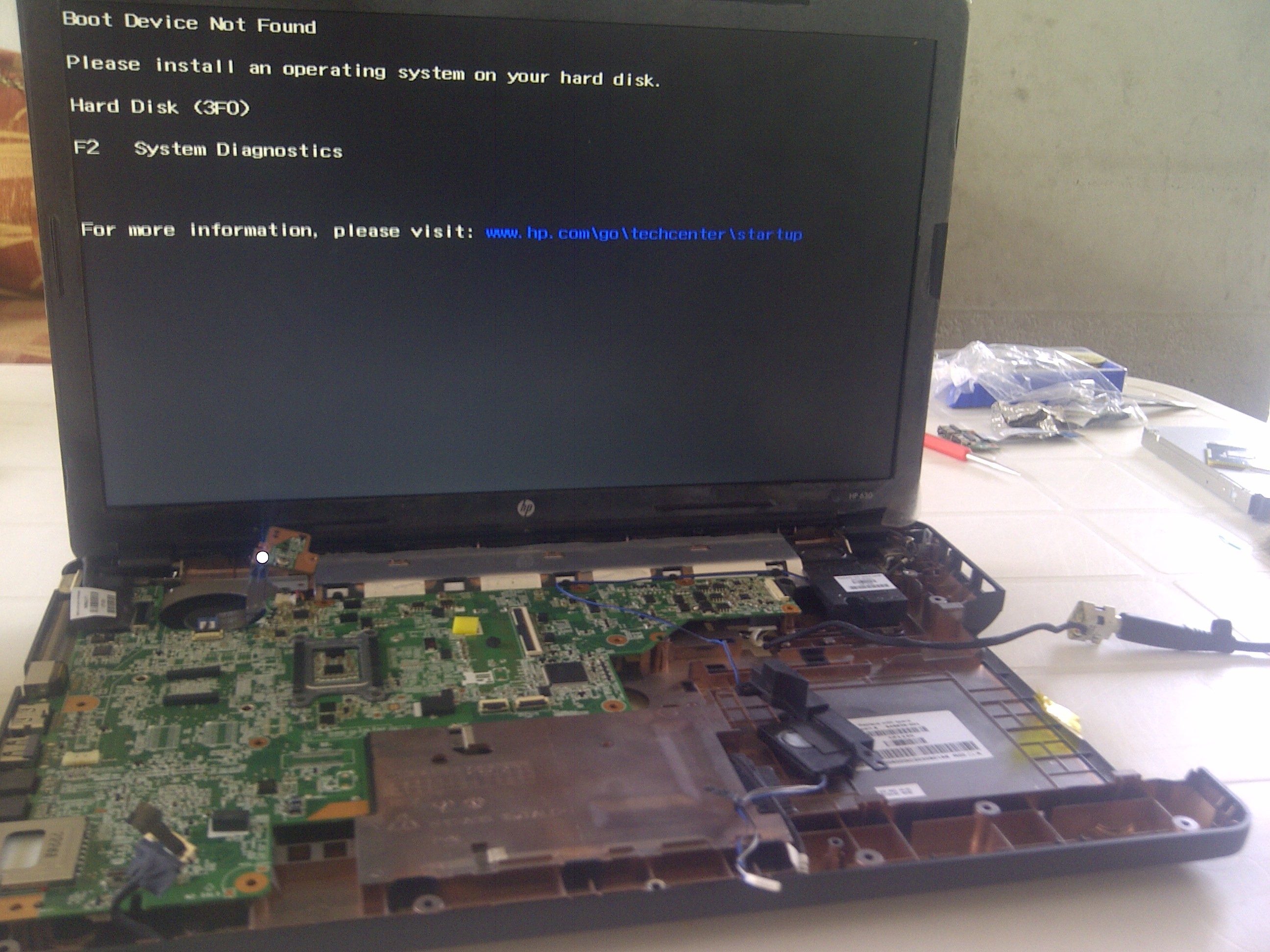

need hp630 schematic diagram . (chicago_hr_hpc )

thanks again spidey . laptop is working now .

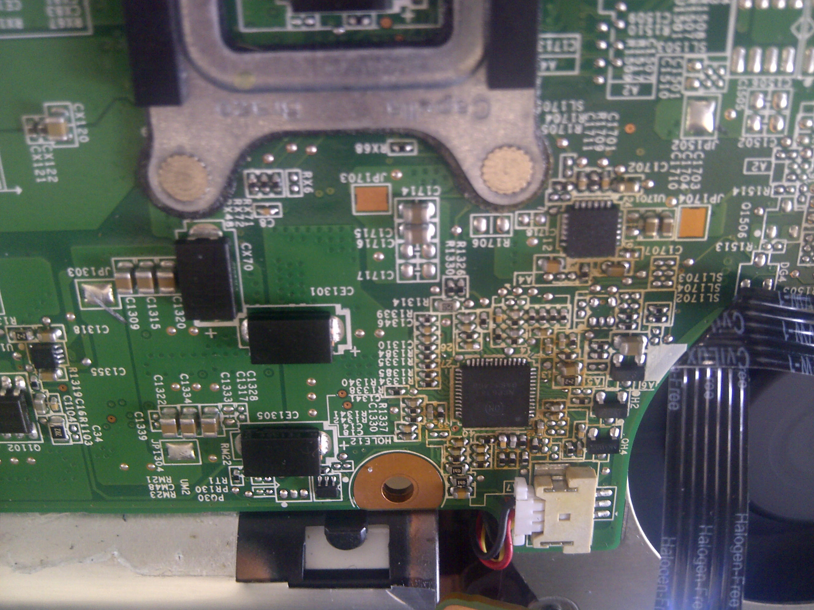

Re: Chicago_hr_hpc
Vcore NCP6131S was the problem .
thank again for the diagram .
