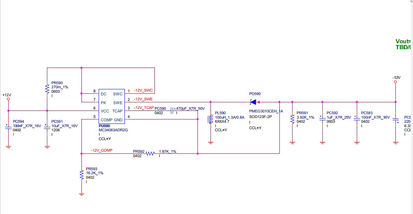

    hello Guys Titi here ,
    hope you are ok,i am looking for help,any one with schematic of IB250CX schematic diagram( lenovo M710e)
    mine has an ic above sata has removed and i can't guess the number or if it was a regulator
    please if you know let me know the type of this chip
    computer work except to recognize hdd or ssd disk ,normally i can't install windows even if disk shows up or run windows
    thanks

      try Click image for larger version
