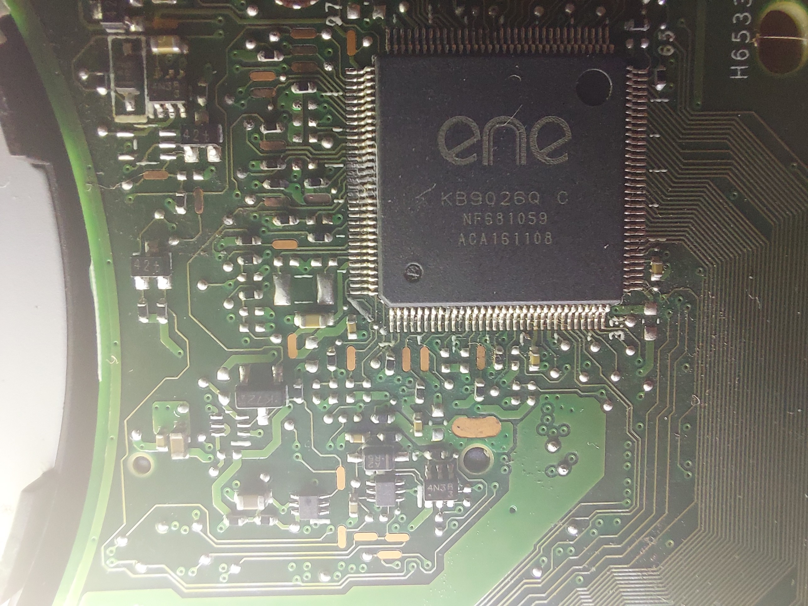

    Hello.
    I'm looking for an Asus X756UA-TY390T motherboard shematic, boardview or repair procedure
    Motherboard X756UV rev 3.1 - 60NB0A00-MB2300-310
    My PC doesn' t start :-(
    Any help would be appreciated

    Re: Need schematic for Asus X756UV rev 3.1
    Start a repair thread in the laptop forum. We may be able to diagnose without a schematic.
    Start with the power adapter -> 2 x dcin mosfets & charger IC details. Most of the time, the fault is in this region.
      Thank you mon2.
      I just found the problem by looking closely at the motherboard with a big magnifying glass.
      Some tracks of the SIO chip were oxidized and I was able to repair the connections.
      I'm happy, my PC will have a second life ;-)
          Hello.
          Finaly I need the schematic for this mainboard because the computer only starts if the charger is plugged in. However the battery is good, if I unplug the charger only one second after starting the PC works very well on the battery, it's really only the start on battery that is the problem.
