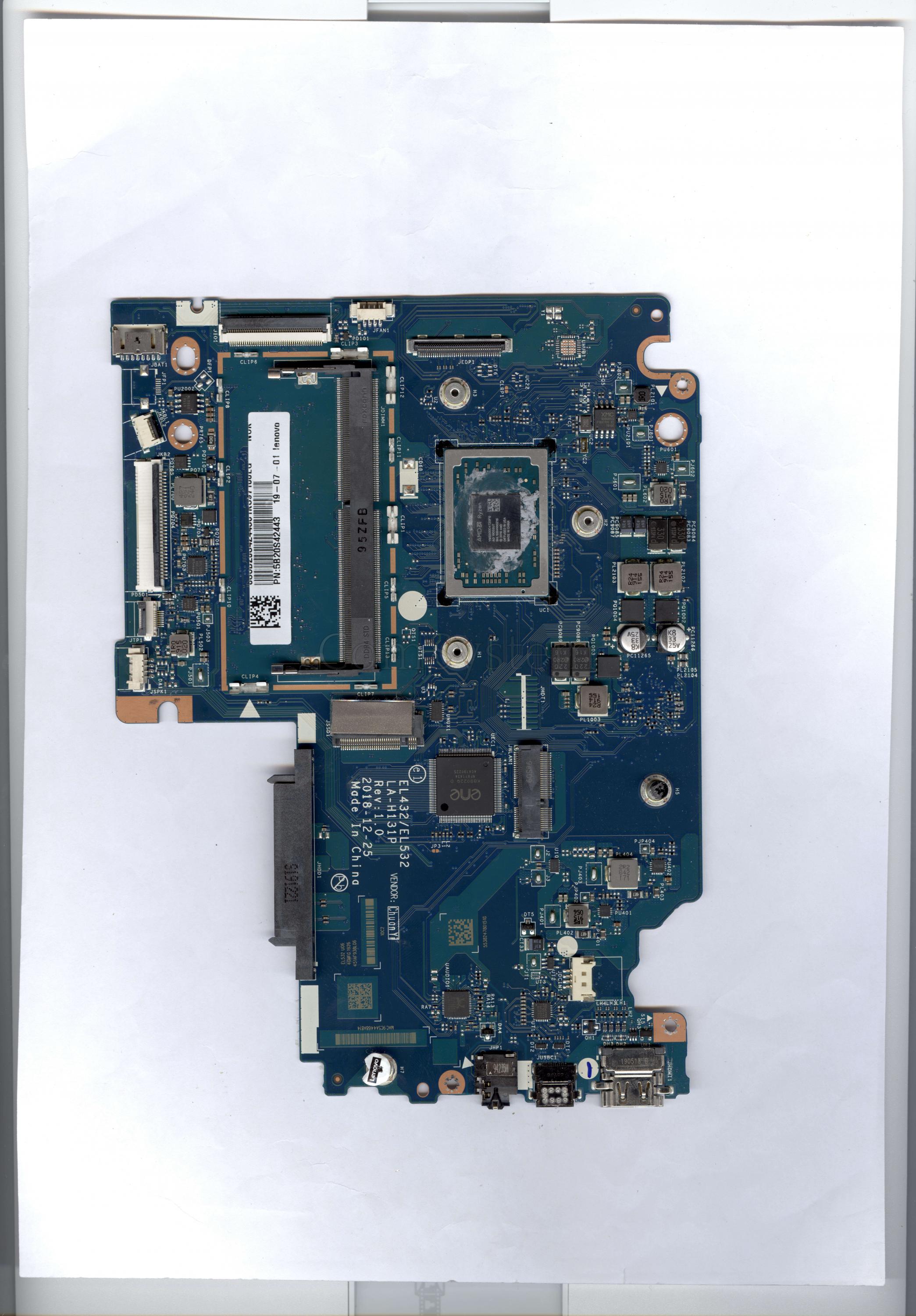

    Hello I have a Lenovo Ideapad S340-15API
    with EL432/EL532 board on the test bench.Enable signal not present!
    PU402(+5VALWP)=0V
    PU402(+5VLP)=4,9V
    PU401(+3VALWP)=0V
    PU401(3VLP)=0V
    PU401(5V_3V_EN)= Pin 9 =0V=MOhms
    PU402(5V_3V_EN)= Pin 12 =0V=100kOhms
    No shorted caps found in this area
    PR409 4.7 I had to desolder it was burnt out and had 280 ohms
    What can be the reason I find the error simply do you have any ideas?...
