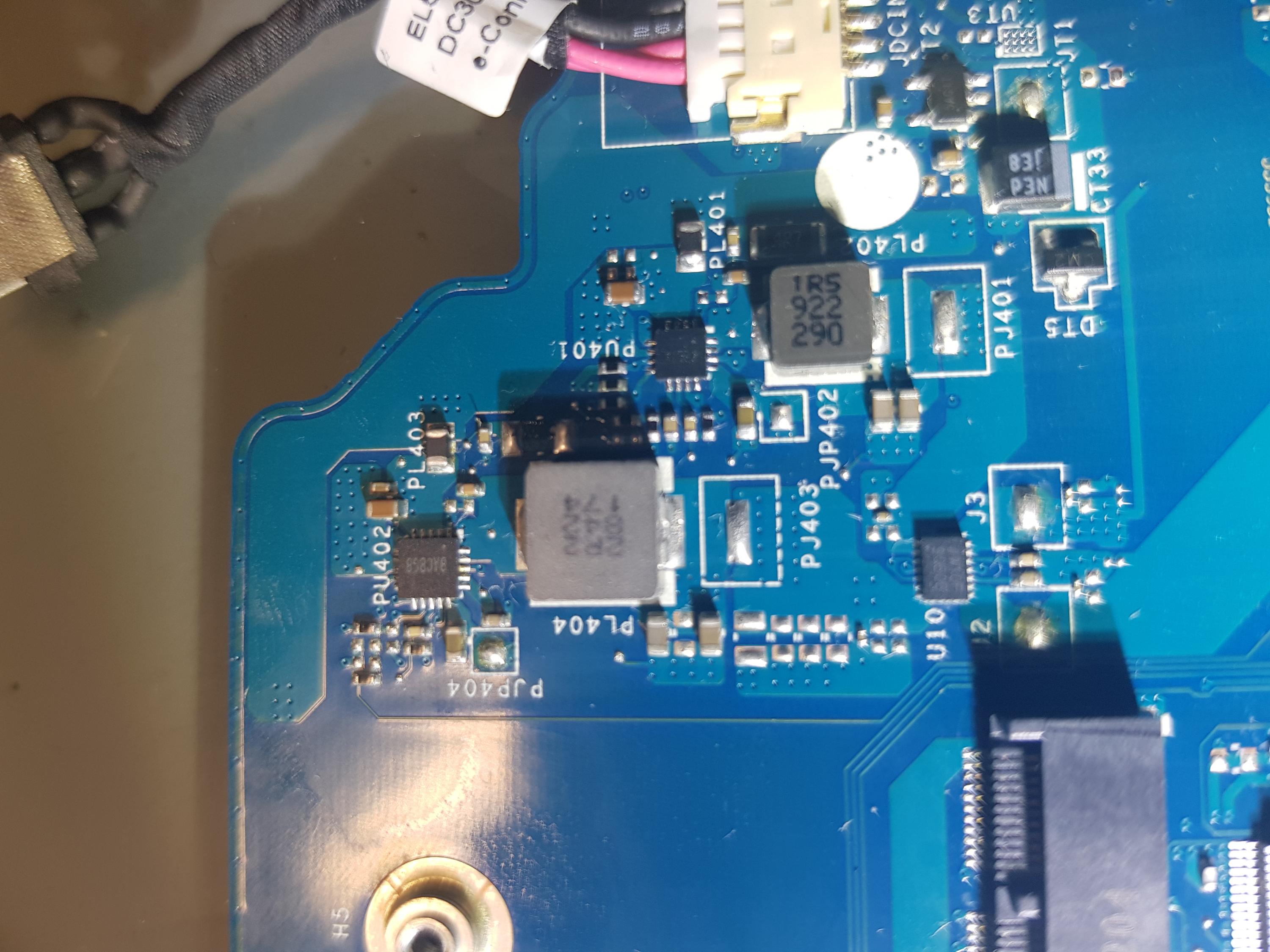

    Hello I have a Lenovo Ideapad S340-15API
    with EL432/EL532 board on the test bench.Enable signal not present!
    PU402(+5VALWP)=0V
    PU402(+5VLP)=4,9V
    PU401(+3VALWP)=0V
    PU401(3VLP)=0V
    PU401(5V_3V_EN)= Pin 9 =0V=MOhms
    PU402(5V_3V_EN)= Pin 12 =0V=100kOhms
    No shorted caps found in this area
    PR409 4.7 I had to desolder it was burnt out and had 280 ohms
    What can be the reason I find the error simply do you have any ideas?

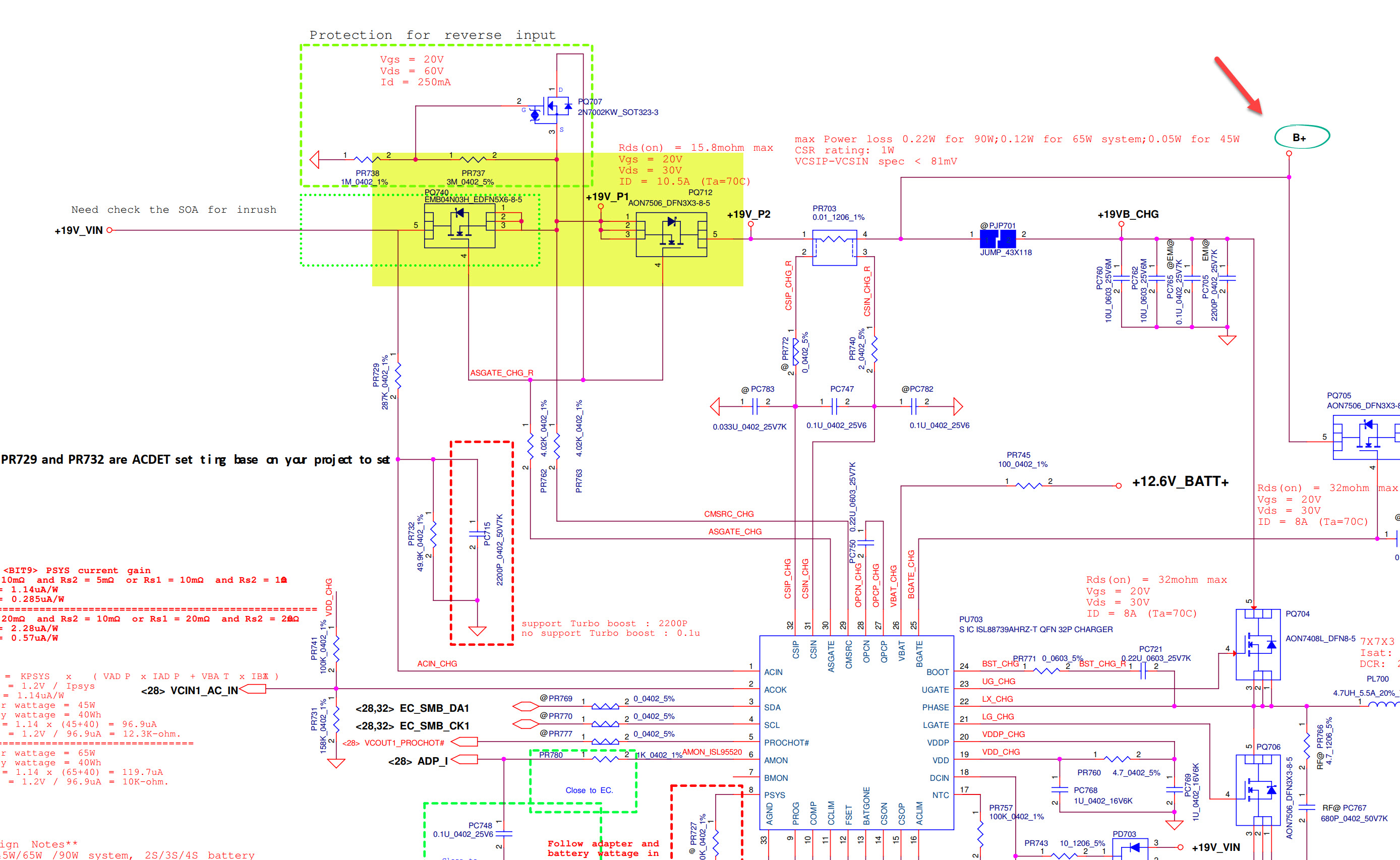

    Re: EL432/EL532 Lenovo Ideapad S340-15API "5 V _3V_EN" No Enable Signal "
    As per the article in the sticky above by @Piernov - always check the 2 x DCin mosfets.
    That is, the _EN for the ALWAYS ON rail is driven by the B+ power feed.
    The B+ power feed is after the 2 x DCin mosfets so start with these entry mosfets.
    Attach the proper power adapter. Then measure the voltage on each pin of the DCin mosfets.
    Interested in the voltage to ground of:
    drain (5-6-7-8) ; pick one of these
    gate (4)
    source (1-2-3) ; pick one of these
    Post all measurements.
    Repeat for the 2nd mosfet. Often, the 2nd mosfet leaks and causes all of these issues.
    Start with the above.
    • breid
      • Apr 2022
      • 28
      • Österreich
      PQ712
      Sorce=20V
      Gate=25V
      Drain=20V
      PQ740
      Sorce=20V
      Gate=25V
      Drain=20
      all normal

        LDO voltage missing. The enables are from the EC so you are too far ahead. Troubleshoot the missing +3VLP voltage. Perhaps a short on this LDO rail, remember these only produce about 100ma before they shutdown. The 5V LDO is working, and the enable is common to both so must be an output issue. Hopefully not a shorted EC.
        As for PR409, that doesn't make much sense since it only appears to be for transient suppression, unless the cap below was shorted I guess. Besides it seems to be a @ on the schematic (NOSTUFF) so double check that.

          Thanks for the answer and I think you are right I only have 256ohms on the +3VLP LDO circuit at +5VLP I have MOhms now I desoldered the EC and the resistance has normalized kOhms. Now I just have to see how to program the new one because these programmers are not that cheap
