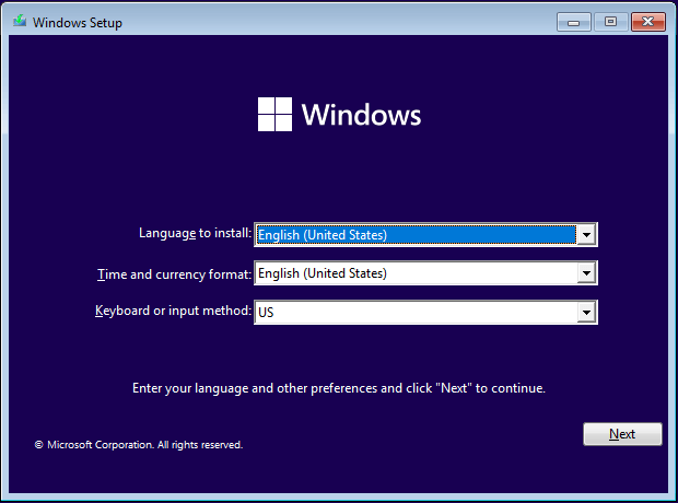

                Hey, wanted to thank you, i finally got the programmer and managed to program the EC and the laptop turned on. but i have a problem with keyboard not working. i noticed the keyboard works while on bios mode but not when OS is loaded. can you help?
                thanks

                  It's good to know, You're Welcome.
                  If the Keyboard works fine in the BIOS Menu but it doesn't work in the OS, this should be a Driver issue, try to install a New OS.
                  Also to be sure, you can test the Keyboard in the Language step before installing the OS.

                    I updated bios and firmware, loaded usb linux/hirens boot cd and other distros just to test and no go, the OS detects the keyboard but won't register key strokes.
                    Not sure, I'll have to retrace my steps and see if I knocked something off by accident
