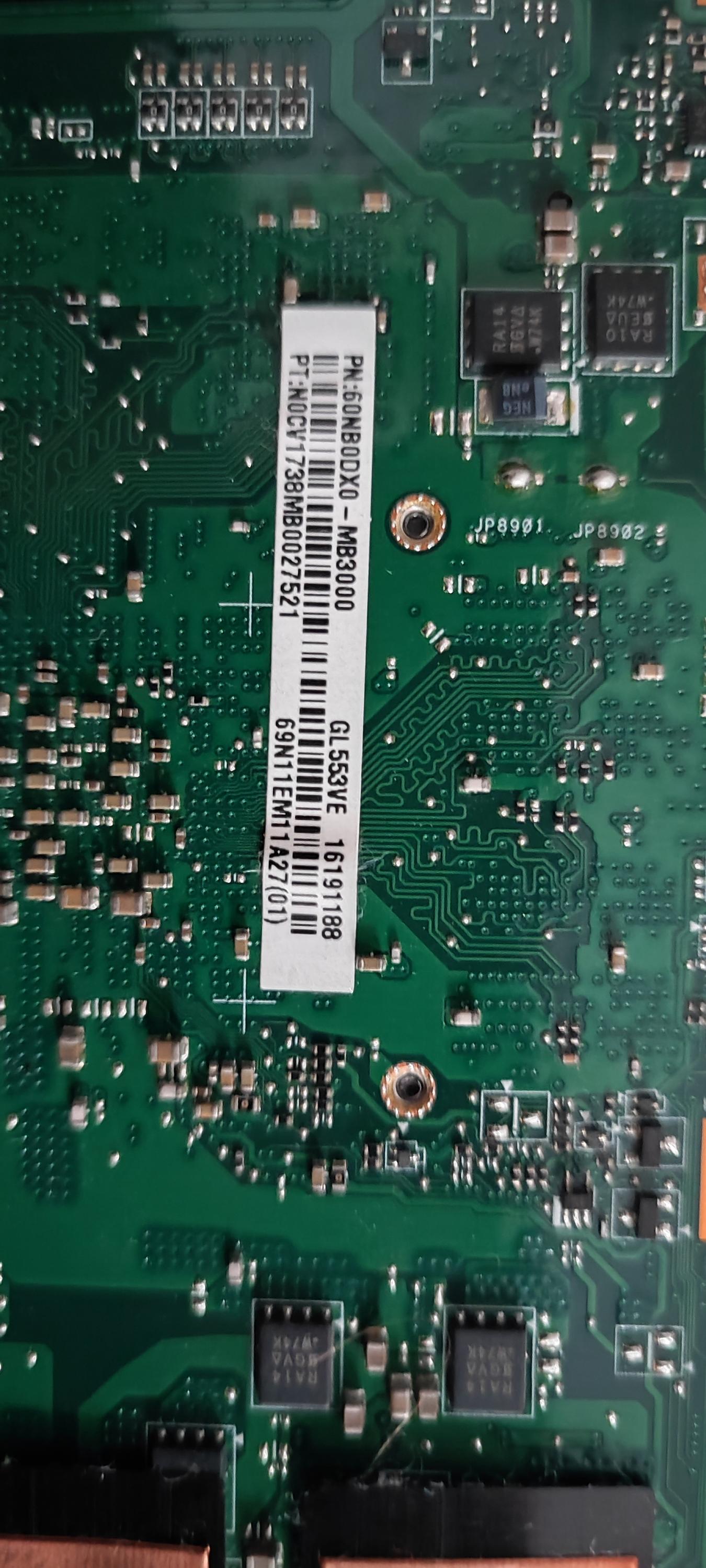

    asus GL553VE-FY022
    when i press sttart laptop start only light for keyboard on.
    no display
    pn:60NB0DX0-MB3000
    gl553ve 16191188
    pt: NOCV1738MB0027521
    69N11EM11A27
    BAR CODE
    B06EBF20807C
    please help
    thanks in advance

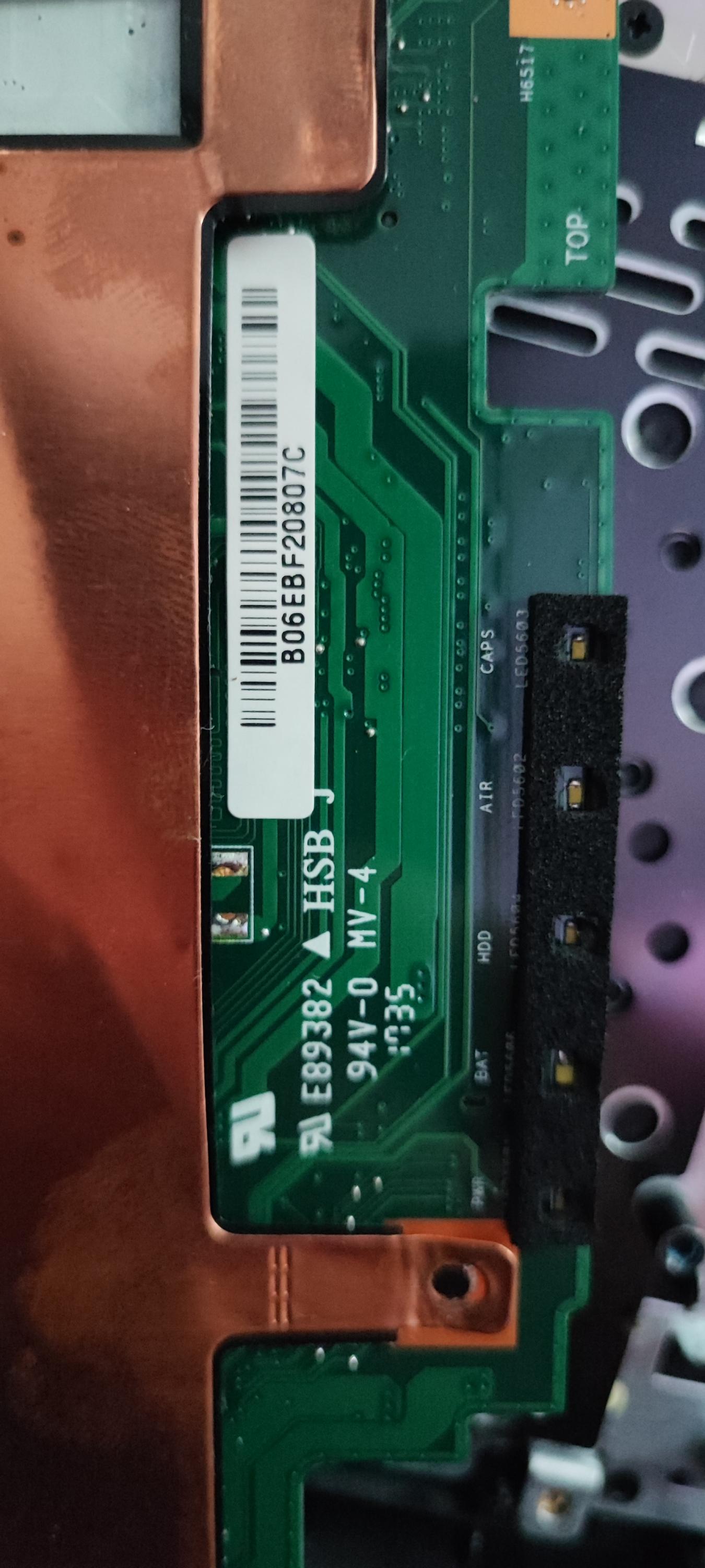

    Re: asus GL553VE-FY022
    Some picture

                          give me the sn form your unit

                            The barcode picture at post #2 has the bios version for the motherboard "GL553VE" so the F1 bios you posted should have worked.

                                • darckreign1984
                                  • 260
                                  • Romania
                                  H9N0CV15Y67439E CN:Z9B1
                                  THIS ITS BAR code on the back of laptop
                                  • cacla
                                    • Apr 2015
                                    • 444
                                    By sn this is the right bios for your unit
