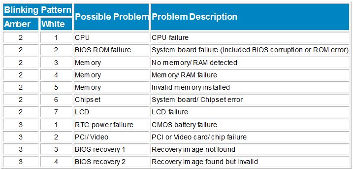

    Need help about BIOS for Dell Inspiron 3481
    EDI5K LA-G713P Rev 1.0
    2 amber 4 white error. Tried other known working memory but still not booting after windows update.
    attached are my bin files. I made 2 backups

    Did you try another trusted ram , because That blink code indicates a RAM failure.

      Yes Problem occured after windows update
