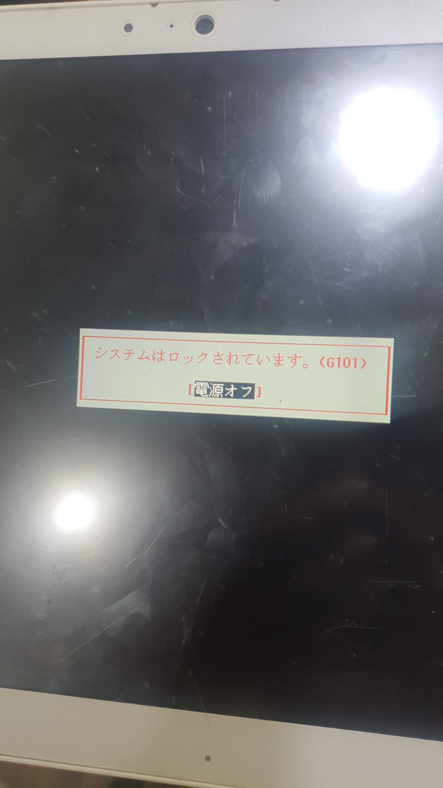

Need clean Fujitsu Dump password Arrows V727
  • abuge
    • Oct 2022
    • 69
    hi anyone can clean dump from Fujitsu Arrows 727v i find on internet same bios to change just me to unlock but unfortunate this model dont have any old dump can any friend please clean bios password this file thank you
  • AAAC
    • Jan 2020
    • 459
    • Mexico
    Re: Need clean Fujitsu Dump password Arrows V727
    I have invalidated variable for Supervisor Password. While checking BIOS file also found Computrace to be active, so I've invalidated that variable too.
    Being a Fujitsu, you may have been able to reset the supervisor password by using the 3 "service passwords", have checked the BIOS file and they are there, the question is which algorithm it uses.
    Fujitsu service passwords (QWERTY): “3hqgo3“, “jqw534“, “0qww294e”, type each password inside quotation marks followed by ENTER key.
