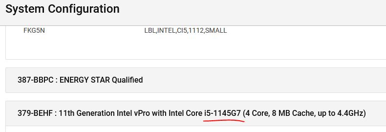

              Re: Dell Latitude 5420 - Faulty BIOS Image
              CML : turn on few seconds then off without display
              TGL : turn on then hung on light without display (no dell logo)
              i have never encounter this strange issue !
                • 20609
                CML is Comet lake, TGL is tiger lake. Your CPU is a tiger lake U .The laptop is still under warranty by the way: ProSupport Flex ,Expires 25 JUN 2024
