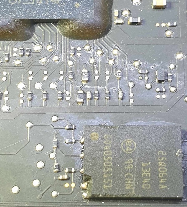

      Blacklist Status: Clean
      non booting beacause of damaged bios while try to remove efi password
      need clean bios
      no backup avalibale
      can replace bad IC with this one ?
      Br. LLCOOLR
      • llcoolr
        • Mar 2021
        • 17
        • ALgeria
        i've foud bios for A1502 & ive edited serial and checksum
        now when power only the FAN turning and still not booting
        can any one verify it
        plz
        Br. LLCOOLR

            Originally posted by SMDFlea
            Post the EMC number
            mainboard : 820-3536-A
            EMC : 2678
            serial : C2QN502JFGYY
            original broken ic is 25Q064A replaced with 25LQ64B
            Br. LLCOOLR
