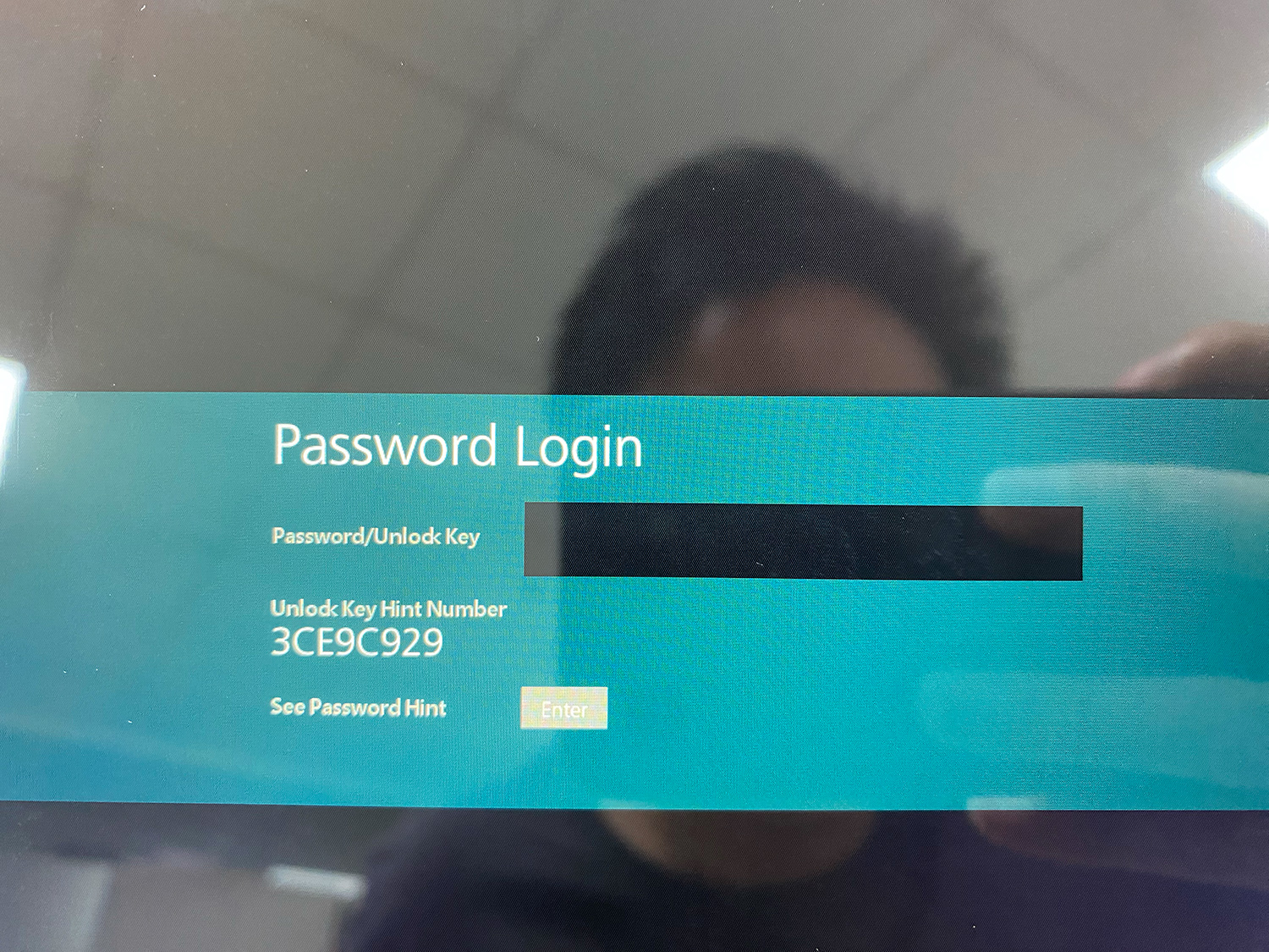

        Lenovo ThinkPad 10 (20C3) BIOS password need unlock help
        Hello everyone, the device I'm currently using is a ThinkPad 10, which is a tablet computer. The BIOS is currently locked, and when I try to access the BIOS, it asks me to enter a password or an unlock key. Can I use this "<unlock key hint number>" to unlock the BIOS?
        Unlock Key Hint Number:3CE9C929
        I'm currently unable to access the operating system because my hard drive is also encrypted with BitLocker. This means I can't flash the BIOS file, it's causing me a lot of trouble

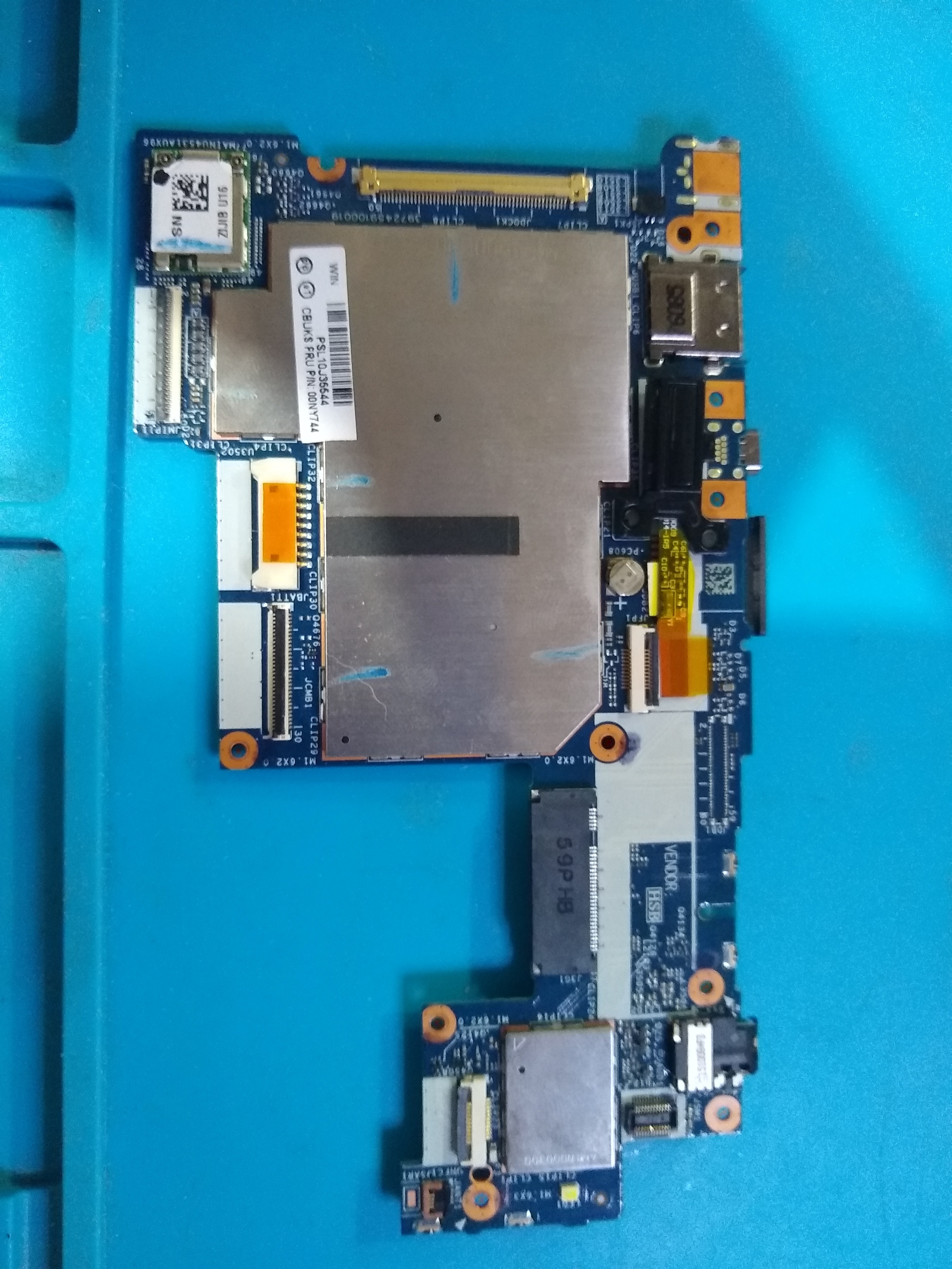

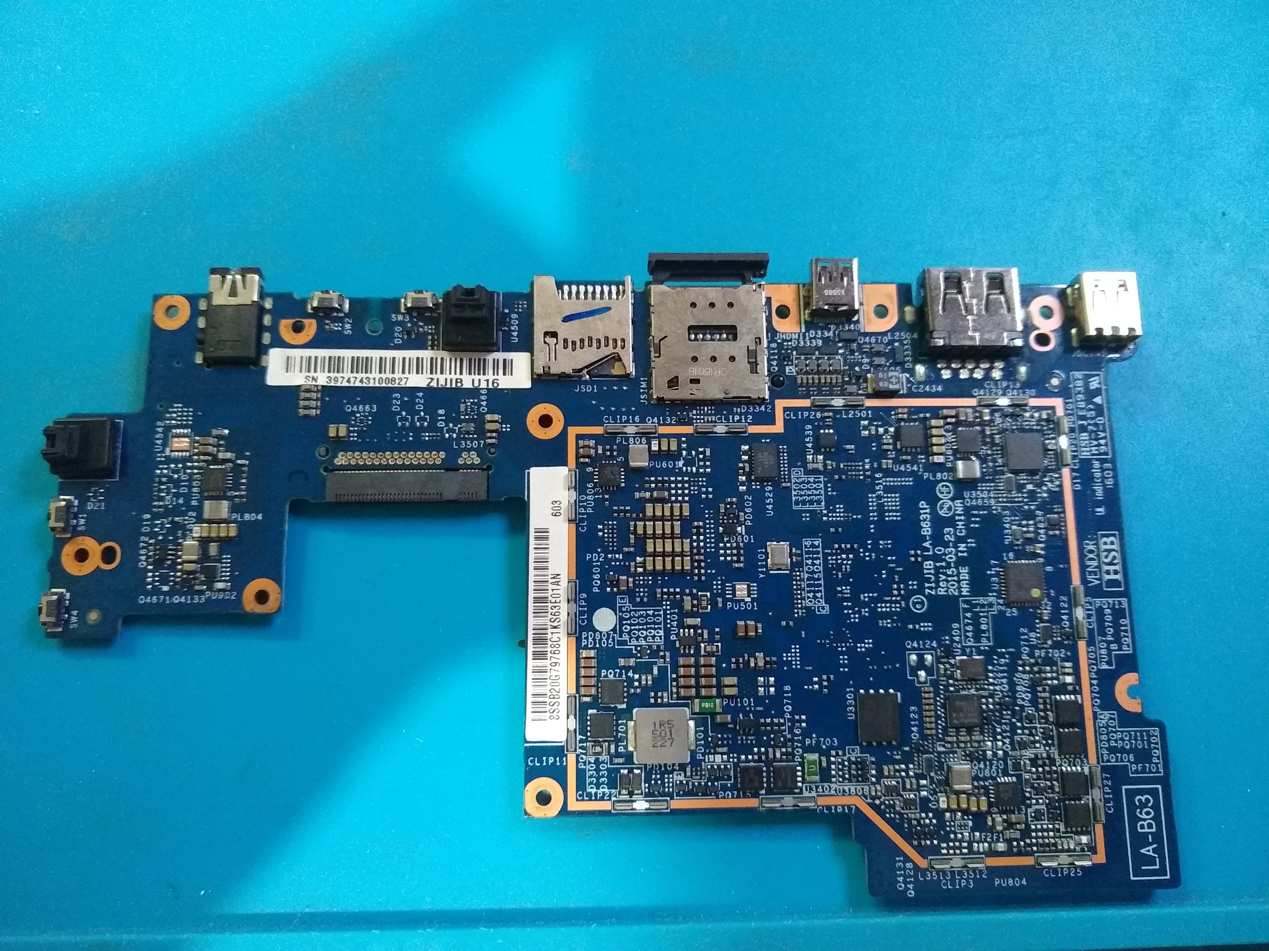

          Re: Lenovo Thinkpad 10 Type 20C3
          I can take apart the tablet but I can't find where the bios chip is
          • peste
            • Dec 2016
            • 12600
            • ROMANIA
            also read post #2..

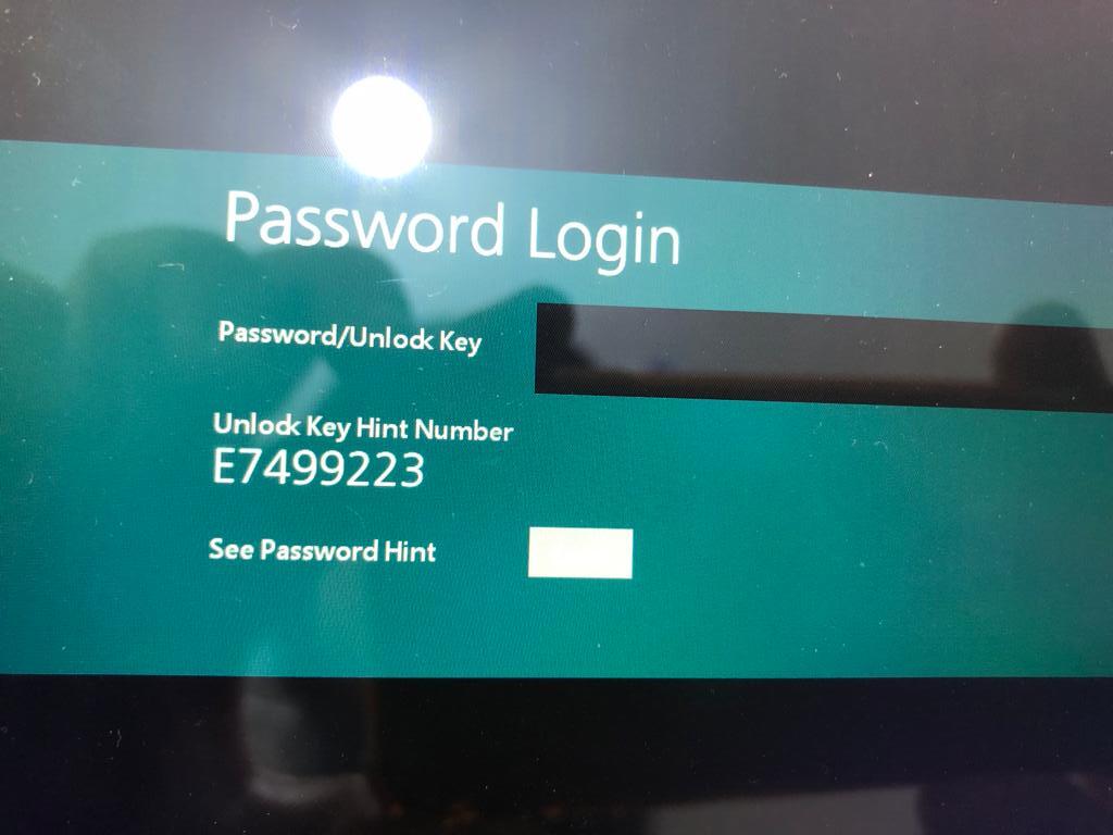

              Hello need unlock code for Lenovo Thinkpad 10 tablet
              Hint Code: E7499223
                SMDFlea commented
                Editing a comment
                Please post the serial number of the device .
            • Ghamidi
              • Mar 2020
              • 303
              • France
              Sorry SMDFlea , I do not have a serial number for these tablets

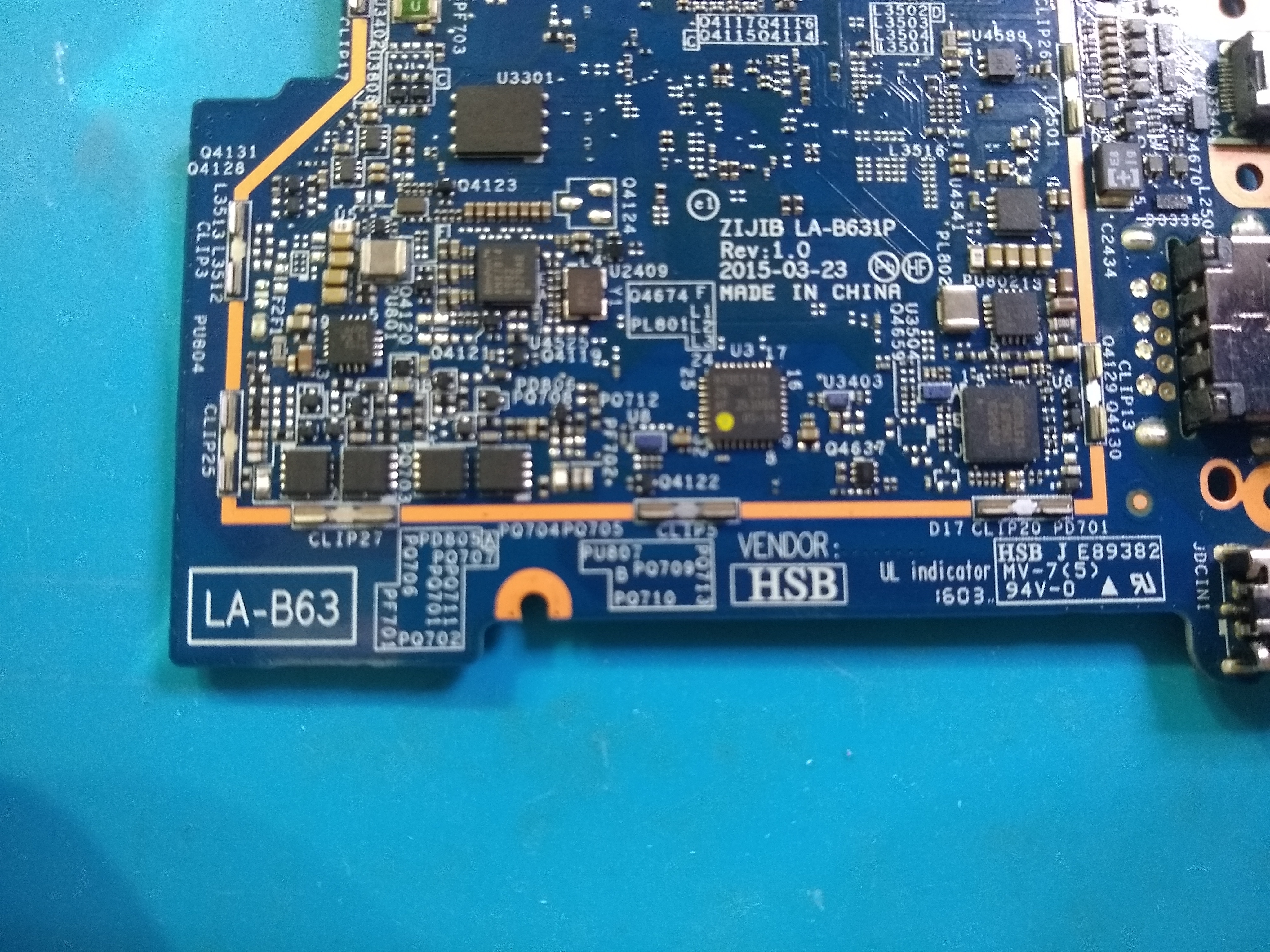

                buenas noches amigos alguien tendra el bios o me puede ayudar a quitar la clave de este bios es para una ThinkPad 10 Type 20C3
                Good evening friends, does anyone have the BIOS or can help me remove the key from this BIOS? It is for a ThinkPad 10 Type 20C3
                  in English please...
                  merged post..
                  post the S/N, the motherboard model, etc.
                  • compuvision
                    • Aug 2018
                    • 16
                    • mexico
                    S/N.-3974743100827
