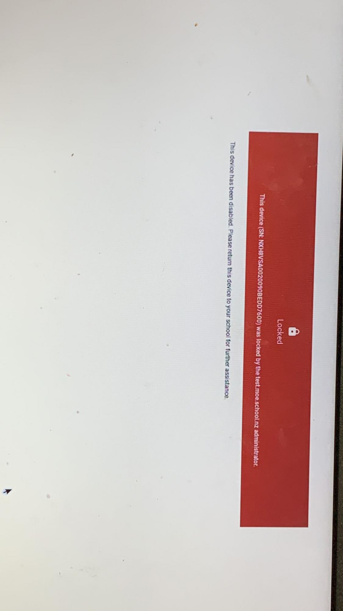

    Hi guys i have acer chrome c773 disable and sn i think lock i have try to with RC unlocker with unlock bin still same this what is showing when you turn on laptop.
    anyway i an just change few number of SN and it cud work?

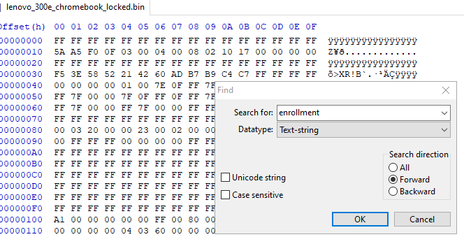

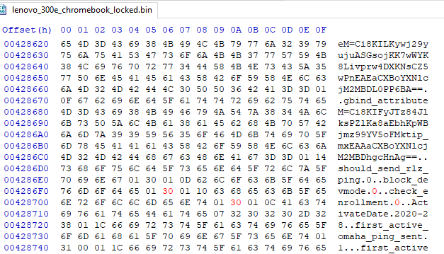

          Look at your original BIOS in hex editor, both dev mode and enrollment should be flagged with 1. Compare to unlocked by RCUnlocker, should be flagged with 0. Usually that is it, no further messing with it. Press ESC key and the refresh (with the circle) together so it will take you to dev mode.

            can you tell me on hex editor how to i find enrollment and dev mode so i can check?

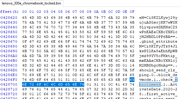

              Open original bin in hex editor. Type "enrollment" without quotes in Search tab >Find, and in Datatype: text only. That will take you where enrollment shows up and just a bit before is dev mode. You should see both are flagged as 1. Highlight each 1, and type over it 0. Do both, they will be in red on the hex block field and show as 30. Save as new file, name it and that is it, you got yourself an unlocked chrome bin. RCUnlocker does this automatically. Reflash chip, go to dev mode and install operating system.
