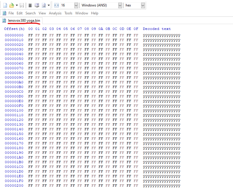

      Re: Please help with unlocking BIOS password from bin file Lenovo X380
      it is not empty , just extracxt it , i have checked it
        • 21666
        Check it properly with a hex editor, where is the flash descriptor ,ME regios ,bios region ? .It is mostly all FF`s

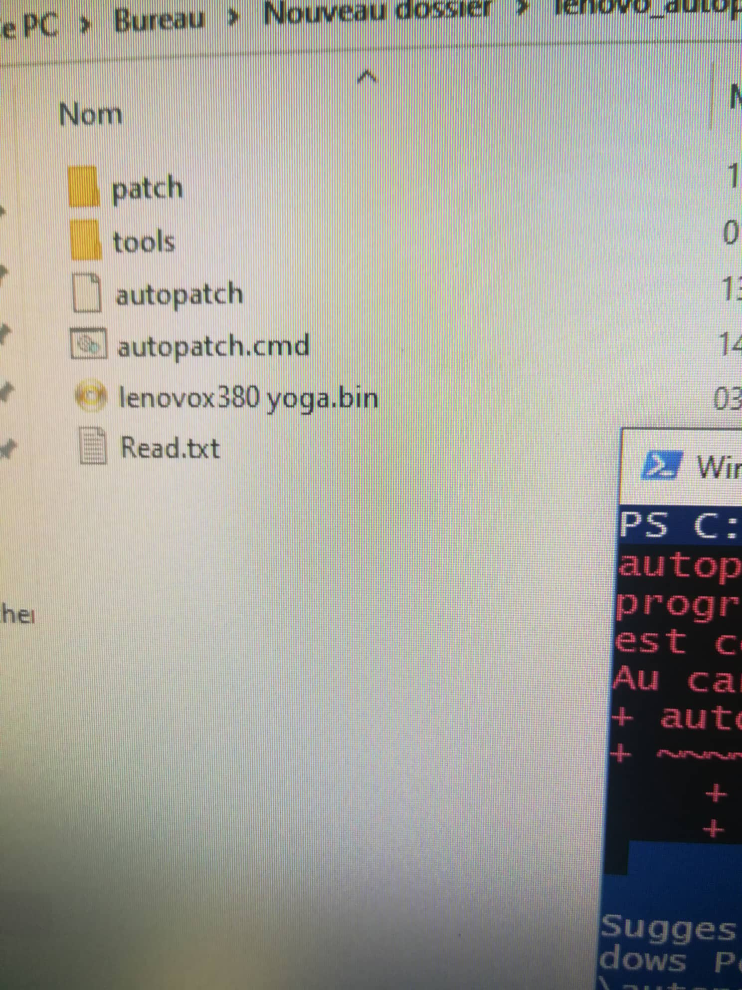

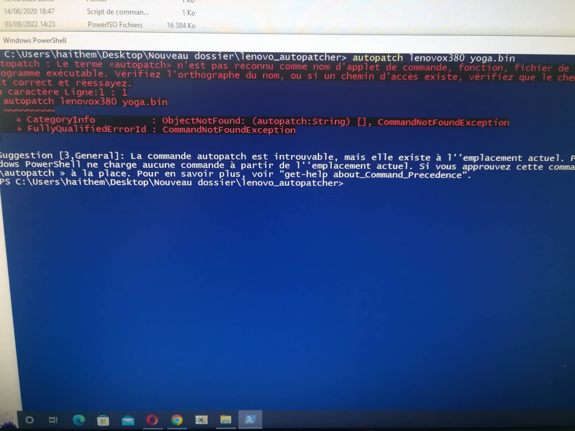

          lenovo yoga x380
          hello
          can anyone explain to me why autopatch wont work
          i have installed python 3.6 and 3.8 and same issue
          error shown on joined photos
          original dump also (it is not empty just extract)
          thanks
            • 21666
            Re: lenovo yoga x380
            hello
            thanks
            It can`t patch code that doesn`t exist. You have not made a good backup.
            I`ll take a wild guess and say that you`re using a CH341A or EZP20** programmer
            How to dump and flash https://www.badcaps.net/forum/showpo...40&postcount=2
